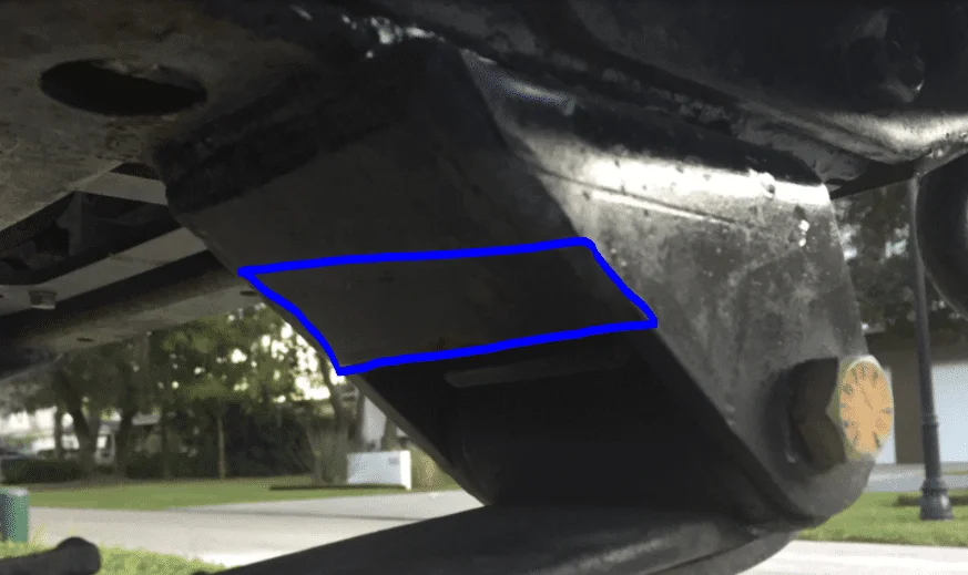

If you could make it work without killing the main leaf you would also need to clearance here because the leaf would exit higher up. It's no fun having the main leaf shear when on a trail. Happened to me.
I need to flip my front springs around to move my front axle back a little bit to work with bigger tires, and I have now gotten enough use out of my previously very nice low-mileage stock FJ62 rear springs that I have up front that I wouldn't mind potentially damaging them for experimentation. So I'm finally going to try this. I have a single complete FJ62 spring pack so I will have a spare main leave and hopefully can make two add-a-leafs from it as well.
Thanks for noticing the clearance issue with my front hangers, yes you're right I think I will have to take some of that out.
