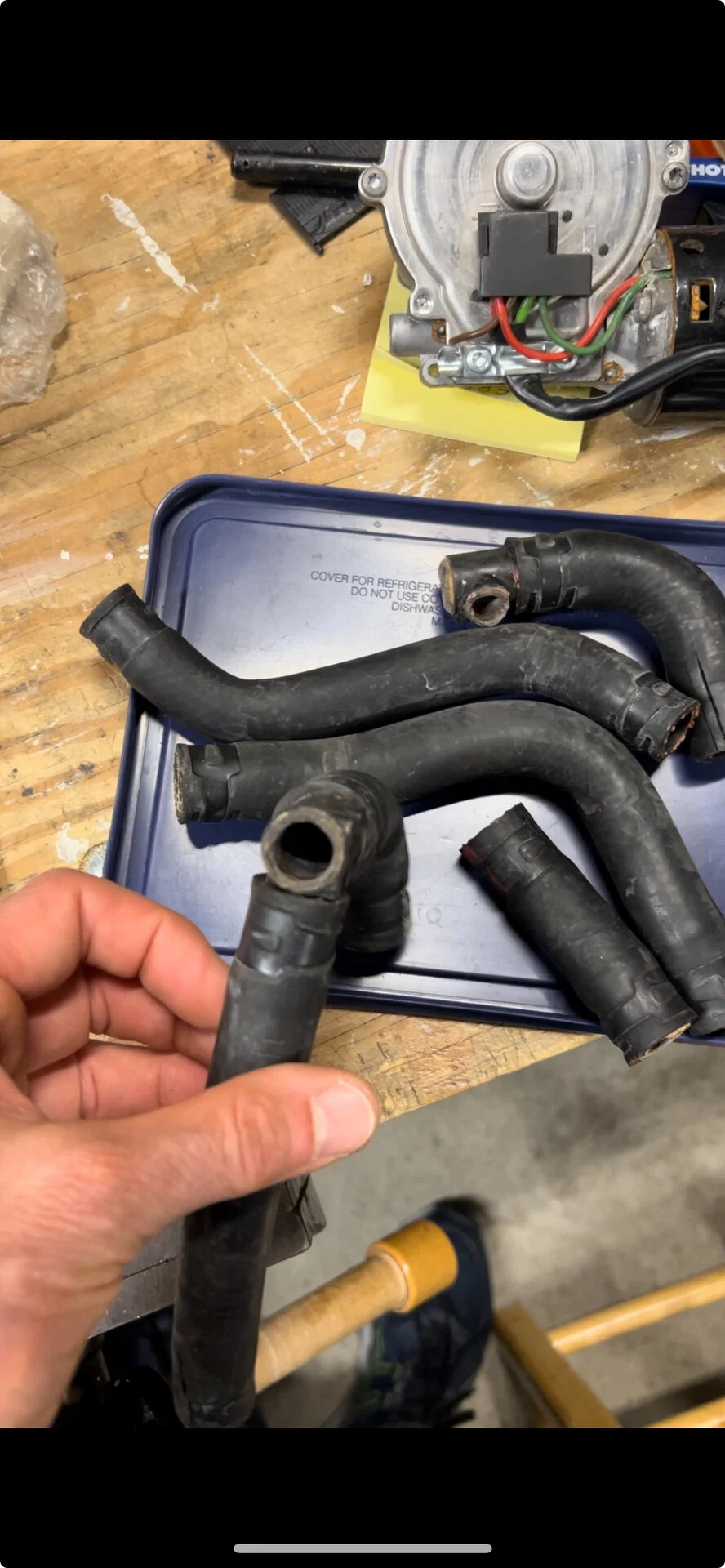

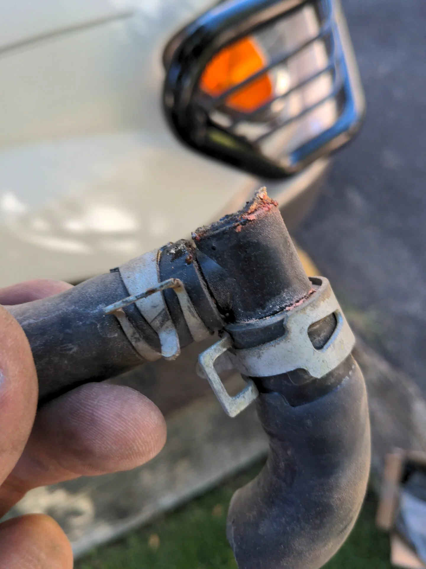

Finally got around to doing my T's and hoses. 2003, 153k The hot side broke with minimal contact. Don't put off doing this!

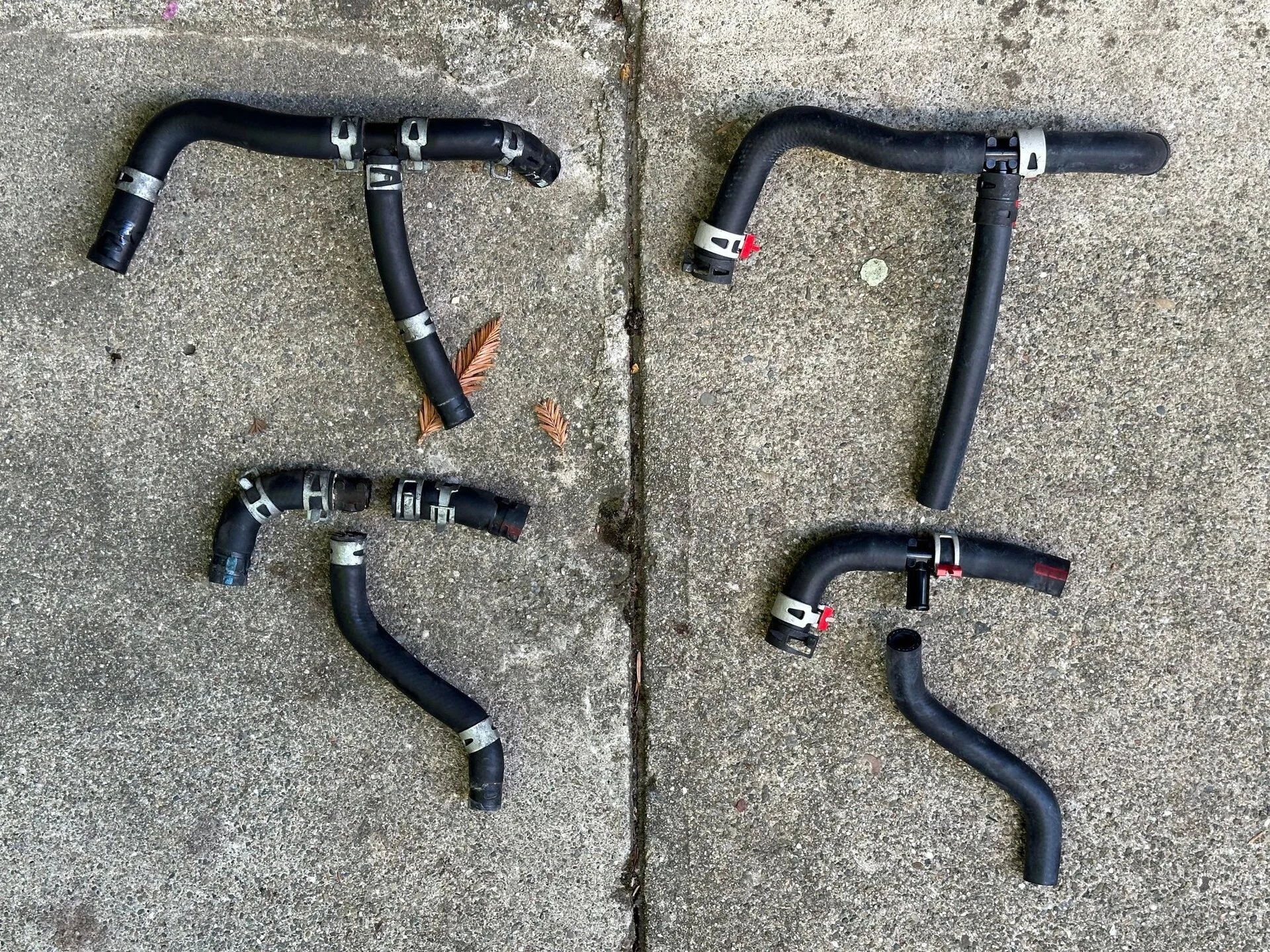

The easiest way to replace both hoses and Tees would be to remove them as 'units', use the intact units as templates to build the new ones (on a bench) then install the new units. That way you are not bent over the back of the engine doing it piece by piece.

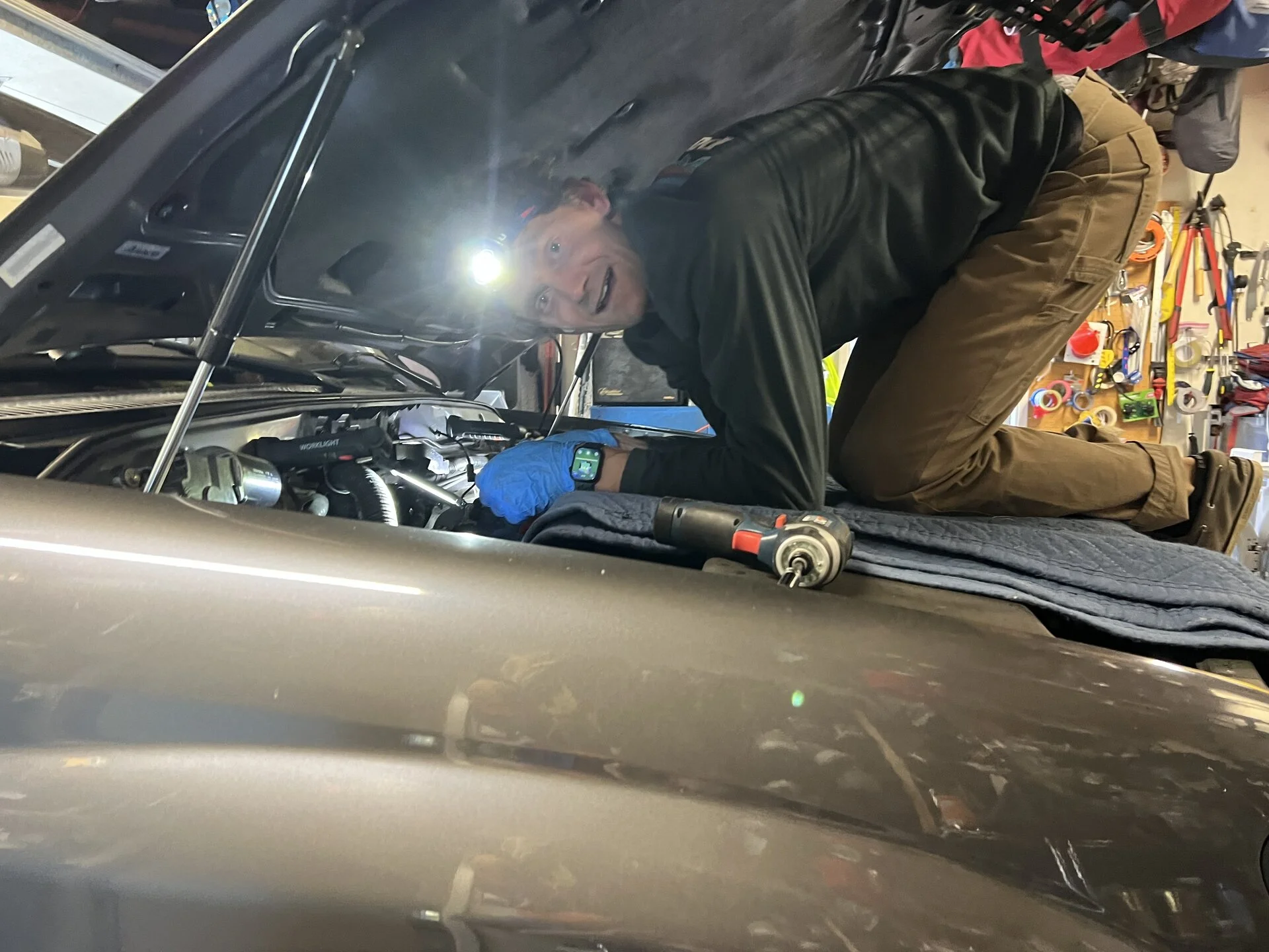

I didn't have top crawler or sheet of plywood but was still able to get this done. Don't let the lack of these things stop you from doing this job. I bought the cheap hose clamp plyer set on amazon which kind of worked. I also just used a regular set of needle nose and regular pliers which also worked well.

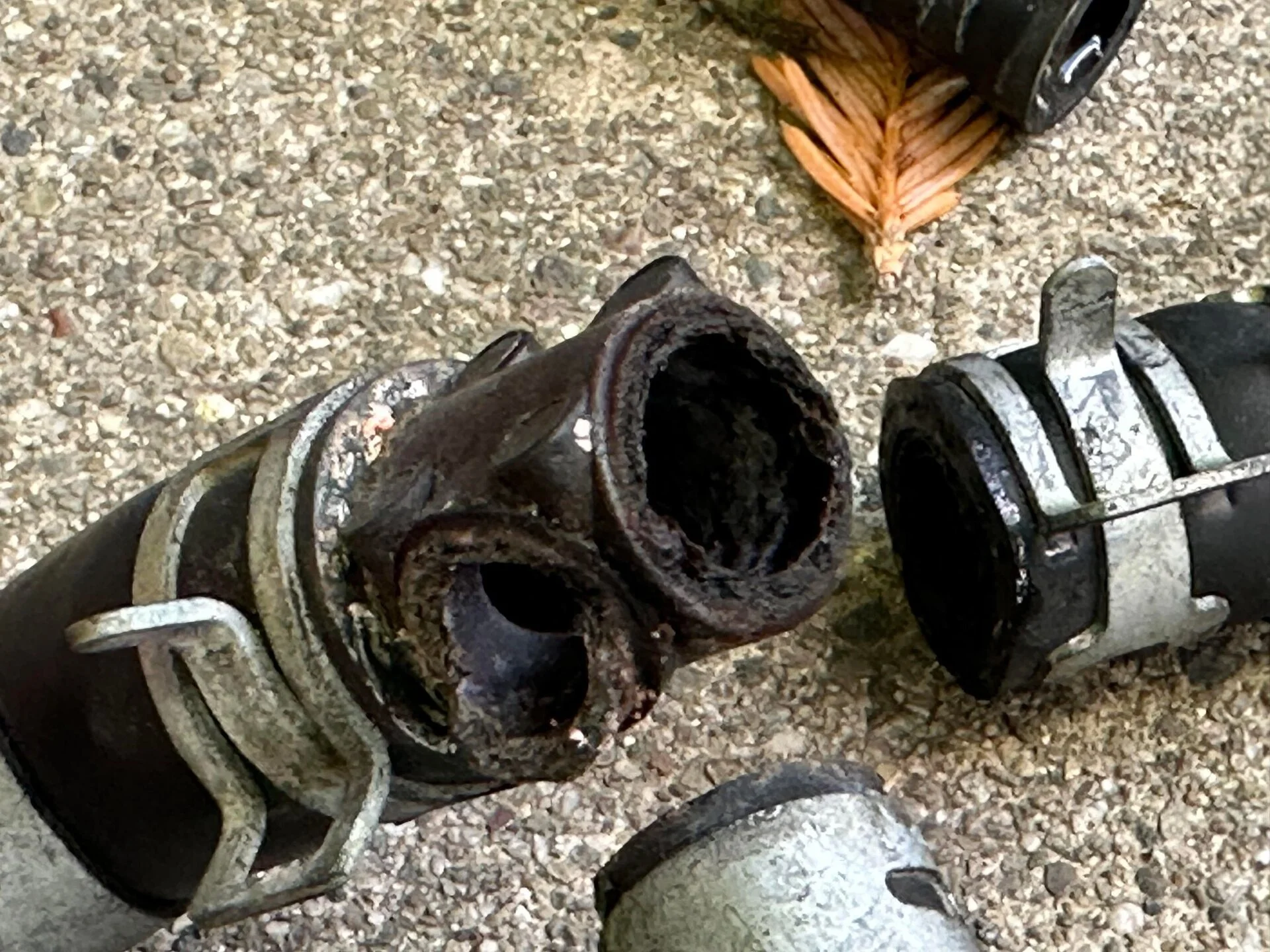

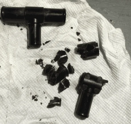

Gory T Picture
And yes, my drivers side T snapped off SO easy when I started messing with the clips. VERY glad I did this job.

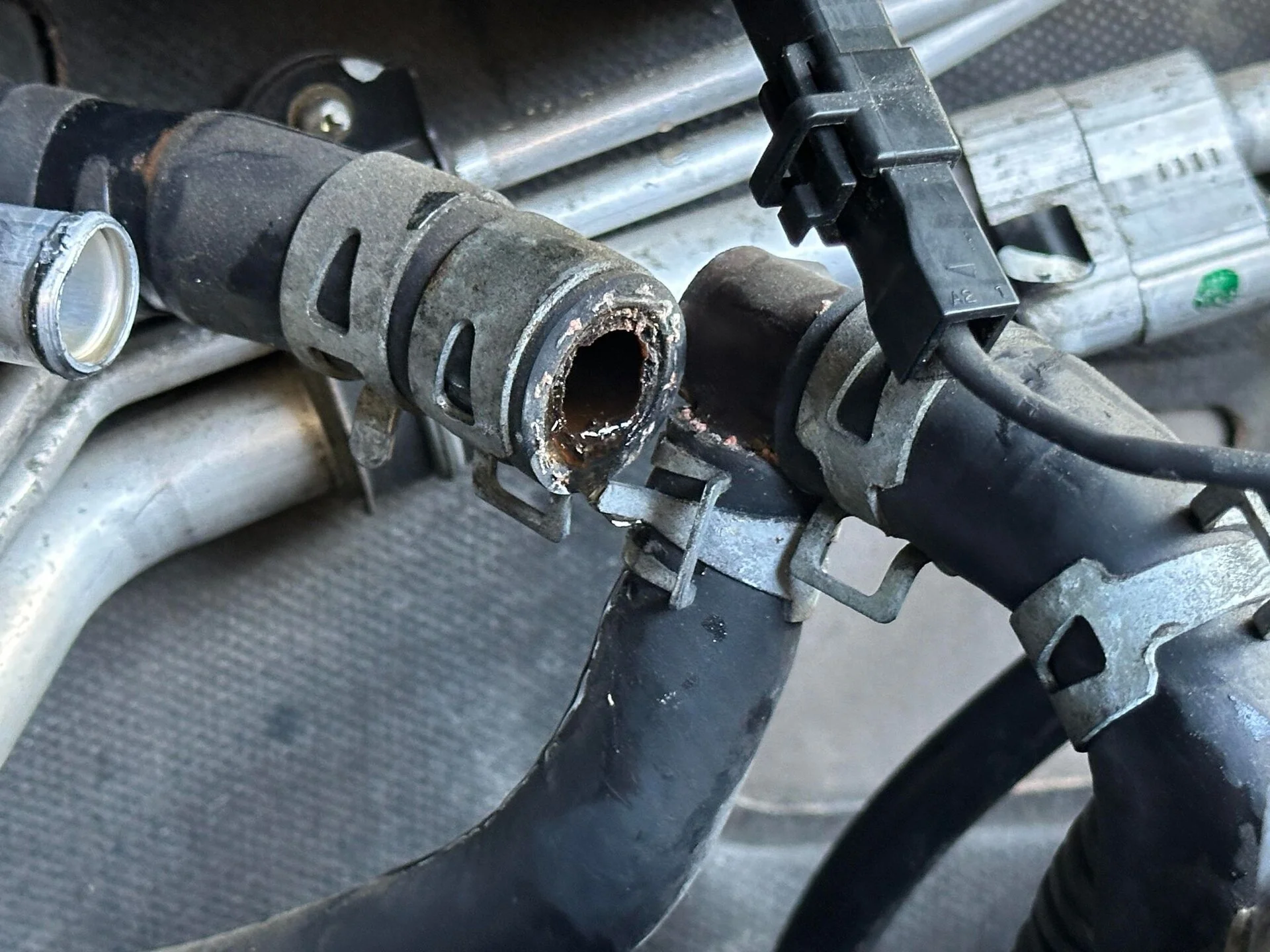

To beat a deadhorse, replace those heater tees. After removing them didn't take much force at all for them to fail.
Noticed a puddle of coolant under my cruiser, it looked like I had enough coolant so I drove to the auto zone 10 minutes away to get a pressure testing kit to find where the leak was coming from. On my way back I noticed I started to overheat and pulled over right away. I got stranded but luckily in my own neighborhood. One of the tees was pretty much snapped off, wish I looked at this thread sooner :bang:

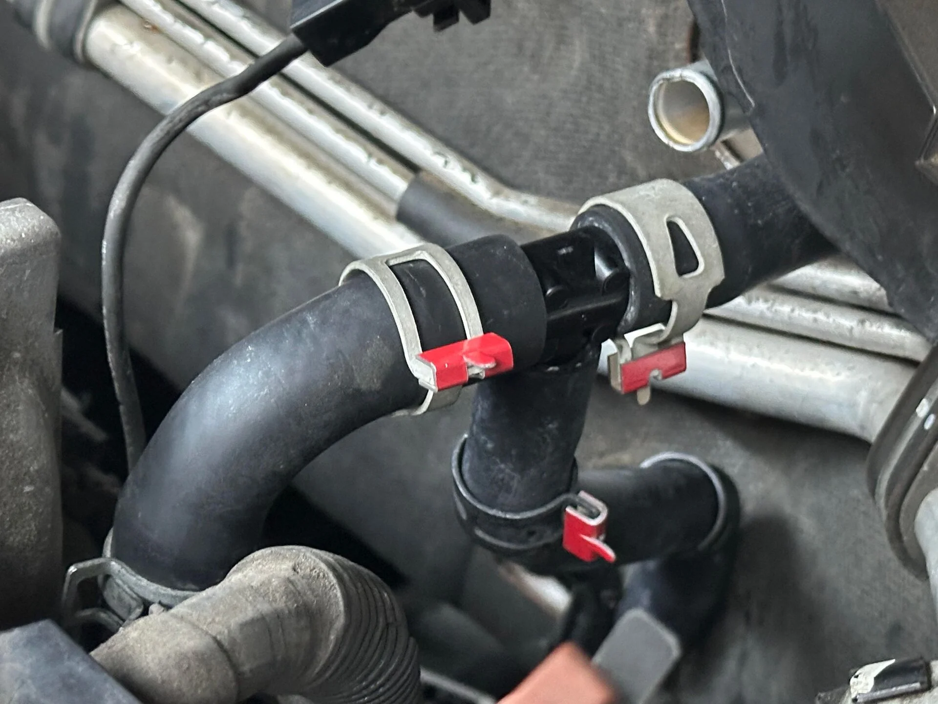

I did T's and hoses this past weekend. 2003 lx470 with 160k miles. Got the OEM hoses and T's as a kit from Wits-end (link below). Followed tips listed throughout this thread - thanks to all the contributors!
- Some plywood with moving blanket on top of the engine made for a nice platform to do the work.
- Removed hoses and t's as a whole unit (t's broke in the process of removal). I cut some of the hoses off as they were very stuck to the truck side aluminum pipes.
- Reassembled new hoses and t's on my bench first but didn't tighten clamps until all assembled on truck to allow hoses to rotate a little to their natural orientations.

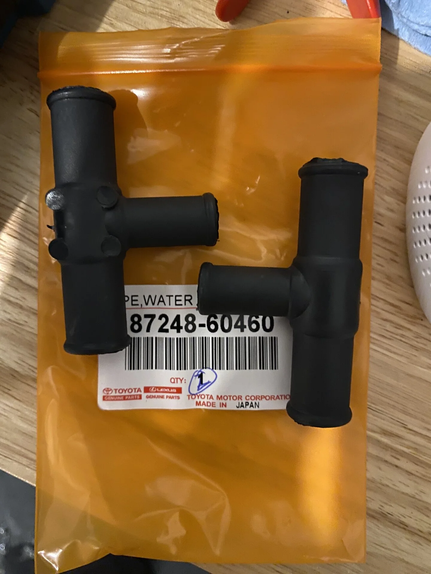

I've never seen OEM parts come in anything but a clear package with the red and white label. Plus, like someone above said, those are WAY crude looking for Toyota parts! They should be smooth and satin-to-shiny in appearance.
Excellent point about the clear packaging.
Those would be going back to the ebay seller if it was me.
