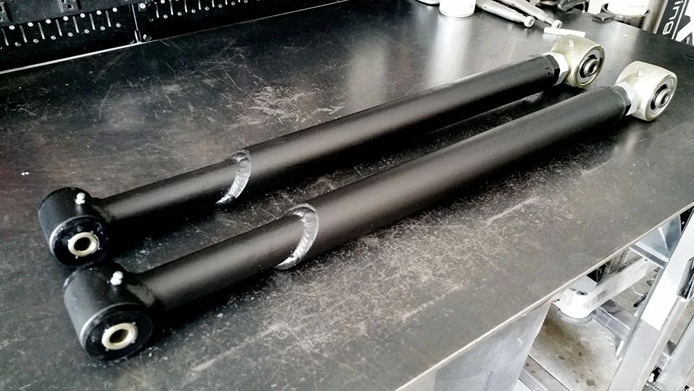

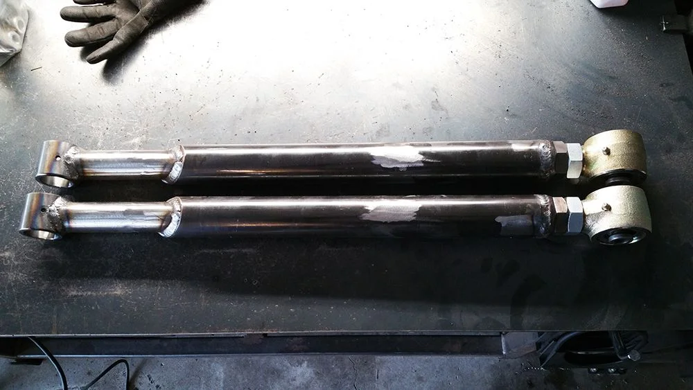

A couple people asked about the arms I made last year so I thought I'd make a quick DIY post. It was a fun little project that anyone with some basic welding and fab skills can knock out pretty fast. I built them to help solve a vibration issue I had at around 65-70 MPH (and it worked!) and also to replace the wimpy stock arms. I didn't want to shell out $300+ on some prebuilt ones because I usually never have that kind of spare loot laying around. Building them myself allowed me to A) buy the parts piecemeal which was a huge benefit for me, B) make them beefier than anything that's currently available off the shelf, and C) save about 30% over buying them. I haven't had any issues with them over the last 10k miles. Here's how I did it...

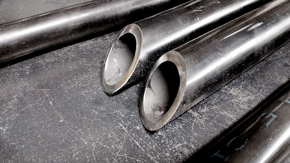

- Cut the 2" DOM in half. Make the cut at 45 degrees.
1909481

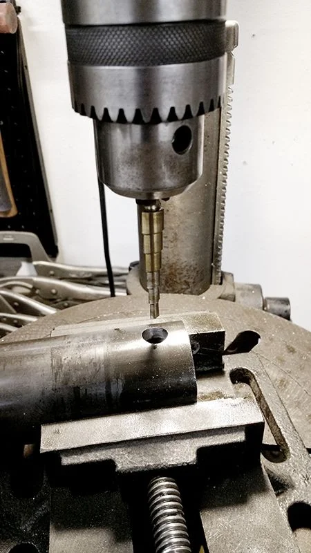

- Drill a 1/2" hole in the square ends and down towards the 45-degree ends of both of the 2" DOM tube for rosette welds (8 holes total, four in each 2" tube).
1909480
- Chamfer the square ends of the 2" DOM tube.

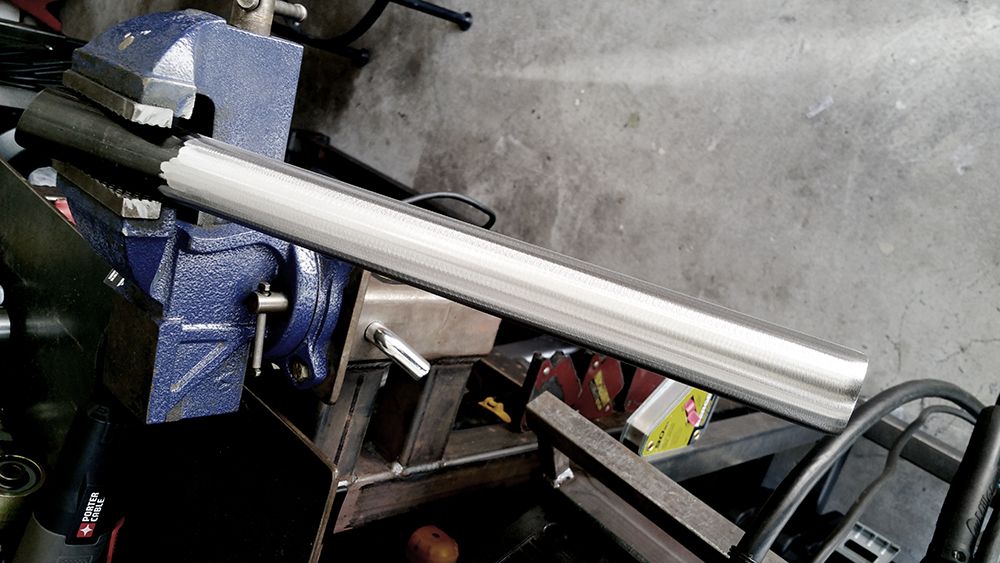

- Since I don't have access to a lathe, I precision-turned my 1.5" DOM tubes with my grinder and flap disc. Shaved off a few thousandths to allow a running fit of the 1.5" tubes in the 2" tubes. A light hand and a few minutes is all it took. Basically just shave off a little more than the skin and test fit as you go.

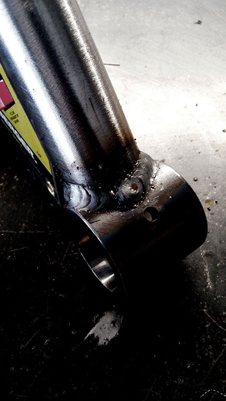

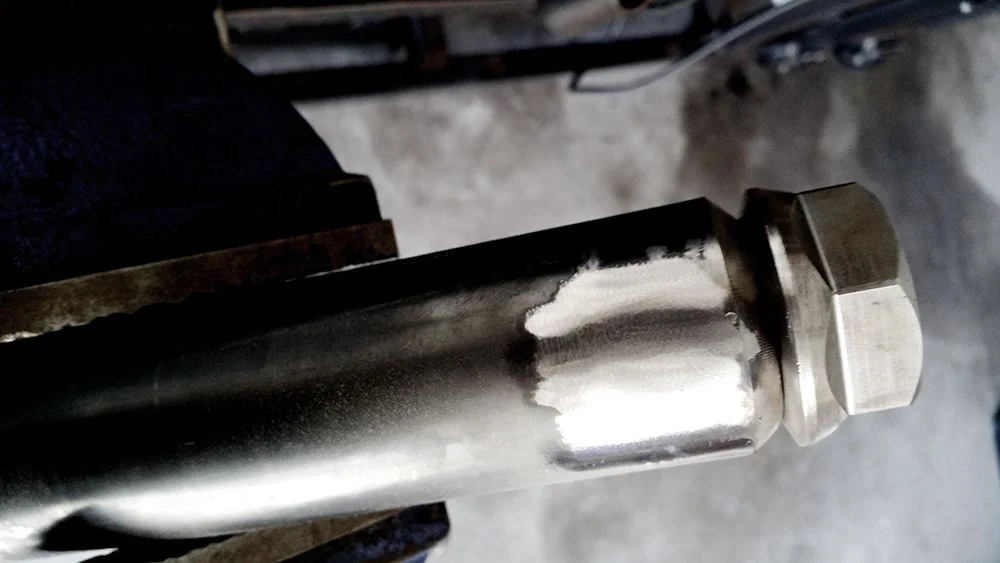

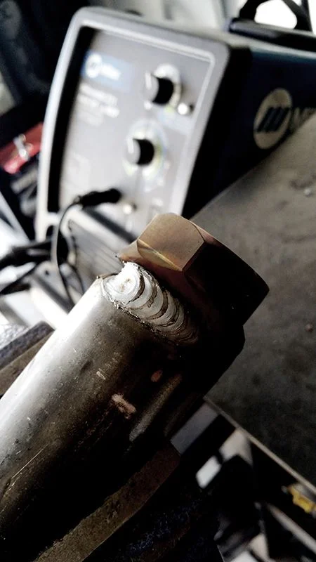

- Plug/rosette weld the adapters into place in the 2" tubes.
1909506
- Weld out the rest on the adapters.

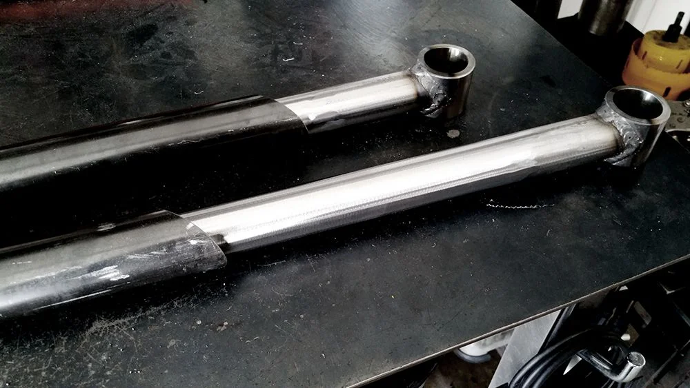

- Weld on the bushing sleeves.
1909513

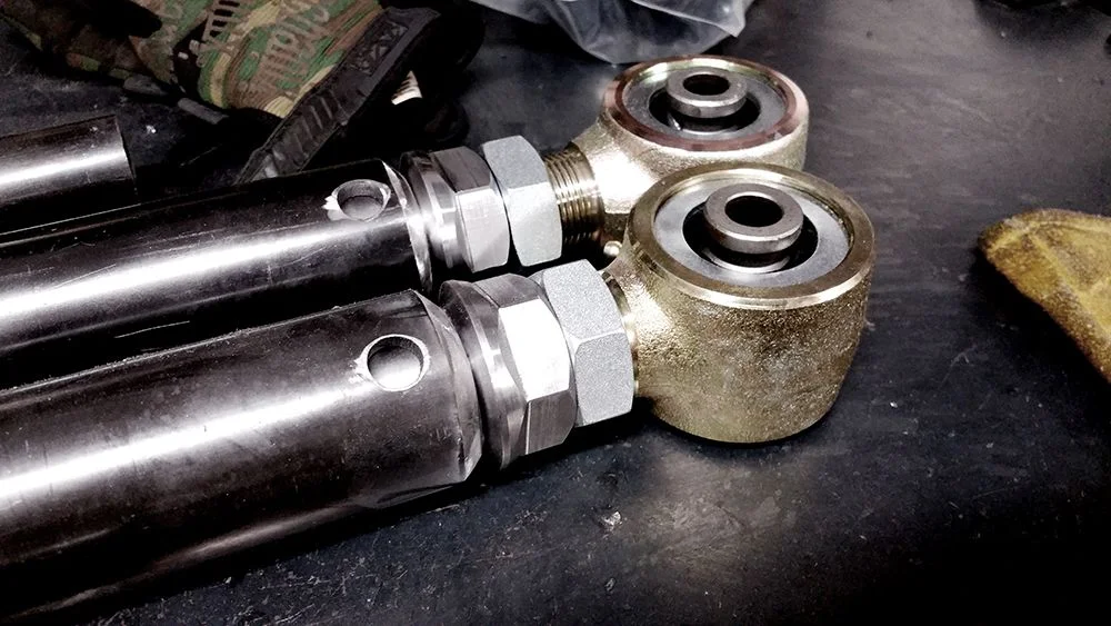

- Slide the tubes into place. Mine took a few super light taps with a mallet to help them in. I matched the OEM length (about 27.5" eye to eye) with the Johnny Joints turned all the way in.
1909514

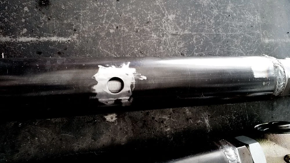

- Plug/rosette weld the other four holes.
1909516

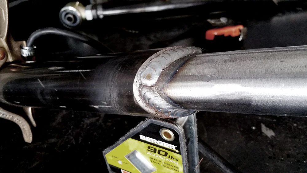

- Weld the tubes together.
1909517
1909518

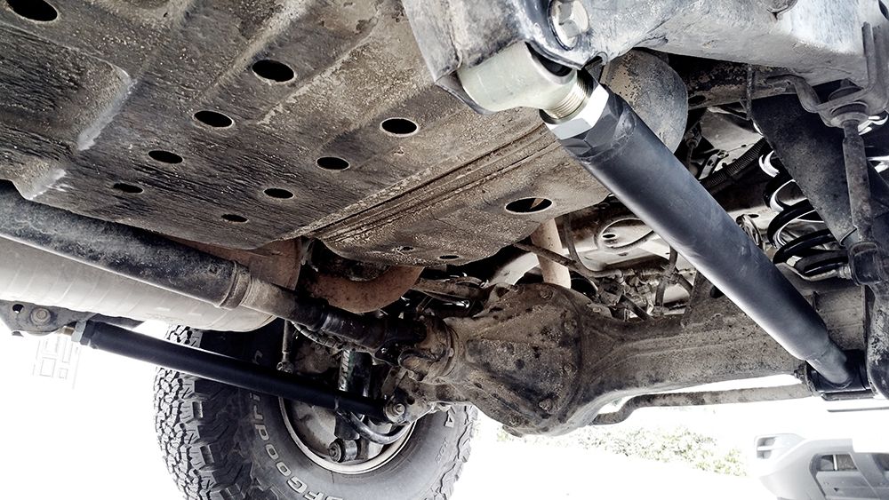

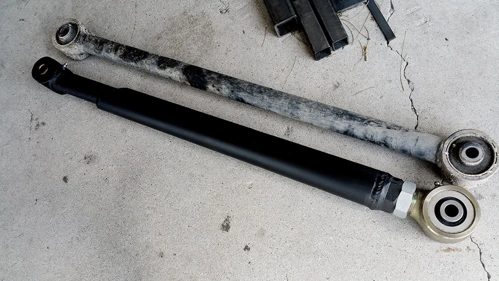

- Compare to stock and stick your chest out in triumph.

Just curious what is the benefit of having 2 different size tubes vs a straight link? Is it stronger?
Stronger, and also lets you still use the larger 1.25"-shank JJ with a weld-in adapter. This saves you from having to thread the tube ends. Some of the ones available from the big shops use a smaller weld in adapter to fit their smaller tube. The smaller adapter uses a smaller JJ shank.
