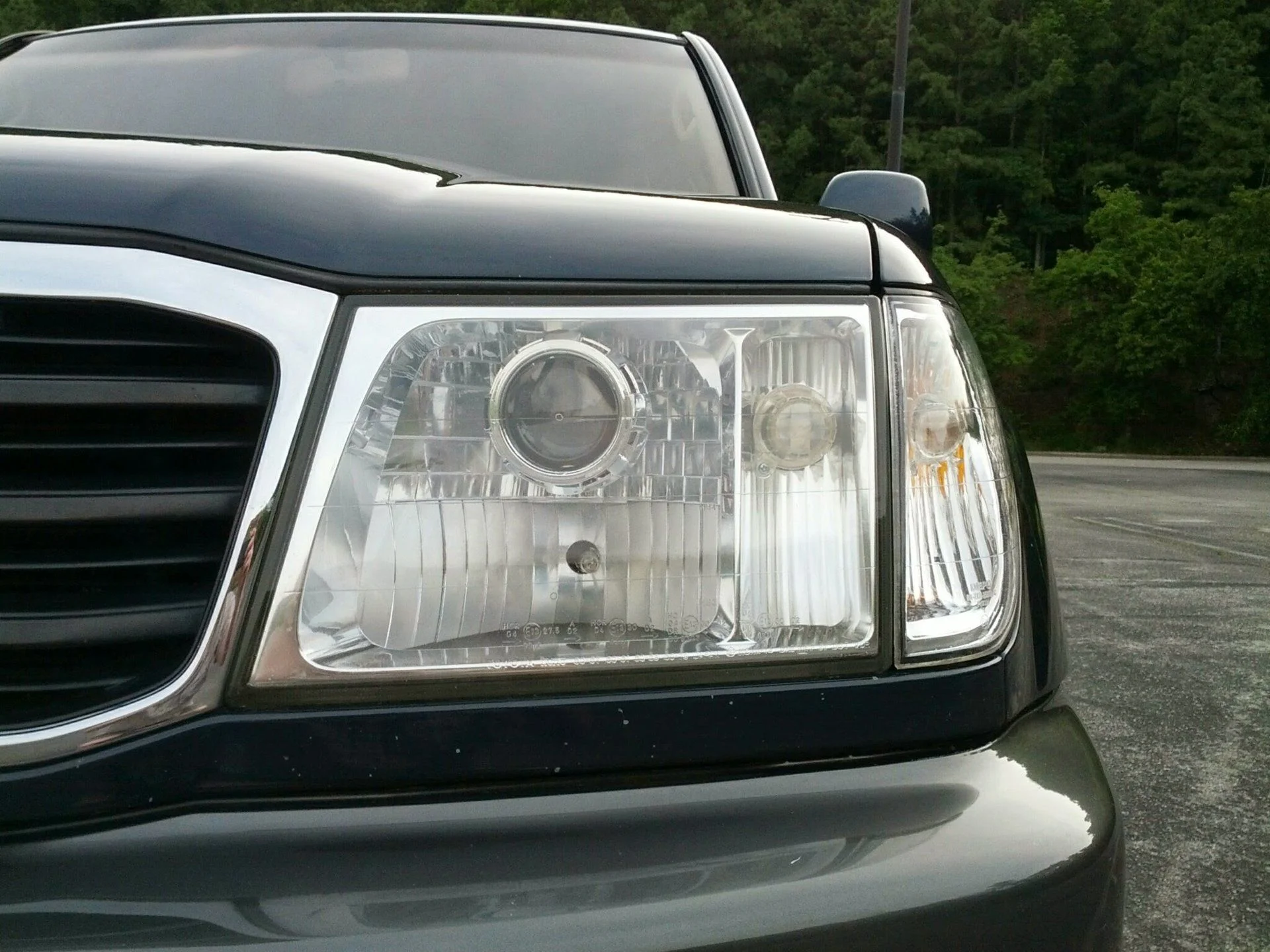

Thanks for the pictures, the depo fitment looks good!
That's the situation I'm in now. I received the 4.0 and a day later the 5.0 was released. Contemplating swapping them out but can't seem to find much info if it's worth the change other than blue tinted projectors and a different cutoff.
I got the d2s with Iris shrouds as well, but with 55w ballasts. Still debating whether to attempt to install them in my oem housings as i like the look of the glass housing better, but I'm afraid they won't fit.
IIRC, the flat part was designed to be on the bottom to fit european car headlights
But the tabs on the shroud don't line up to the holes on the projector!?
I think the shrouds are meant for more upward adjustment. LIghtwerks flips them down and cuts the tabs off and they are taped on with HVAC tape or something like that. There are different versions of those shrouds also.

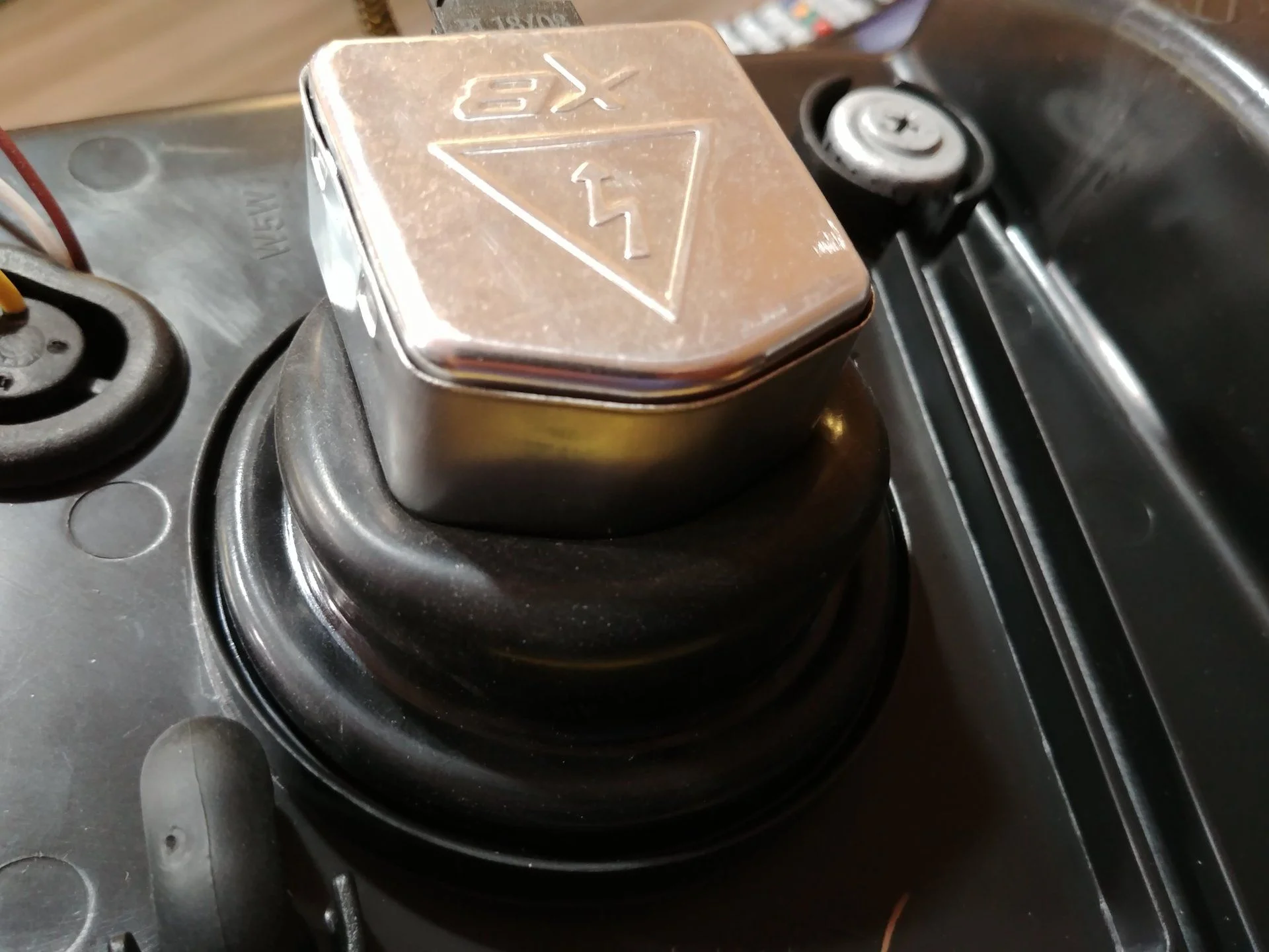

I'm seeing that if you don't bowl cut the reflector you need new rubber back housing seals since it sits deeper in the actual headlight. Amazon has 83mm covers.
i don't understand your last sentence. The shrouds fit perfectly fine. I actually don't mind the flat part being on top. makes it look meaner.

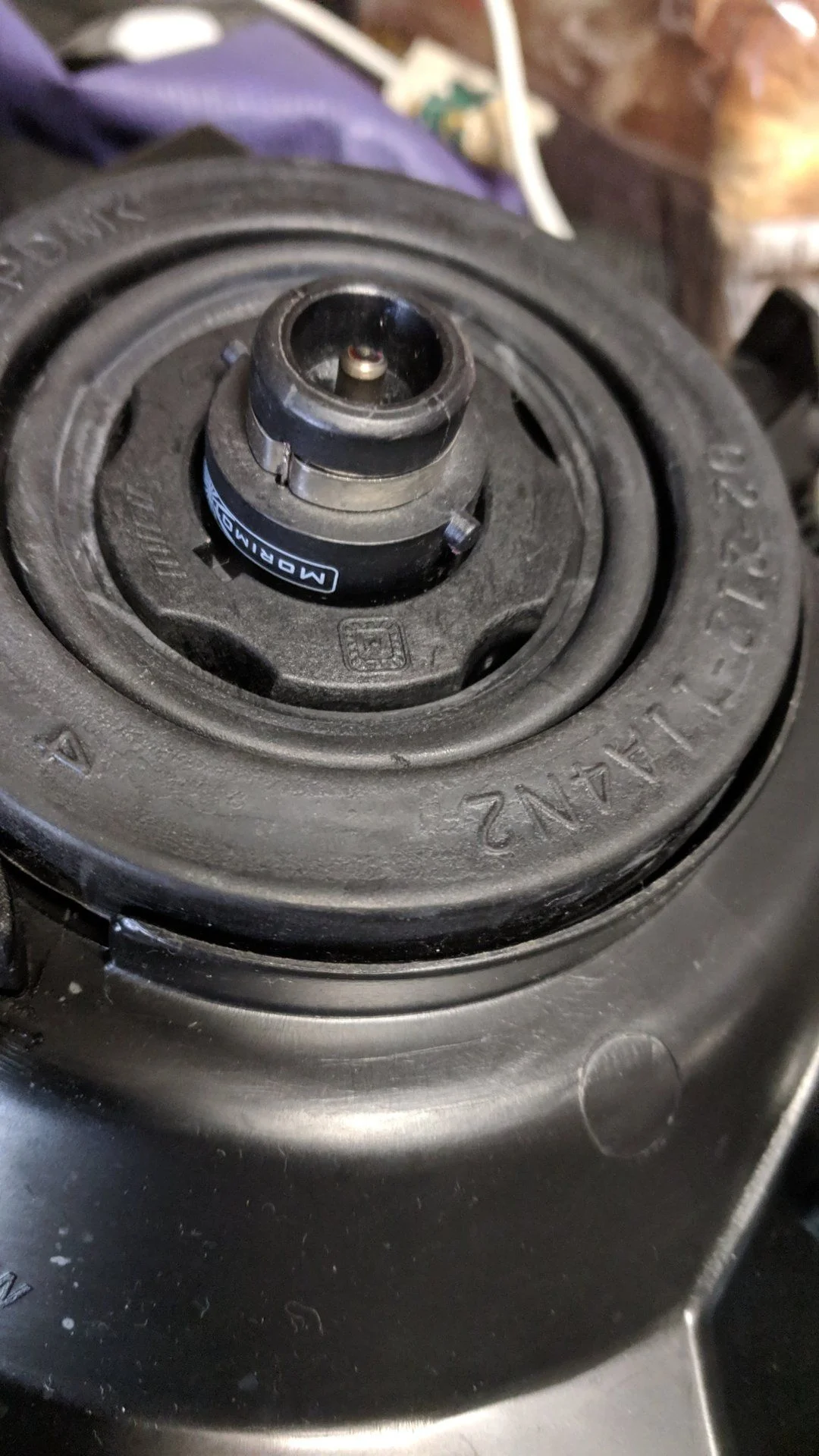

that isn't cut. that's the regular seal. It isn't really sealing anything in that picture.
What housing is this? i had to cut the Depo one piece i got for my 03. They're made for H7 bulbs and have a rubber cover on them that i had to cut.
Now that i'm looking at yours, it seems you're using oem housings with 9006 bulbs. It looks like my oem pre 06 light.
I didn't know there were replicas out there with different bulb bases. The stock back housing seal, the 83mm one that fits 9006 and 9005 bases isn't possible to use if you thread mount the D2S.
the depo 06 and 07 are the same as oem. I have a few sets mixed and matched after an accident, and a professional d2s that I'm going off this install sitting here to compare with.
I was wondering why no one ever mentioned needing a different back housing seal. Seeme like everyone cuts a big bowl out and uses screws (lightwerkz) or just slathers on the JB weld.

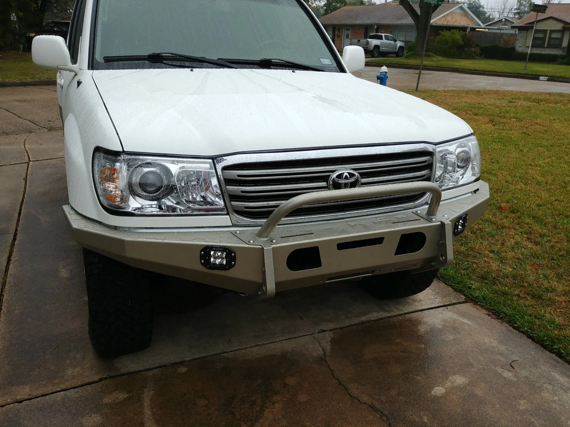

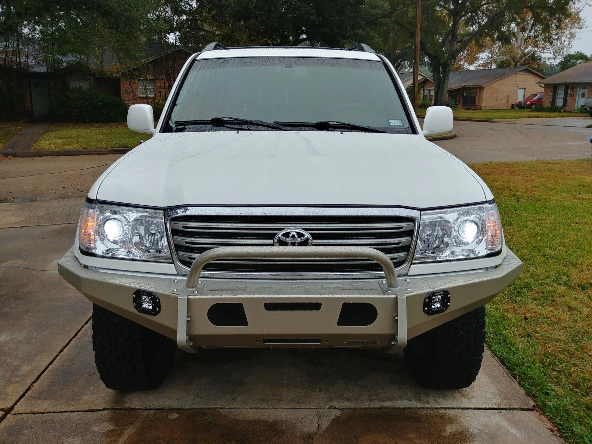

Done! It wasn't bad at all. I still need to finalize aiming, install the wiring relay kit and figure out why my driver's side isn't as bright as the passenger.
So all in all this is what is used,
DEPO 1 piece headlights for 98-05 LC100 from @ranma21
Morimoto Mini D2S projectors from TRS
Morimoto Iris shrouds
Morimoto 55w Ballasts
Morimoto XB35 6500k bulbs (apparantly they drop by 1000k at 55w vs 35w)
Morimoto MOTOHOLD2RS
Stock H7 High beam bulbs with Morimoto 2stroke LED's on the way.
