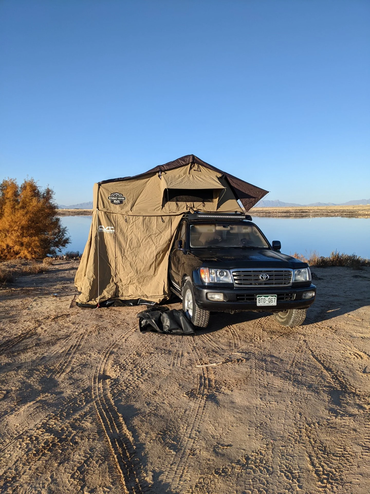

I have to say I just recently did the HID/projector upgrade/modification on my 03 LC and this makes it amazing to drive at night. Before it was like, "Are the headlights on?" "Is one burned out?" I will add that I have the DRL's working and the brights are just ridiculous since now it has the OEM brights and the projectors HID shutter pulls back when the brights are on, it's 4 brights at once. So when the lights are off and DRL's are on, not like we have a choice on this, the shutter is held open by the 5 volts running the DRL's. So far there has not been a failure and if you think about it there are many small coils on vehicles that are constantly energized when the vehicle is running, i.e. relays, ABS solenoids, etc. my 2 cents.

DRL is the high beam at low voltage but your projector is the low beam. So, not sure why the shutter is held open?
I think because the high beam power is being used both to operate the HID shutter and the LED high beam, the DRL power will still be applying the ~5V to the shutter.
Thanks! I thought maybe there was a logic circuit in there that flips the shutter only when low beam was on.
