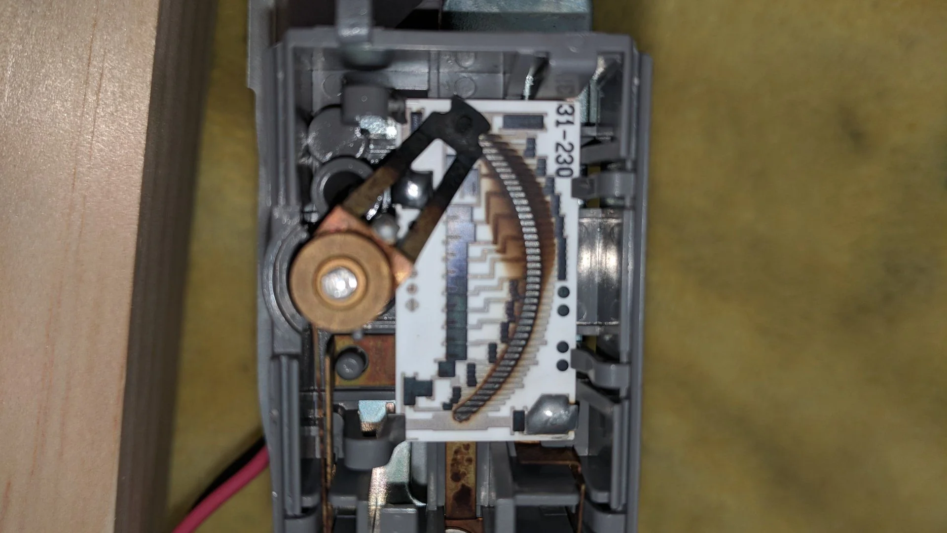

I'd clean the tract or at least look at it before I put it back in. That and the 3 wires are the only thing that's going to keep it from working. I guess making sure the float is free to travel is also good if you could put it in backwards, that box in the tank isn't big. Measure resistance low middle high. Clean and check again.

Upon removal, when lifting the float of the original up and down, the noise it made was not the same as the new replacement. The sort “whiring” noise was minimal, the new replacement was louder and more consistent.
After replacing the fuel gauge is working perfectly. So this fixed my issue completely. Onto the next issues…

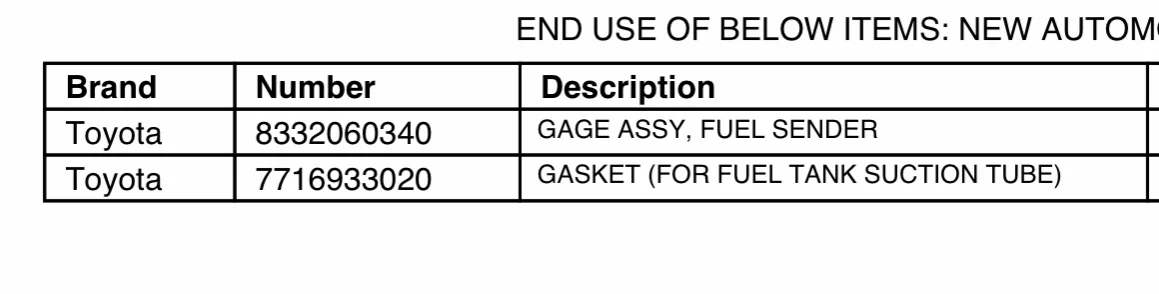

Was going to just replace my fuel pump but now I will replace my sending unit as well. Great write up! Would like to change out the yellow clips, fuel tubing connecting the fuel pump and o ring but I cant seem to find part numbers for any of those things. @2001LC Do you know what parts to order?

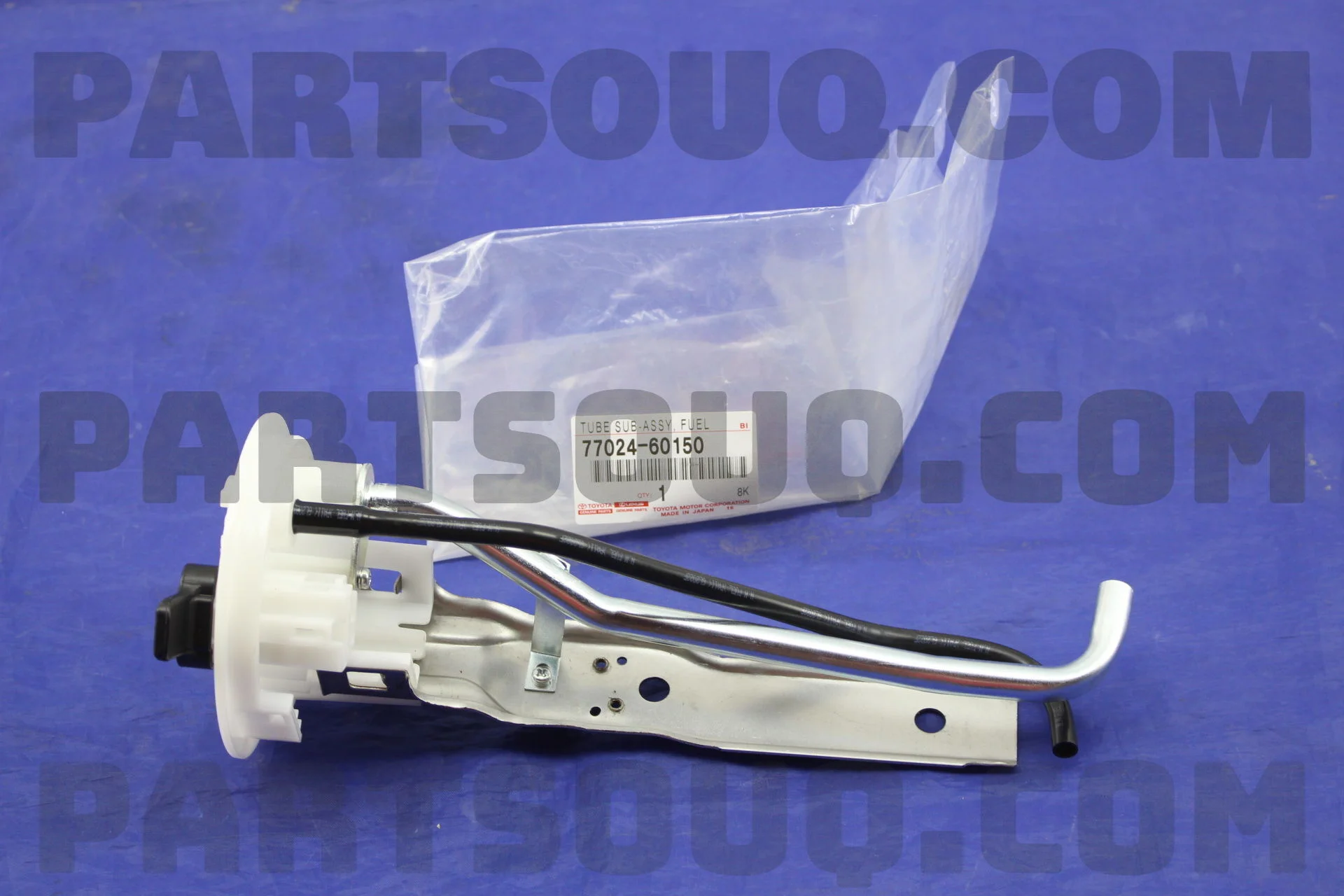

however, my diesel tank is now leaking and I only noticed after the tank was filled right up, a quick inspection on the ramp in my mates garage without removing the tank guard it looks like its coming from above the tank so I guess first thing to do would be to replace the sender unit and pump and gasket ring.
Im having trouble sourcing the sender unit with the pump and float, I guess the float can be used from the old unit but should I be replacing the pump too? I cant for the life of me find the correct pump, its not on the partsouq diagram with the rest of the unit and everything else to do with the tank.
