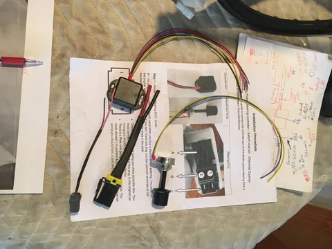

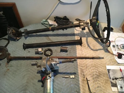

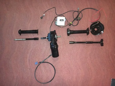

After some more research (aka googling) I figured I'd build one myself and started assembling the pieces. I started with a spare column bought off another member and the power steering assist unit and controller on eBay. Trying to figure out all the other parts and the right couplers to use was a bigger exercise - until I found Ken at Welcome to ePowerSteering.com. Ken was EXTREMELY helpful providing the right pieces, trouble-shooting some problems (self inflicted), and calibrating the system. I'd STRONGLY suggest buying from Ken instead of cobbling the pieces together yourself. If I do another car he'll be my first call - well worth the few extra $s for the assistance he provides. He also tests everything vs. the risk of a junkyard or an eBay purchase and welds the correct spline on the input shaft - which was a bit tricky for a novice welder like myself. This is definitely something that can be done by the DIY hobbyist or Ken has some local fabricators that can do it.
Here's what I needed -
  • power steering assist motor (ebay this time but Ken next time)
  • control box (ebay this time but Ken next time)
  • electrical connections (got from Ken)

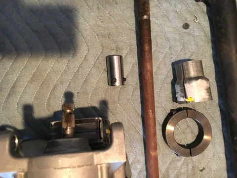

  • splined connection to weld to steering wheel side of the unit (got from Ken)
  • weld on splined connections for the cut inner shaft (Woodward C102 and C114 per Ken) SEE OCTOBER UPDATE!!! ONE FAILED!!!!!!
  • upper tube flange (Ken)

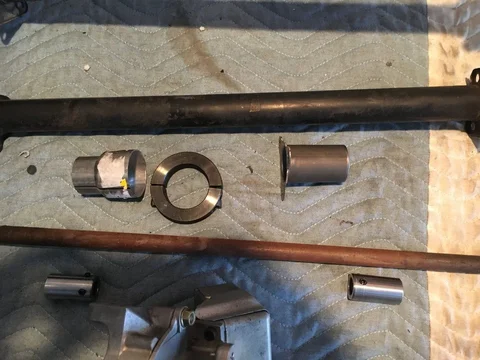

  • lower tube flange (Napa #EXH 41939)
  • shaft collar for lower tube to box connection (MSC #75241448)
  • various electrical bits - your application may vary. I ended up putting a 2nd fuse box for this and some other planned additions behind the duct work on the passenger side footwell. I also had my alternator re-wound to 105 amps.
I've had it working for a couple weeks now. I'm very happy. The adjustment knob is a nice feature. All the way counter-clockwise = off on mine. I've got it at about 30% on the FJ40 which seems good. Steering gets really numb above that. I was told the unit could draw 50 amps...mine clearly is not. I only had a 40 amp fuse handy and even with 100% assist and full lock-to-lock with 30"x10" MT tires the fuse doesn't blow. I've also watched the voltage on my multi-meter - not much of a drop.
I will admit it's not perfect and would do a few things differently the next time.
  • I should have measured 3 or 4 times and cut once vs. measuring twice. I would have mounted the unit about 3/16" further from the firewall. I had to notch the brake pedal slightly - which was also mentioned by a poster in the thread about the EZ kit. Another 3/16" would have made a big difference.
  • The Napa flange and the flange Ken supplied for the outer tube are not exactly the same size as the FJ40 outer tube. I'm not very good at TiG welding thin wall round tube and not being a perfect fit made it tricky for me to weld. Structurally I'm confident the tube is strong - but I did have to do some grinding and bondo to pretty up the appearance.
  • The motor for the unit is really close to the fuse box. There might be a better option with a shorter motor available. I can still change the fuses but it is close. Could be possible to relocate the fuse box slightly.
  • The shaft collar solution to attaching the lower outer tube to the steering assist unit works...but is a bit clunky. I'd probably do that different. Maybe slot the tube and weld a couple nuts on either side of the slot w/ a bolt to tighten.
