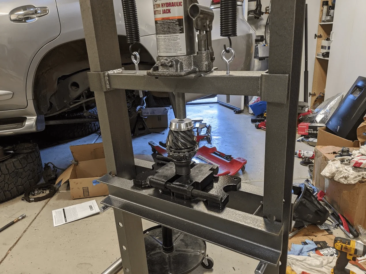

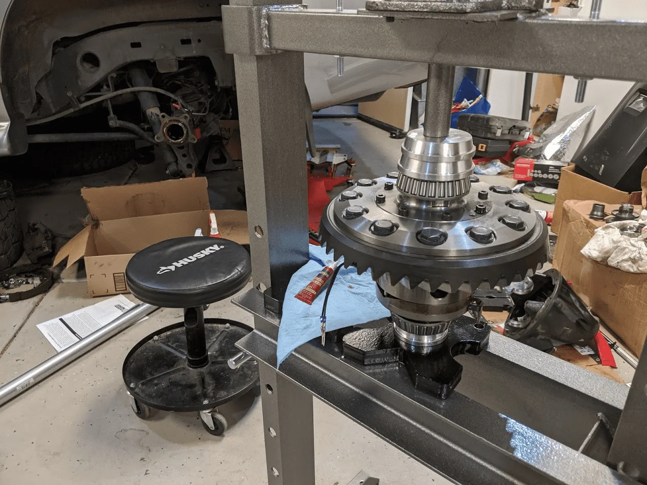

Got my Harbor Freight 12-ton press setup. They've improved this thing since the last time I had one about 13 yrs ago. Should be able to sell it easily and recoup most of the cost once I'm done with it.
Made quick work of the pinion and case bearings.

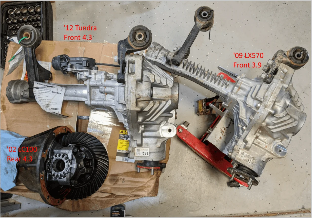

Good info... I'll try to get some pics of the Eaton units.
Were you able to get any pics or measurements of the Eaton? Wondering if they're more similar than not?
No pics... I'll keep trying.

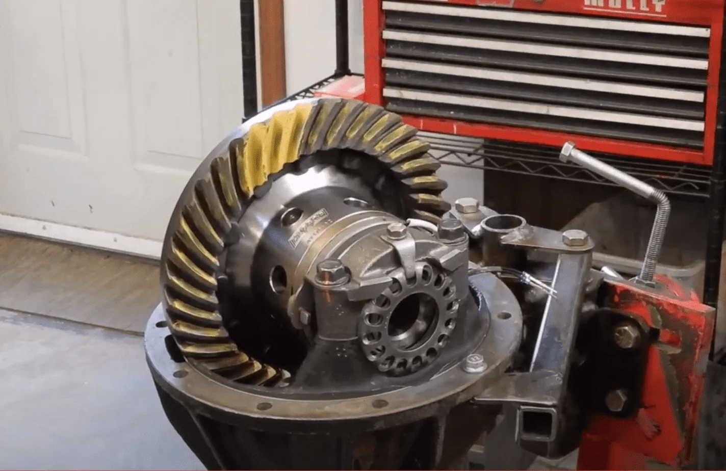

If you can see in this pic grabbed from Otramm's vid, it's clamped firmly by the carrier main bolts, with pressure from the side adjusters, that's then locked down with the stop.

The pinion from the LC100 uses a different diameter drive flange interface than the LC200. Measuring 28mm to 32.7mm respectively. The shaft at the outer bearing (nearest flange) is smaller too. Both use the same large inside (nearest pinion gear) tapered bearing size. LC100 outer tapered bearing external diameter against the carrier is the same.
I was hoping to harvest only the LC100 ring and pinion, to rebuild everything in my LC200 case. Didn't expect this and perhaps I'm wondering what other dimensionional differences there are? Easy button may be to rebuild everything in the LC100 carrier housing, since it's been confirmed that the carrier will drop right in.

The pinion from the LC100 uses a different diameter drive flange interface than the LC200. Measuring 28mm to 32.7mm respectively. Both use the same larger front tapered bearing size. TBD for rear.
I was hoping to harvest only the LC100 ring and pinion, to rebuild everything in my LC200 case. Didn't expect this and perhaps I'm wondering what other dimensionional differences there are? Easy button would be to rebuild everything in the LC200 carrier housing, since it's been confirmed that carrier will drop right in.

Ah. I'm not familiar with the 8", but the retention on the 9.5 seems very sound. Neither of the 9.5 carriers I disassembled, including the '02 with 172k miles, had any unexpected play. They were both drum tight.
That fixture is awesome. Did you weld that up? Nice!
That's Otramm's shop. Grabbed a frame from his vids.

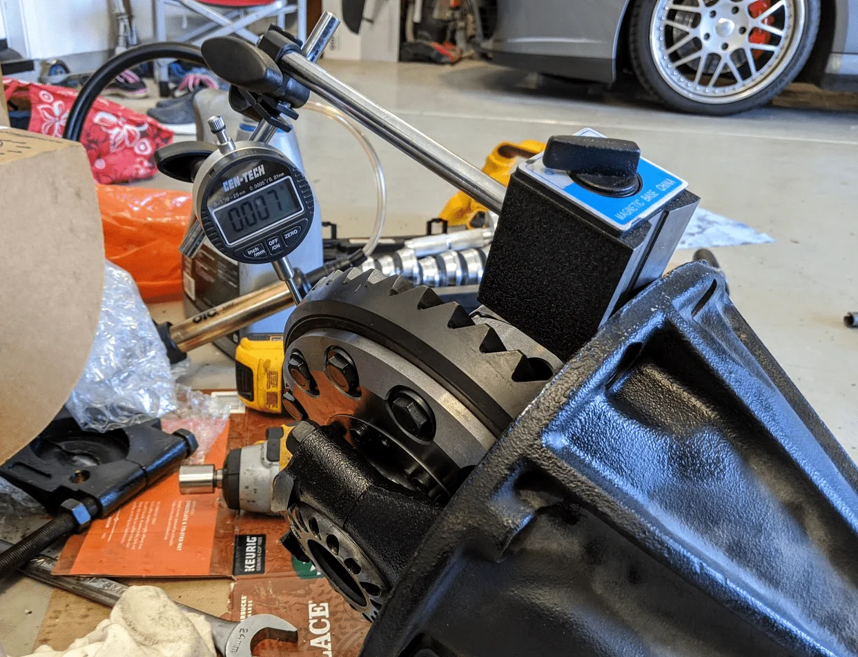

Initial setup bringing the case, gears, and carrier together. Things are looking pretty good including run-out and backlash. Pattern checks out without any change to the pinion master shim that belonged with the 4.3 pinion. I didn't measure them other than to note the LC200 3.9 master shim was incrementally thinner. I used some bright blue marine grease that I had in my cabinet to check the pattern, did the job, but hard to photograph.
