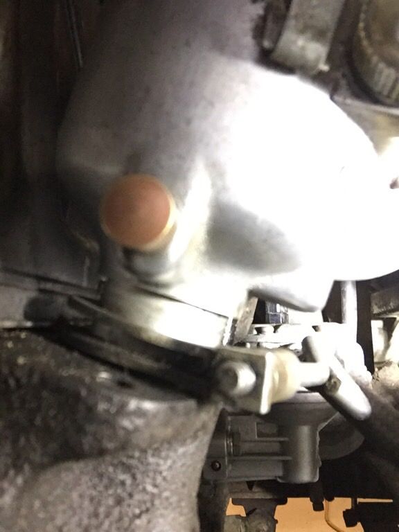

@65swb45 I think I have this all the way seated but thought I would send you a pic and some measurements. How does this look?
The measurement at the top of the clamp to the bottom of the bell (machined part) is 3/8. I compared some measurements next to my HEI and it's the same depth into the block. The picture of the machined part with the line on it is where i took a pencil to where the clamp sits.

I have a header in the way which makes it darn near impossible to do that without taking it apart. I just did some backwards math and determined this is how far it sits into the pump.
It doesn't bottom out but it sits in the groove pretty deep. The closeup picture shows the distance in space between the bottom of the disti and the floor of the pump groove.

I just measured the depth of my old disti and my new one that I think is seated as far as it goes and they are the same measurement. I'm thinking we are all set. Let's hope

3/8 just sounds like too much to me.

Oops, made an error. Exact measurement is 5/32. So just a hair over an 1/8.
Ok. With the shallower clamp, that is an acceptable measurement. Watch your guage at startup and just be mindful.;)
