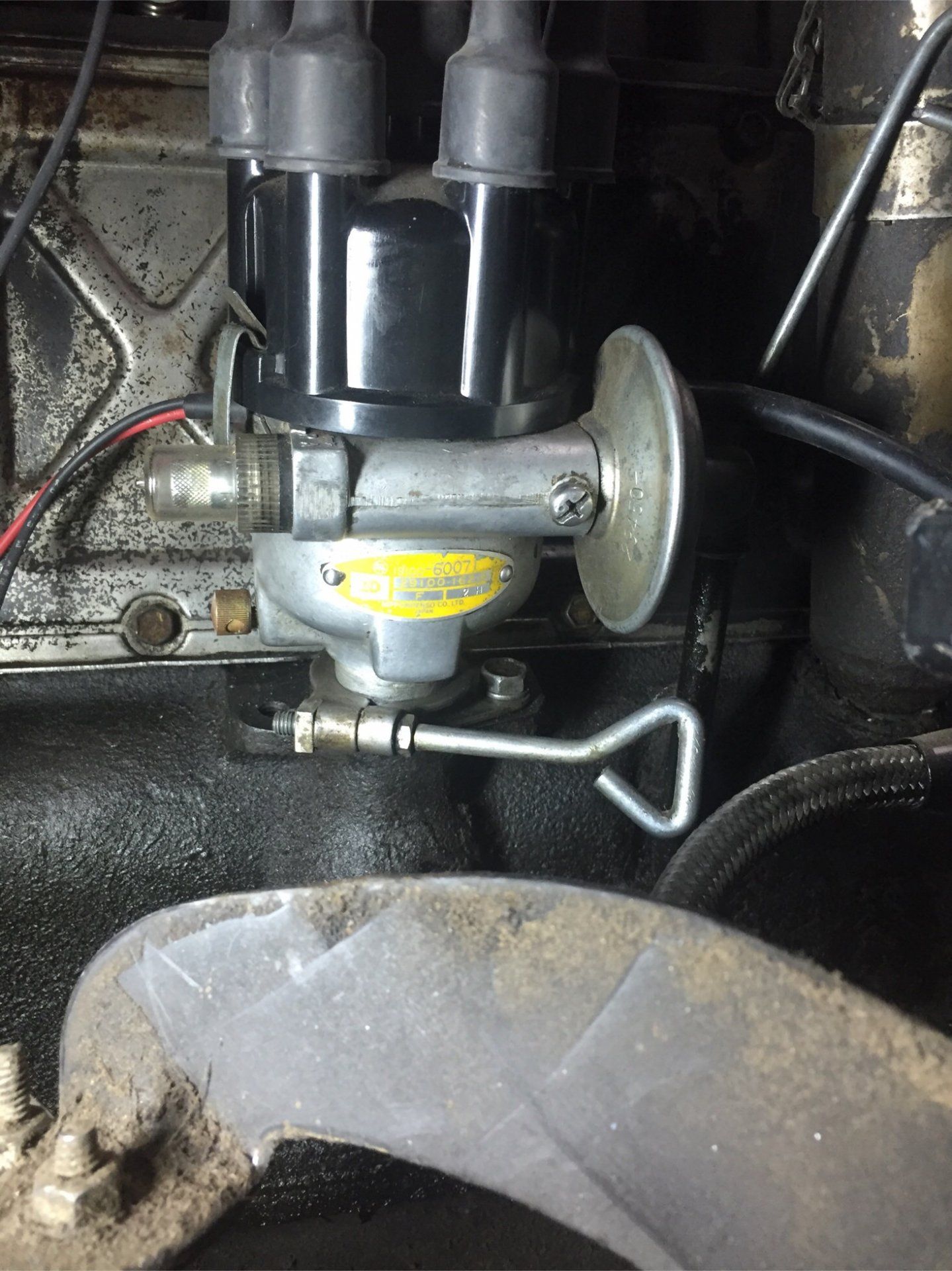

Just for confirmation, I put the pertronix in my original dizzy (eliminating an external electronic ignition jumble of mess). The thing started right up the other day and ran great. Stock coil from SOR. And now it sits, body off, for a year while I'm working out of town... so bummed.
Only thing wrong with this picture, I believe, is the coil was originally mounted with the wires down... but I like it this way. As you can see, I've got the Weber too... on the list to replace somehow, some way.
Looking forward to watching your progress.
bb67tlc, the mistake you might be making is using a stock Landcruiser coil. The Peretronix flamethrower coil is a 40,000 volt coil, the stock coil is only 18,000 volts, and can not keep up with the demands of the Pertronix breakerlss ignition.

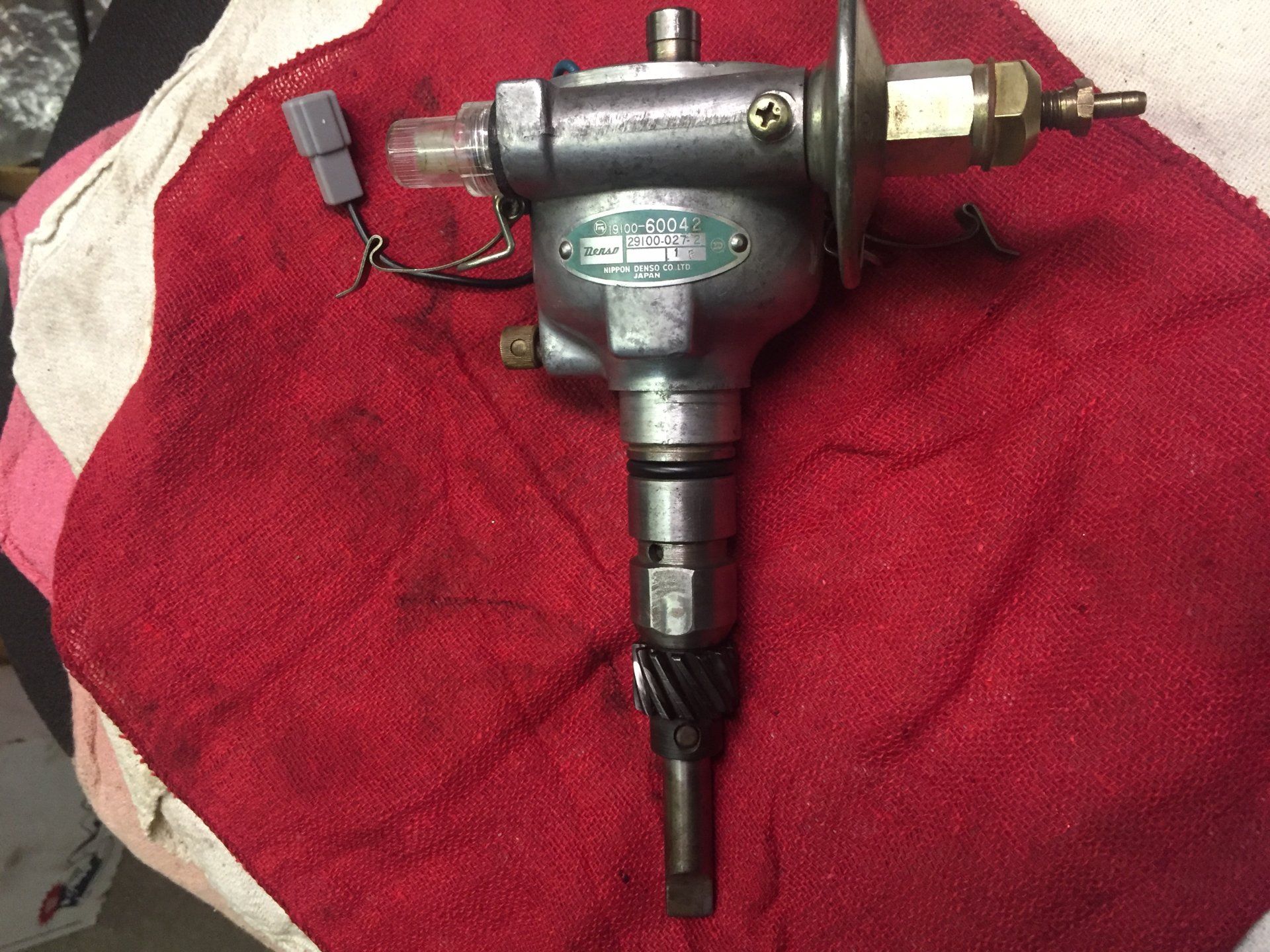

When I talked with @thebigredrocker yesterday, and shared with him my tale of distributor woe (brand new aft dizzy from a reputable vendor failing in less than 2weeks) I told him I had ordered a brand new dizzy from Mr. T. Well, when Mr. T said I wasn't gonna see my new dizzy until at least Monday, and Monday is a holiday, I started getting itchy. I didn't have any rebuilt on the shelf. But I do now!

When I talked with @thebigredrocker yesterday, and shared with him my tale of distributor woe (brand new aft dizzy from a reputable vendor failing in less than 2weeks) I told him I had ordered a brand new dizzy from Mr. T. Well, when Mr. T said I wasn't gonna see my new dizzy until at least Monday, and Monday is a holiday, I started getting itchy. I didn't have any rebuilt on the shelf. But I do now!View attachment 1403920
Oooh lala. Is that for sale? Left you a message at the shop, kind sir.
Old school, dressed to the nines. Low mileage unit I save for a special customer...like myself. Put three solid hours into disassembling cleaning, detailing a resto worthy unit, right down to the tag.
So as I'm cleaning up, the phone rings and I see the caller ID is you. My hands are full and I don't feel like stopping to answer just to tell you that I don't have anything on the shelf ready to go.
TWO MINUTES LATER there's a knock on the door and Mr. T delivers the new dizzy. Karma. Take your pick. All I ask is that you don't pick my brain and purchase elsewhere.
Thanks for the setup and installing the Pertronix in the distributor for me. With my luck, I would have messed it up.
Paypal sent!
Josh's brand new dizzy has these two funny wires sticking out of it that mine doesn't.;) Mine has an old-school cam that fits under the points plate. Pics tomorrow under a different thread.
