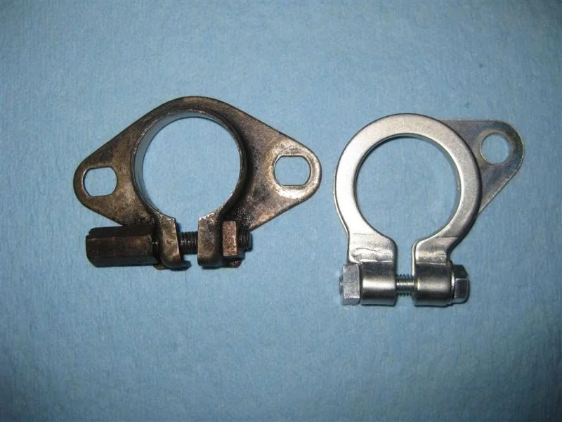

Just had to pull the new dizzy as it is exhibiting the same symptoms as the old one - binding of the shaft and metal dust/shavings in the base of the dizzy below the springs. What has happened is the unit begins to bind and it rotates the housing in the hold down to the point that it throws off the timing - which is good because it alerts me to the problem. I am almost certain it is NOT a manufacturing defect with the dizzy and am very grateful to Trollhole for supplying me with a new unit. That said, I need to sort this out.
Since the metal powder/shavings are inside the dizzy housing there must be something going on internally. I have the vacuum advance line going to the base of the carb which should be correct. Other than that there is not much to these units. I'm at a complete loss at this point as to what could be causing it.
I will disassemble the unit tonight and try to figure out what is wearing exactly. . .
Disassembled the dizzy but could only get down as far as the plate below the springs and weights. The plate is pressed in place so I couldn't get under it to take a look. I did clean the area behind the plate and a lot more metallic dust came out. I oiled it a bit and and it is spinning freely. I had a spare dizzy that I am running for the time being and it is running fine for now.
One thing I did realize is that the distributor hold down clamp does not appear to be the original OE Toyota clamp. This may have something to do with it - I will be picking up a new clamp from Toyota just to be sure.
Interesting. What was the reason for getting a new dizzy in the first place? Has your motor been rebuilt in the past? Did you send the other Dizzy back? I can't remember.
Motor was rebuilt by PO. Not sure which motor/application that clamp would have come off of originally. It's possible the old clamp was holding the distributor slightly off center once tightened, putting pressure on the bearing that wasn't intended. I can send you back the dizzy I took off if you like - it has been cleaned up is spinning freely now if you want it.
