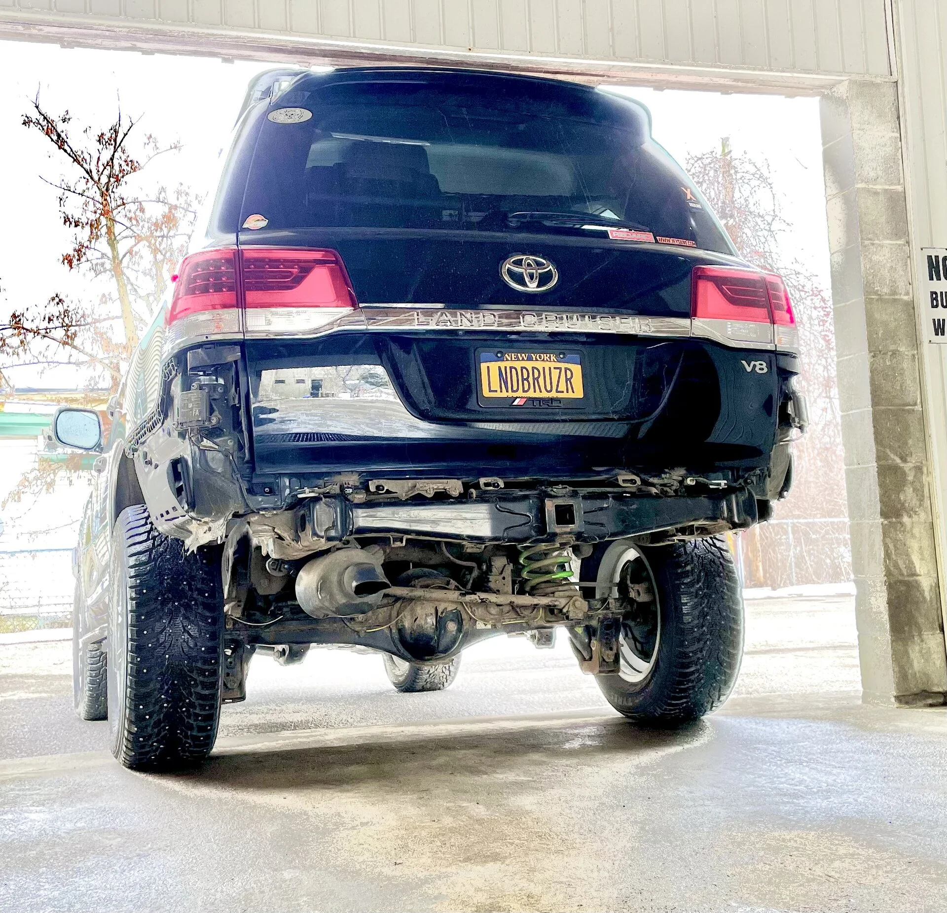

chop that resonator off and PM me if you need real-time help.
