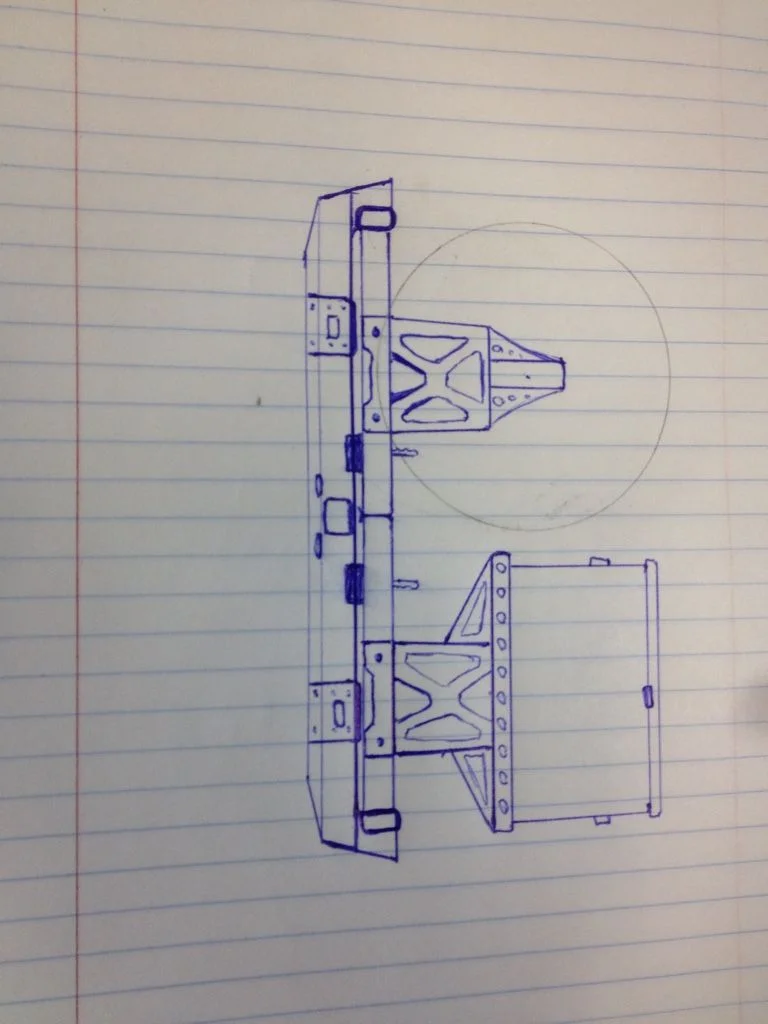

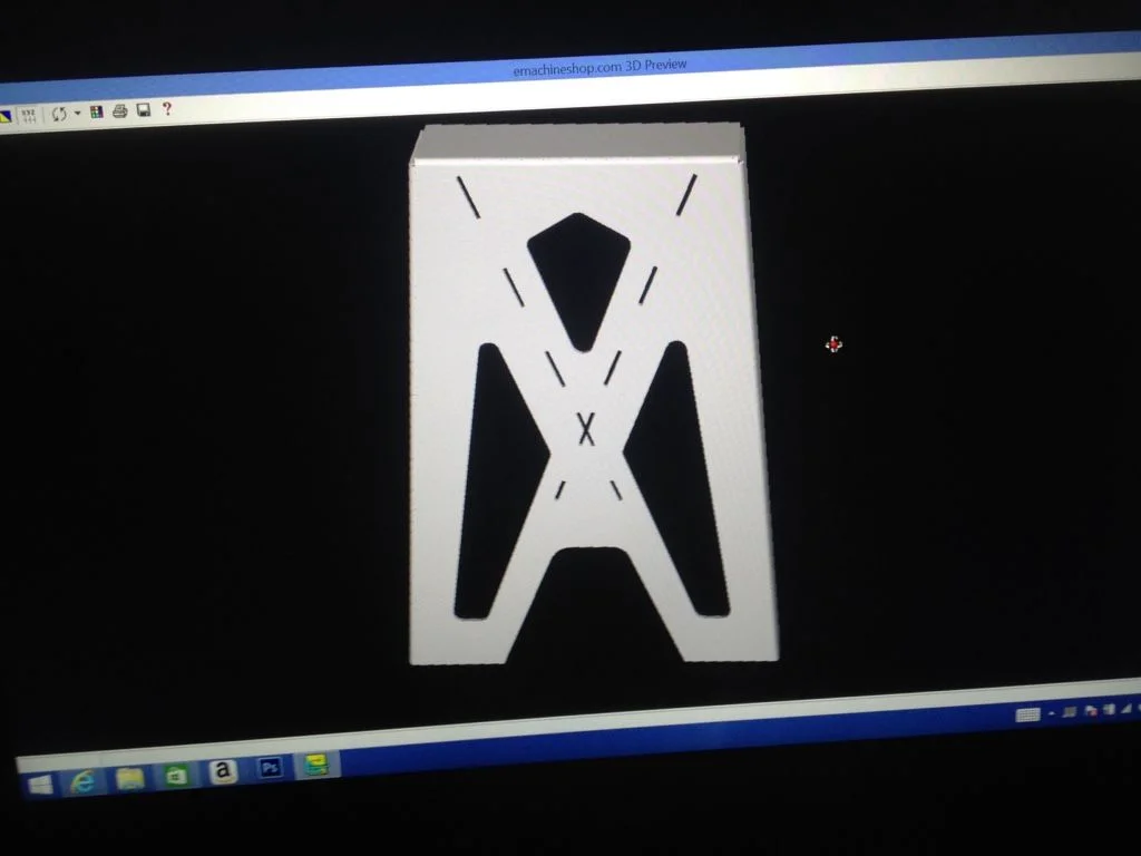

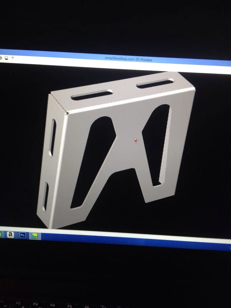

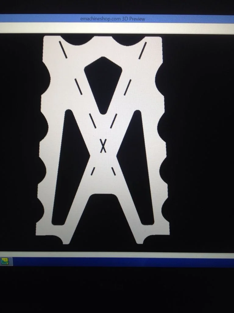

Tell me about it! I spent all day on cad for the first time, starting to get the hang of it but I am not much of a computer person.
Here is a rough sketch and some of the cad work I did today on the swingouts.
