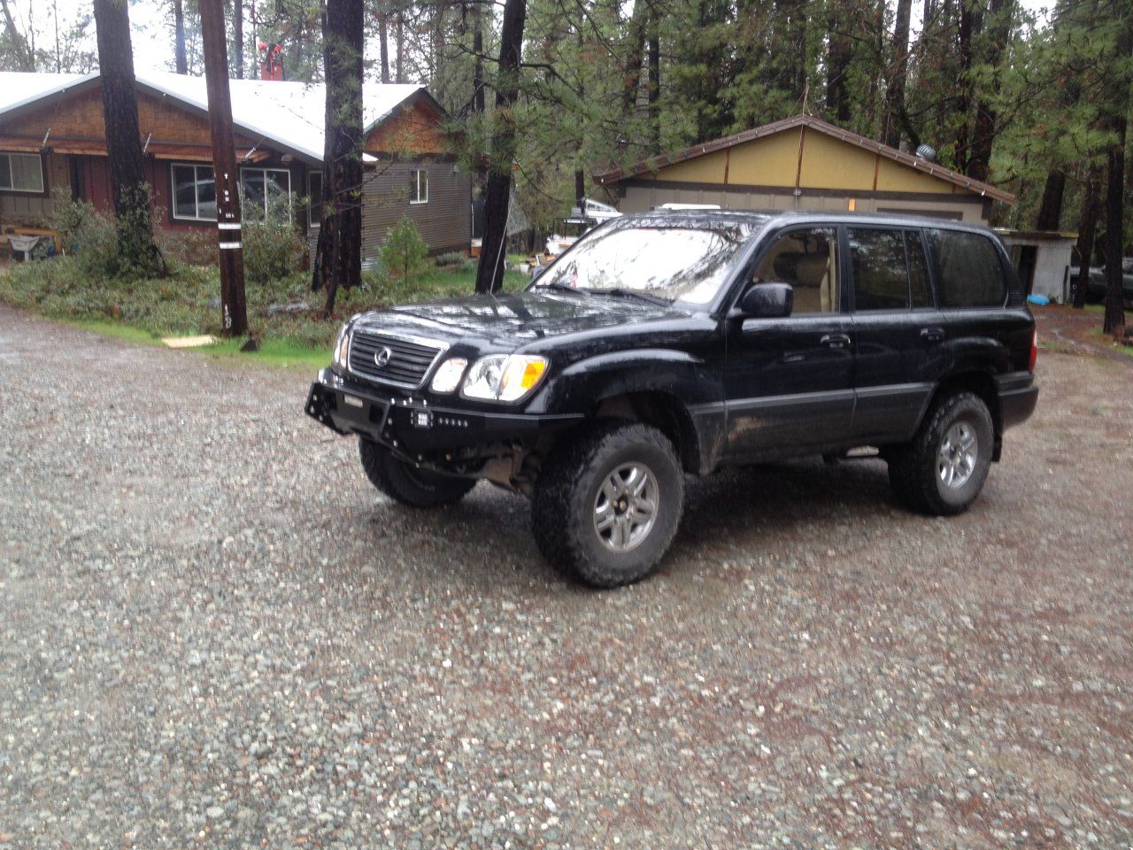

Got another lx outfitted with the front bumper.

Came back from oversea trip, and suffered from jet lag, and BANG!! Couldn't gauge the side spacing and bumped into the side of garage. Hard hit about 2 inches in and the car shook. I didn't notice any visible bending of structure. Maybe a little inward 1/32 of an inch, if that; but happy to see nothing major happened to the modular system.
