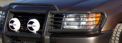

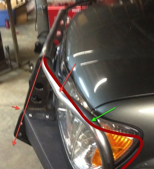

This is a bit of what I was brainstorming. I know when building multiple pieces the easiest and quickest way to get it done is the more realistic and of course profitable one! The drawback is sometimes a product that can become a bit blend.
Please don't take any of this to heart, I don't want to come here and just piss you off. I like your bumper but if I can somehow persuade you to build it in a certain way sure I'll try, ha ha! I know I can sound very picky and type a, thanks to the restoration shops I've worked at.
Like I mentioned before I was sold on the way the first version looked. In particular how the risers where done on that one!
I know to accommodate the with/without guard something had to be done different.
The two risers shooting sideways I'm not a fan. No idea how you may put the kits together but would like to have those going straight up like before. I get you are trying to give folks the option for the longer light on the top tube. The elevated top tube looks cool!
That gets me to the next thing.
What I was thinking is make the D-ring point at an angle where it would have a smooth transition up to the risers. What this means : I can see in these pics how the d ring point goes up and before reaching the edge of bumper top it has a curve to finish it off. Nothing wrong there if you don't have the risers, but (IMO) after they are bolted on, it looks kind of out of place since they have different angles and are not really working together. It would look very good being a seamlessly transition and giving the impression like it was one piece going all the way up. You can see that better from the sides.
The blend look I said before is more about the tube sides. I thought maybe trying to mimic what you see on the grill guards out there today going around the lights and using the body contours more instead of just a big wide curve and down. Could look pretty slick. Look at the 3rd pic, but instead of going back to the riser you bend it down to the main piece. I played with some other pics I'll post, it may illustrate it better than words!
Thanks again for taking the time to listen to our opinions on the build.

The riser issue will be addressed and it should not be a problem to put the risers straight. If I remember right, you are getting the DIY kit? If so you should be able to place them as you want. As for the bends, if I had a $30,000 cnc bender I would be bending as you described. Unfortunately I do not and is not possible to get that tight of bends. One of the great things about this bumper is the removable grill guard. If someone likes the bumper but not my grill guard they could buy the bumper with the brackets and have it built locally.
