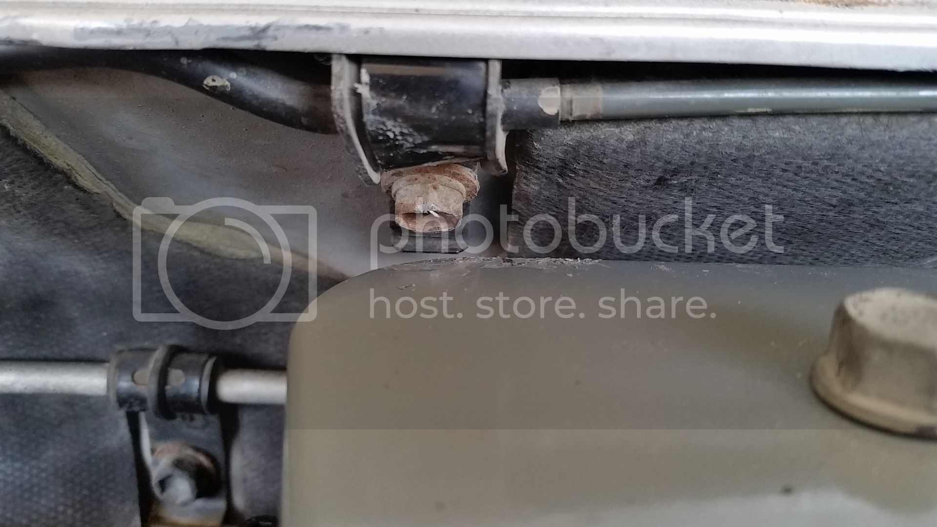

This bolt lines up in the same spot on all valve cans in a line. I used this to make sure my engine was straight.
That bolt is a handy dead reckoning tool. My motor looks very straight, but I will check that bolt.
