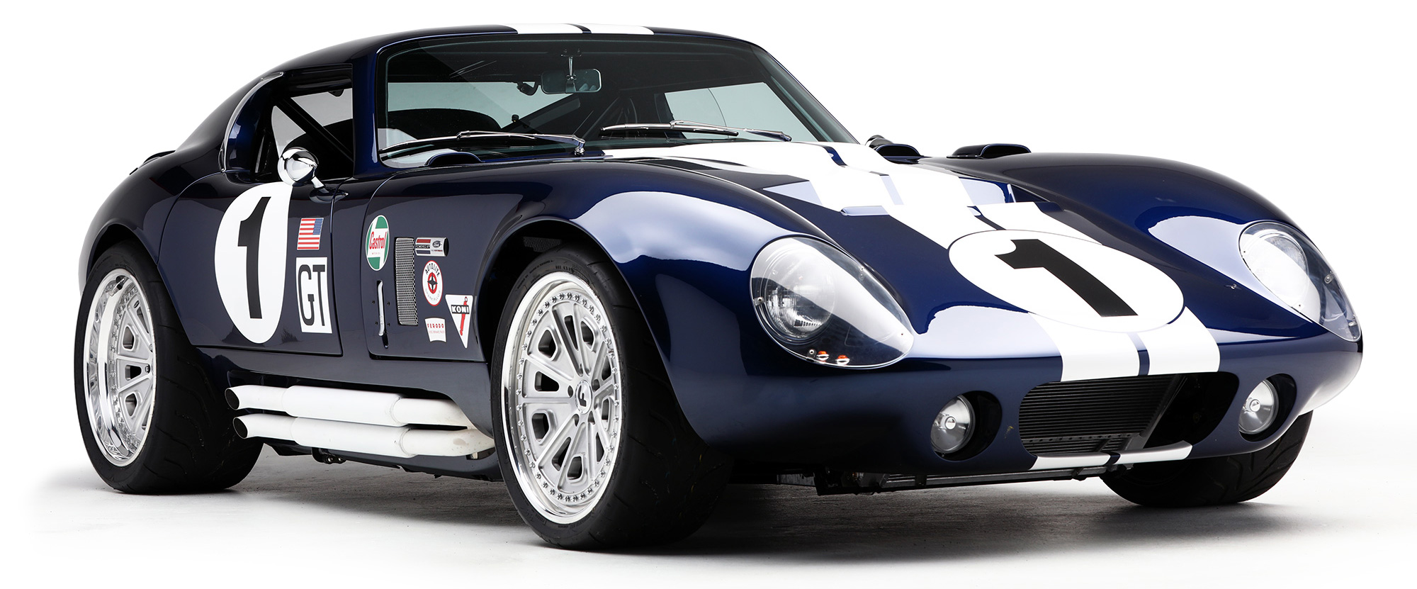

My first dream car and always will be is an original 64/65 Shelby Daytona Coupe. Unless I will a Powerball that will be WAY out of my price range, last one sold for over 7mill.

I understand, and I also don't have 7 mil. The replica Cobra market in general is huge. There were so many replica Cobras at Barrett Jackson you would think there was a machine in the back shizing them out. Most are very well engineered.
Biggest problem with most cobra replicas is the Speedo is sweeping the wrong way. And most gauges are just the wrong gauges period.
