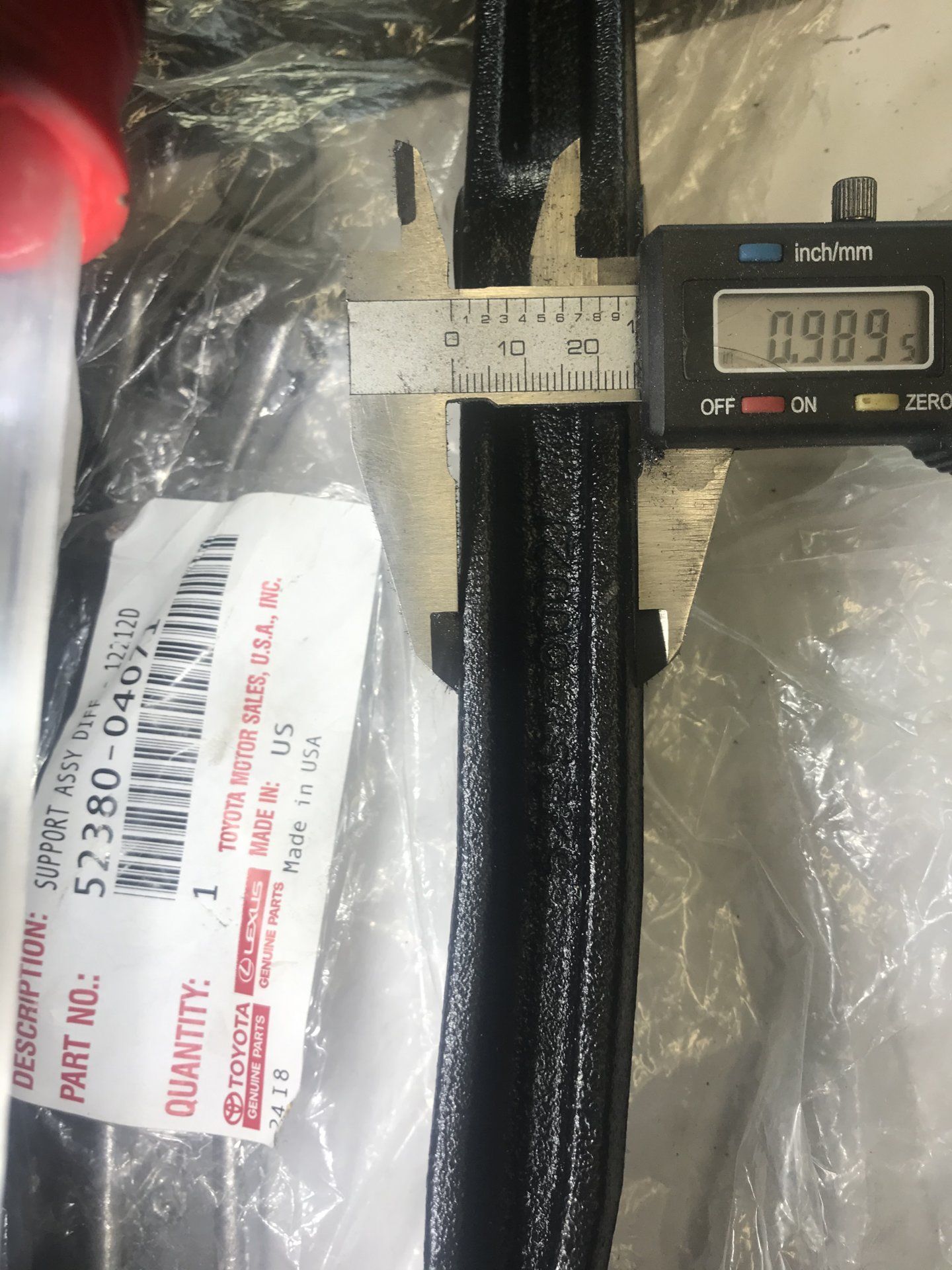

I ordered the new part number (or so I thought) and received the identical part as the one on my car. At least it looks identical, same thickness, so I didn’t take it off - because from the pictures here the new upgraded part looks thicker. I bought 52380-04071 and they sent 52380-04071 but it looks identical to my old part and the part number stamped on the side is the same as the old part number 60021. Did I buy the wrong part? Here’s what I ordered.
In the link above, they said the 04 V8 has the beefier one already - so I guess I have a spare too.
Can anyone measure the thickness of the new one so I can confirm this?
Correction:
Part ordered, 52380-04071 supersedes 52380-60021
Part number stamped on part: 52391-60021 and is 1.148” thick at the widest point and 0.994” just behind the stamped part number. Approximately 0.872 measured metal to metal where the rubber bushing fits. It also has the 6 stamped on it. I know my old one had the 60021 stamped on it, and when I held the new one up to it the thicknesses looked the same but I didn’t remove it to compare.
Can someone measure the old weaker one?
Below is a picture with measurements of the new one.
