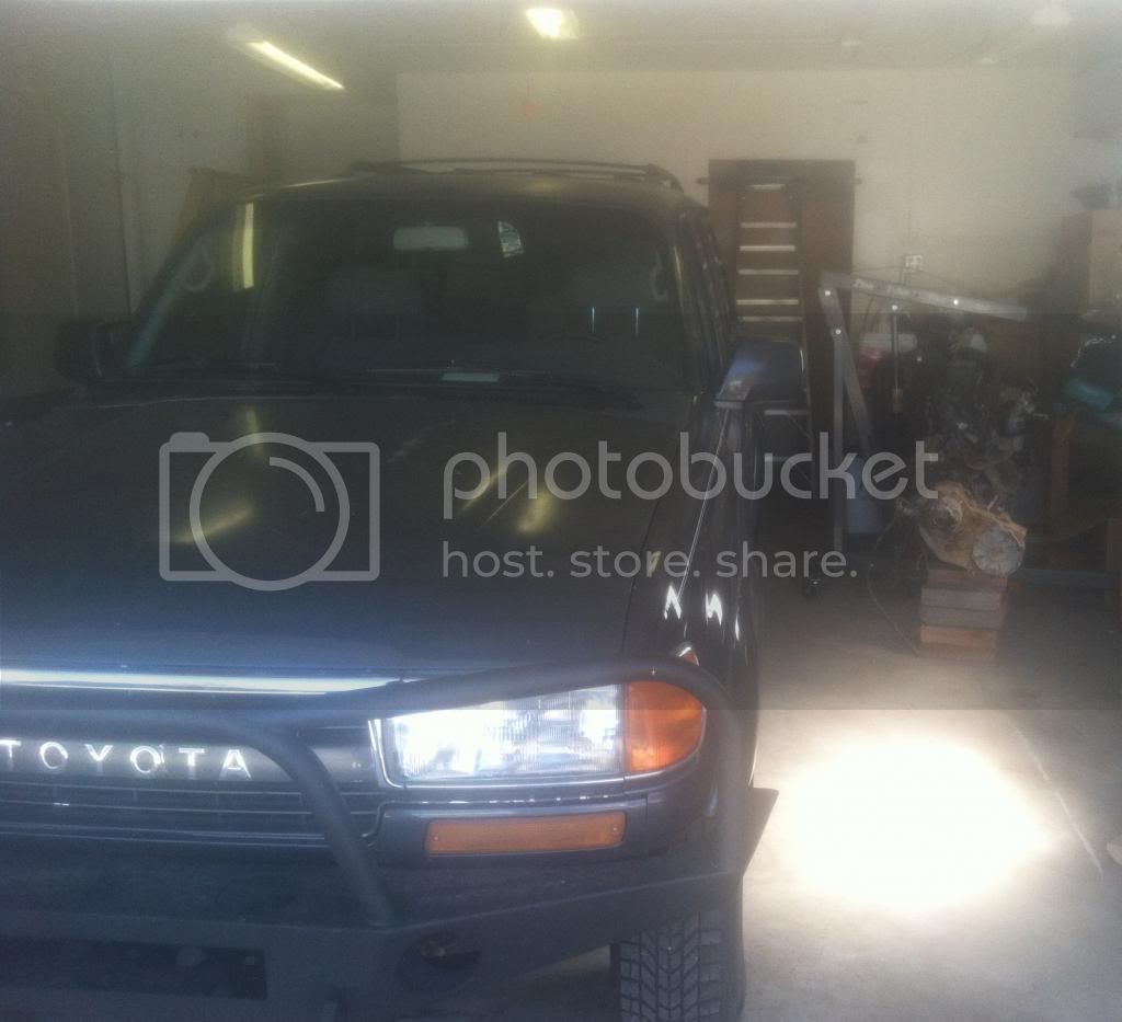

cummins 6bt
Does anyone know of a supply source for a trans adapter to mate my cummins 6bt to the stock Trans of 94 FJ80.
