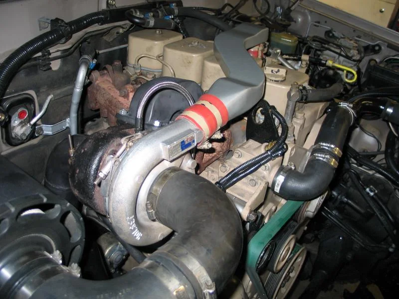

1. 1994 fzj80 cloth interior, purchased with a bad tranny, 6800 lbs loaded for a weekend trip w/3 kids 5300 lbs unladen w/ no passengers.
2. 4BT 105hp, rebuilt injectors, fuel pump and playing with turbo's (currently a H1C no-intercooler), AA Chevy to NV4500 (early with low 1st), AA to Fj62 splitcase, custom drivelines power close but sligtly below a 1fz-comparable to a 2f. 12+ psi boost w/ temps below 1100 unless I push it/lug it too much. 1/4 turn on the fuel screw.
3. Everything in this swap was tricky and time consuming as I went with a manual tranny and was trying to maintain a stock suspension height so as to not limit travel even with a lift. I gutted all the extra wiring which meant stripping the interior and dash. I started this in November of 2011.
4. There were too many things I needed to buy that I didn't consider or ideas that didn't work out and a lack of support from adapter vendors- Orangefj45 made up for that- thanks George.. I spent more money than I expected of course and still have more to spend I'm sure.
5. OME J lift, 2" bump stops, brake extensions, electric vacuum pump, no AC yet. 17's with 33's- and now Cooper ST Maxx 315x75x16's- seem to rob a little power on the highway but smooth and quiet and the 4.10's seem just fine.
6. Loud and rattley at idle and lower RPMS, I'm over it though after learning the different driving characteristics and dig the torque of the diesel. I put in a lot of sound deadening and it paid off. Is the 4BT an ideal motor for this swap? No, but I am excited about getting the bugs worked out and getting this thing on the trail/road..
7.MPG's 120+ miles combined trail and highway, 40-45 miles is 1st,2nd low and high gear the rest 50 to 65, 17mpg, normal with 1fz would be about 8 to 10. Last tank to the beach and back I netted 24.8 mpg
8. 5 stars for difficulty
9. pics, sure-
10. No official build thread..

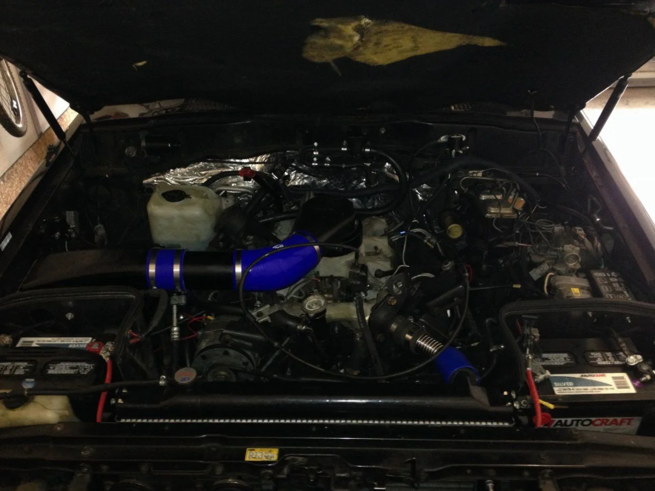

1. 97 LX450
2. 1HZ + safari turbo, R151, part time split case
3. Engine bolted in and fits perfect, the smaller R151 trans allowed for a flat belly
4. Not a difficult swap...just takes time and patients
5. Dual batteries, sleeping platform/drawers, Webasto
6. Slow to accelerate but maintains speed well on hills. I'm happy with it. If you're used to driving a 22re, it's fast.
7. 15 mpg on highway at 70-75 mph, 19 mpg on back roads. This is loaded up with gear for a 3 week trip. I only have 255/85r16 (cooper st) with the stock 4.10 so it revs to high at high way speed.
8. *** The hardest part of the swap is gathering up all the parts. Once I had everything, the swap was strait forward.
10. Build thread:
https://forum.ih8mud.com/threads/lx450-1hz-turbo-diesel-5speed-swap.793226/
