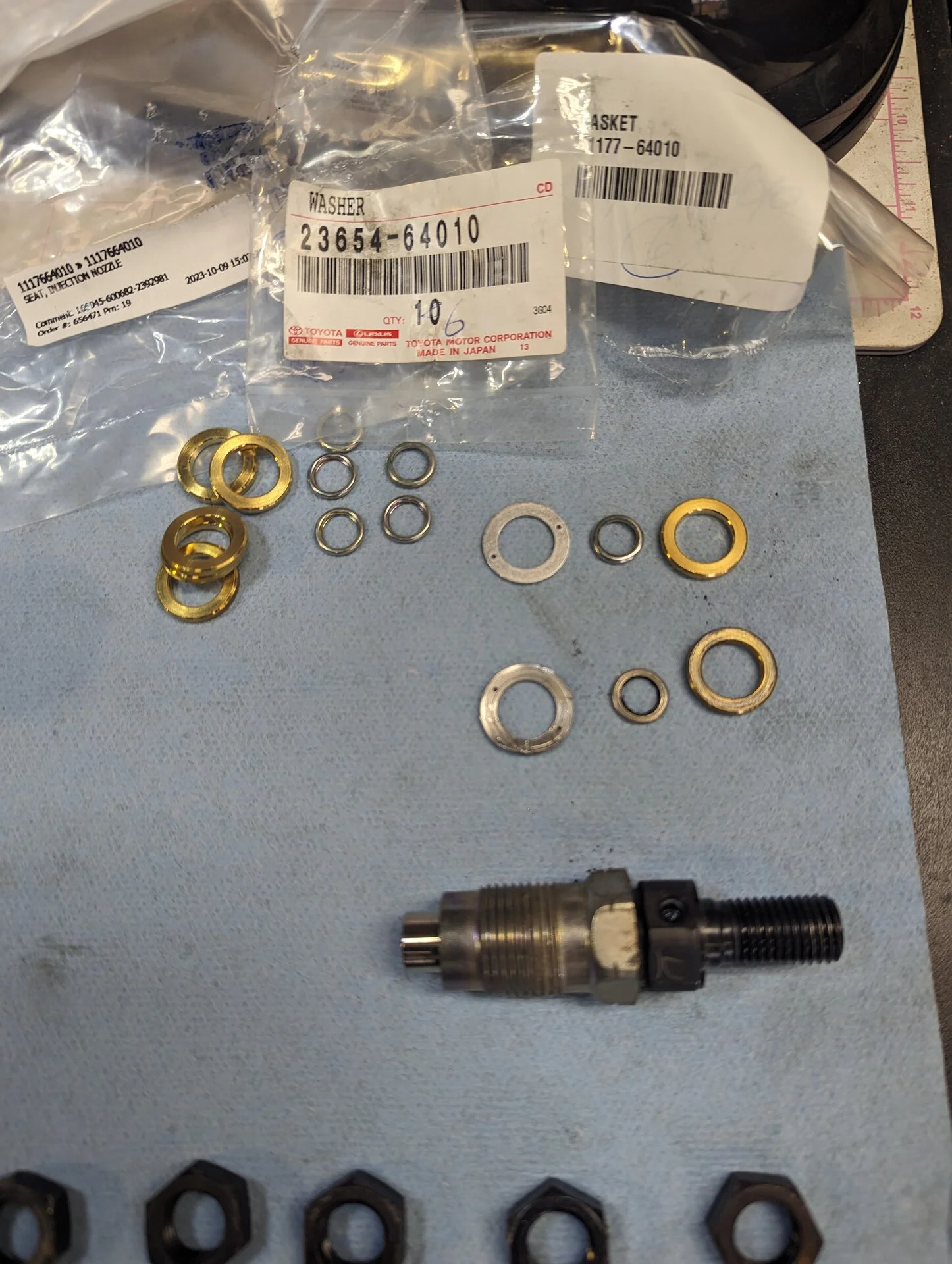

I was listening to it again with the radio off the other day on the way to work when I started thinking back to when I replaced the injectors. I got new seal gaskets with the new injectors, but I don't recall any brass seats. I looked back through pics and no sign of them. And I don't ever remember seeing the seats when I pulled out the old ones... the noise was there before and after the new injectors.

I have to thank @OGBeno for the knowledge I have on this. My 14B is set up with steel seats, then a rubber seat washer for the injectors. They were about .90 cents at the Toyota dealer. They looked like flat washers. This was all new to me but it made a big difference
The direct injection injectors are different from the IDI. My 15B-T has flat brass (I think) seats and rubber dust seals on the body. The IDI injectors on my 3B have crush washers on the seat (which indeed will tend to stay in the head when removed). They also have a re-useable seat. If either of these were missing you would most likely get diesel creeping up the threads of the injectors. Not a bad idea to pull them all and replace the crush washers, they are very cheap.

I did all the injector seats, seals and fuel rail washer thingies on the weekend, and yes, the old ones were all there. My newish (25k kms) injectors had a little carbon on the tips but were generally fine. The old seats looked okay, the seals had some carbon. Seat of the pants drive seems a little snappier (for a 1hz) but probably placebo effect? 😉
I also tightened up a rattly exhaust mount. No real change in the rattle, but at least those things are done.
