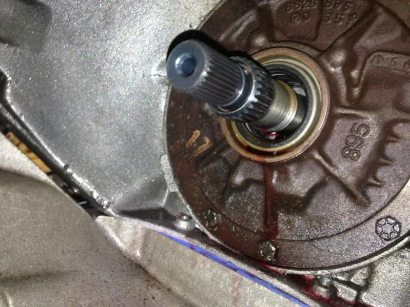

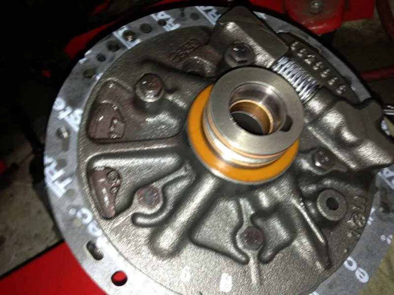

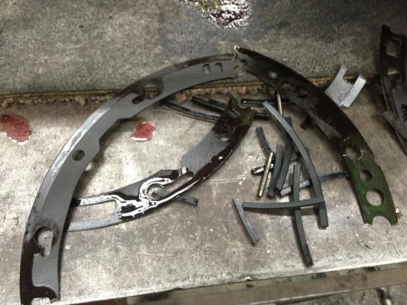

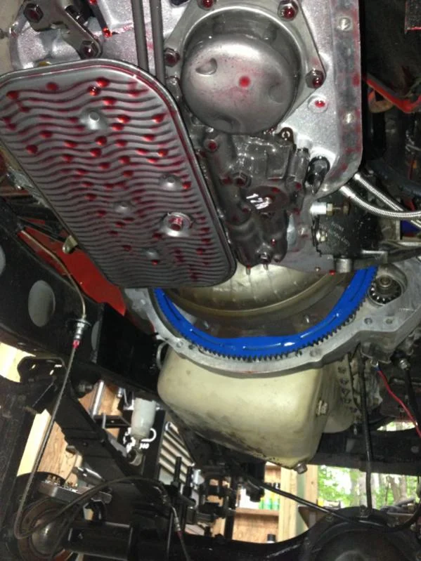

Had to drop the transmission to replace front seals, it was leaking like a sieve. As you can see the front seals (front main, and pump seal) were rotten and fell apart.

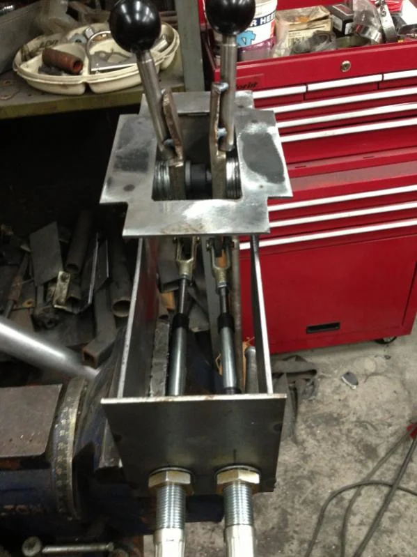

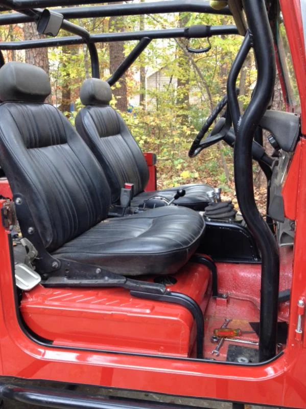

With the auto trans in the truck now I'm running an art-Carr shifter. I'm going to build a center console that's integrated into the roll cage. I needed to make some changes to my original dana300 twin stick setup so I decided to build a cable shifter setup. It's based off the northwest fab kit, but I couldn't justify paying for it since I had shifters, boot, shifter rail tabs, etc.

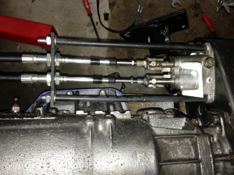

so I ordered some 48" push pull cables from Midwest Controls with the correct ends and then started to build the shifter box for the console. I'm reluctant to share the photos because it looks ugly right now, it's designed to be 90% hidden within the console I'm building next.

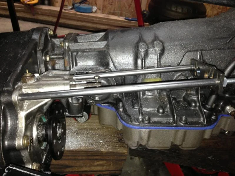

I haven't designed the cable mounts for the tcase yet working on it now.
Keep it up man! Good work on the transmission. I guess those seals are always to be replaced if the transmission is on the ground.

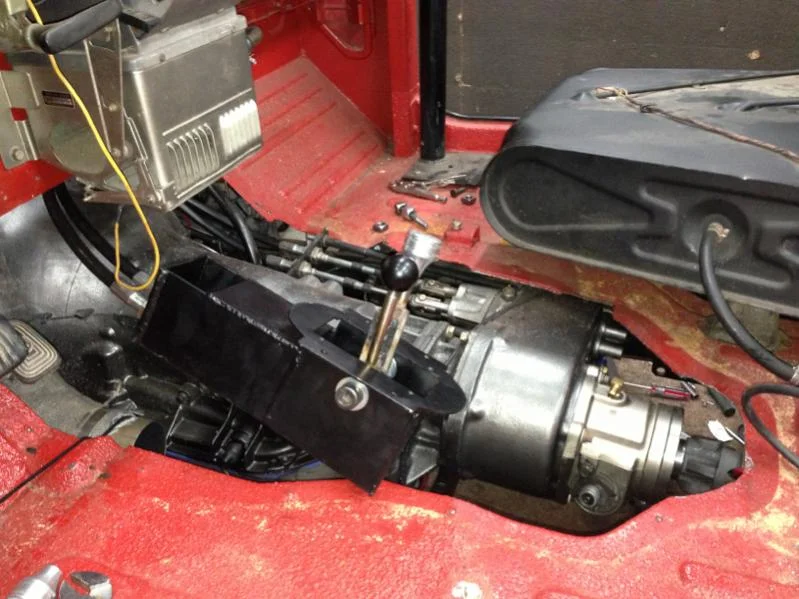

I had to change the layout of my planned cable shifters. I was planning to build a reverse style but quickly determined I didn't have the room for them, I'd have to cut into the gas tank. So I built them in the standard location. Got the trans mounted back in too..
