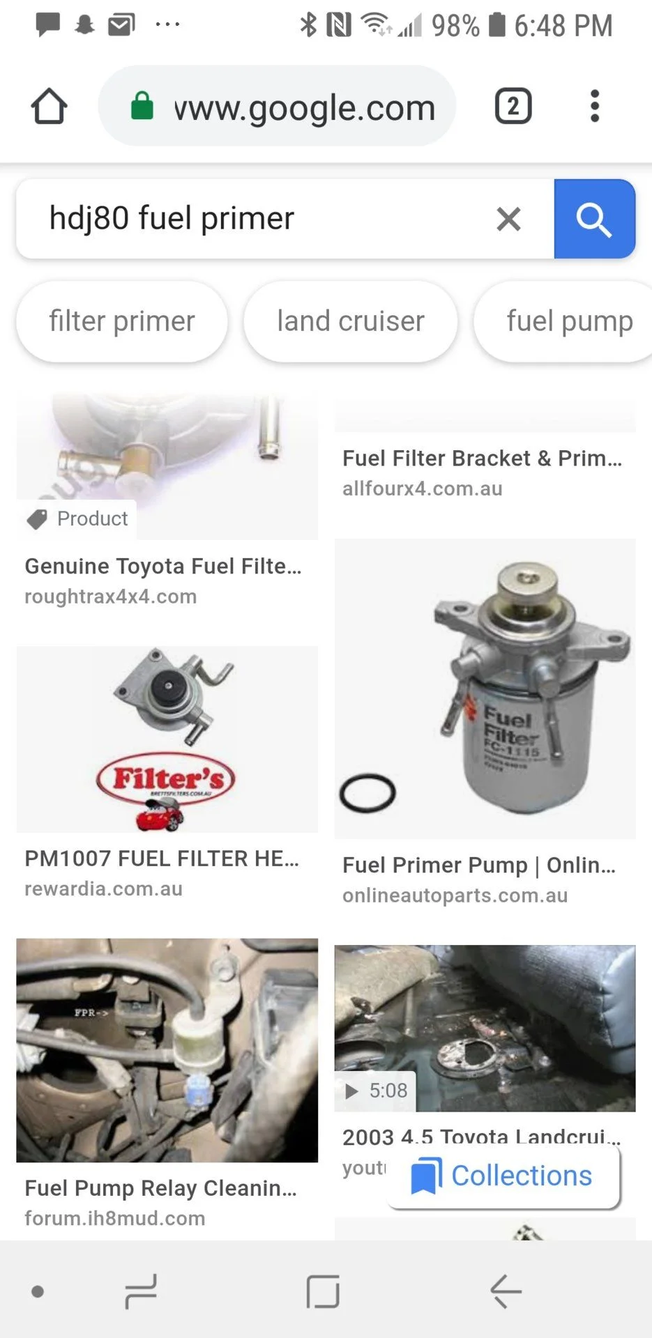

You have a manual primer.
See pics
See pic of fuel solenoid #22390A
