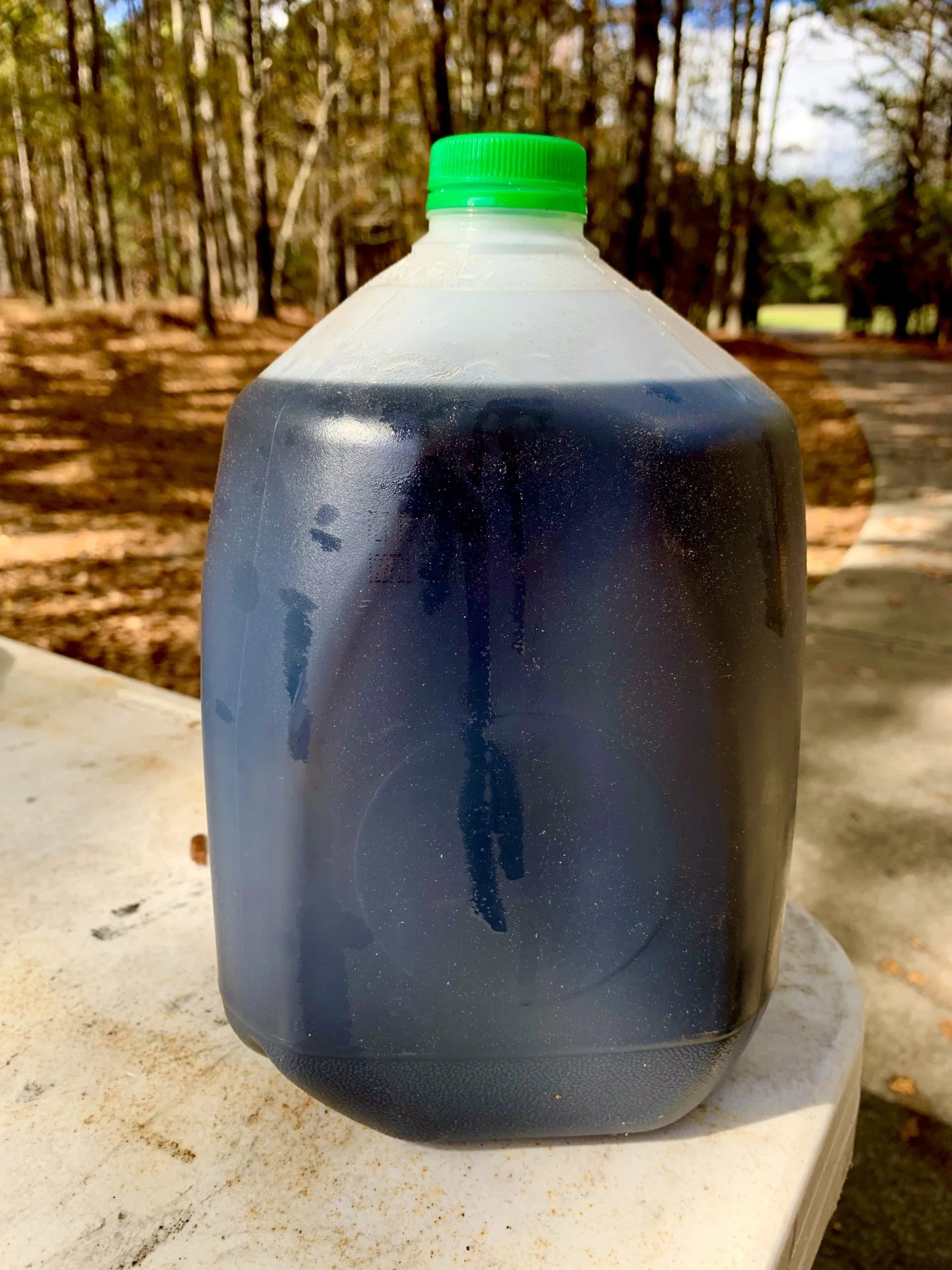

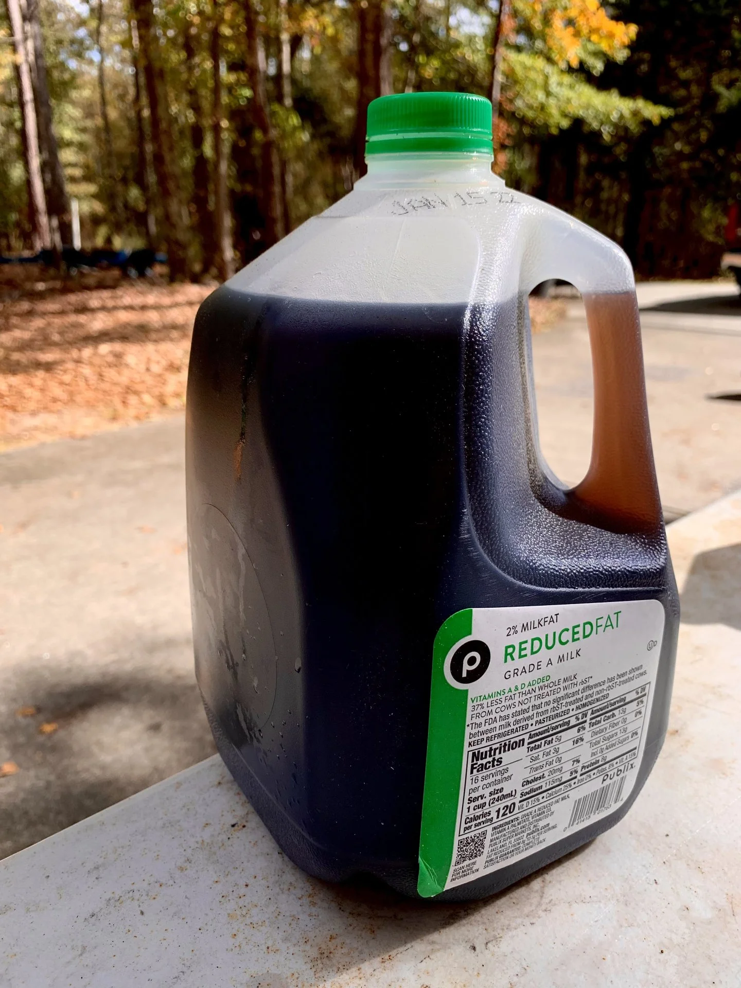

I will do a write up later. This is what I got out of my 2013 LX570 with 125k miles.

I was fairly pleased with the much better color/clarity of the fluid coming out by now. It wasn't pure clear pink new fluid, but it was much, much better. I had the wife crank the vehicle again and run through the motions of N, then H, then drop it to L, raise to H, drop to L, raise to H, then back to N, L, then H for a final check of the fluid level. I set the fluid level to just above MAX when it was in High and I feel good about everything.

A little different than the process I did, but great to see you got it done. Your old fluid in the photo doesnt look terrible. How's it feel now that you've had some drive time?
Thank you. I felt it was pretty nasty looking, especially compared to new fluid.
I felt like the ride was better. Not anything to write a newspaper headline about, but better. We took it out to eat about an hour later (after a hand cleaner bath/shower and a cooling off period) and then to the grocery store. Maybe it was my wishful thinking, but, again, I do feel it was riding better.

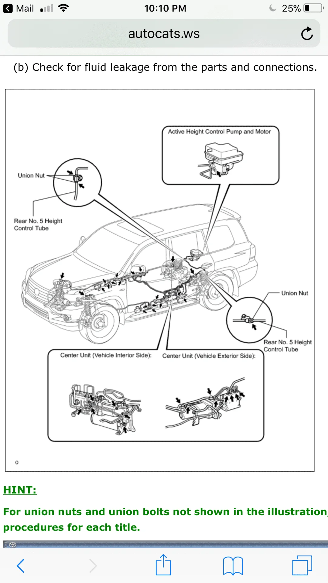

Can you provide a clear diagram/picture of where the accumulator is and what/when to bleed it?
Thanks.
Thanks.
It’s never mentioned in the manual for the bleeding process, I assume since there’s never really a time when it should get air in it. It’s located along the same frame rail as the leveling valve but closer to the driver seat. There is a panel over it that needs to removed to gain access. It does have a bleeder valve. There’s a few ways to approach it.
I just noticed your step 5 you start the truck and let it get from L to N before you bleed, but after swapping the reservoir. There is a good chance that action evacuated the accumulator into the system and then filled the accumulator with fresh fluid. If I was doing it again with that in mind, I’d do a full L to H. That would almost guarantee the accumulator evacuating, plus pushing more fresh fluid into the leveling valve, that way the accumulator would be filled with fresh fluid for sure.
When doing any height mode change to a higher position, the truck uses the accumulator to lift as much as possible along with the pump, then the pump finishes lifting to satisfy height sensors, then shuts the leveling valves and refills the accumulator as the last step. You could probably also use techstream to manually evacuate the accumulator, if you wanted to be sure it happened.
