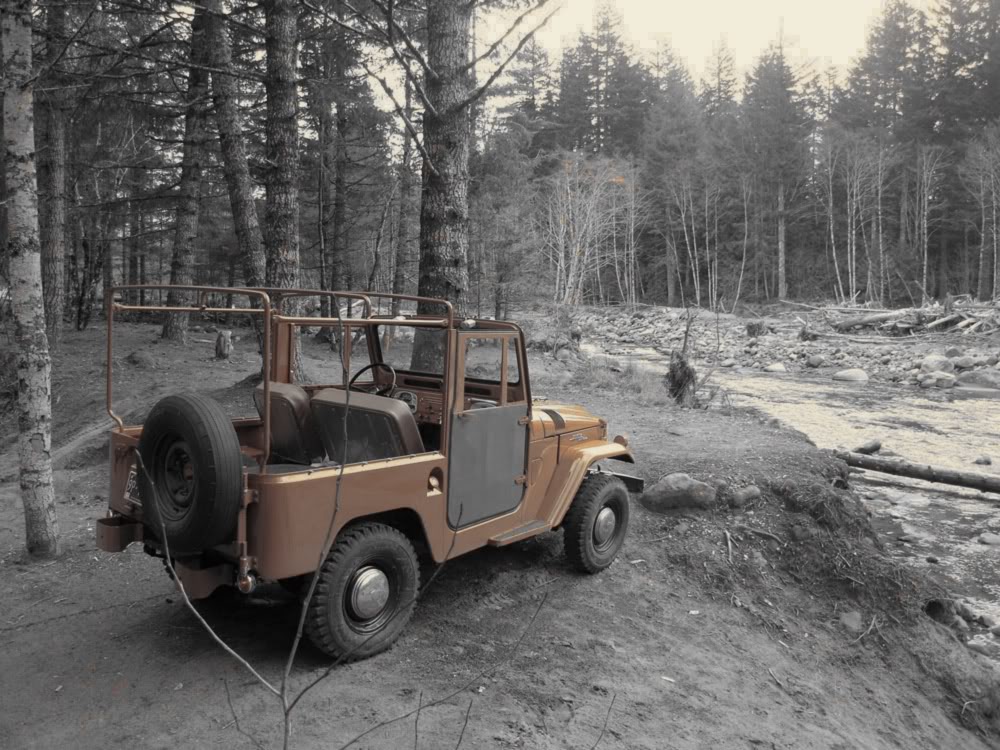

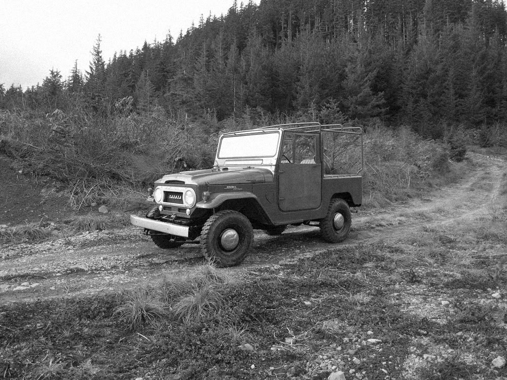

I use two programs to edit photos.
1. Here is one of Destin's photos, photo aged to 1964:
2. Here is another aged as a newspaper clipping from 1964:
just having fun,
dallas
What programs do you use?
