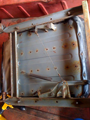

found the underside of the seat in case any one needs to reassemble after they redo theirs :)
( this was before i took em apart to repaint, driver side )
