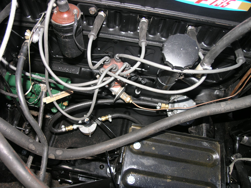

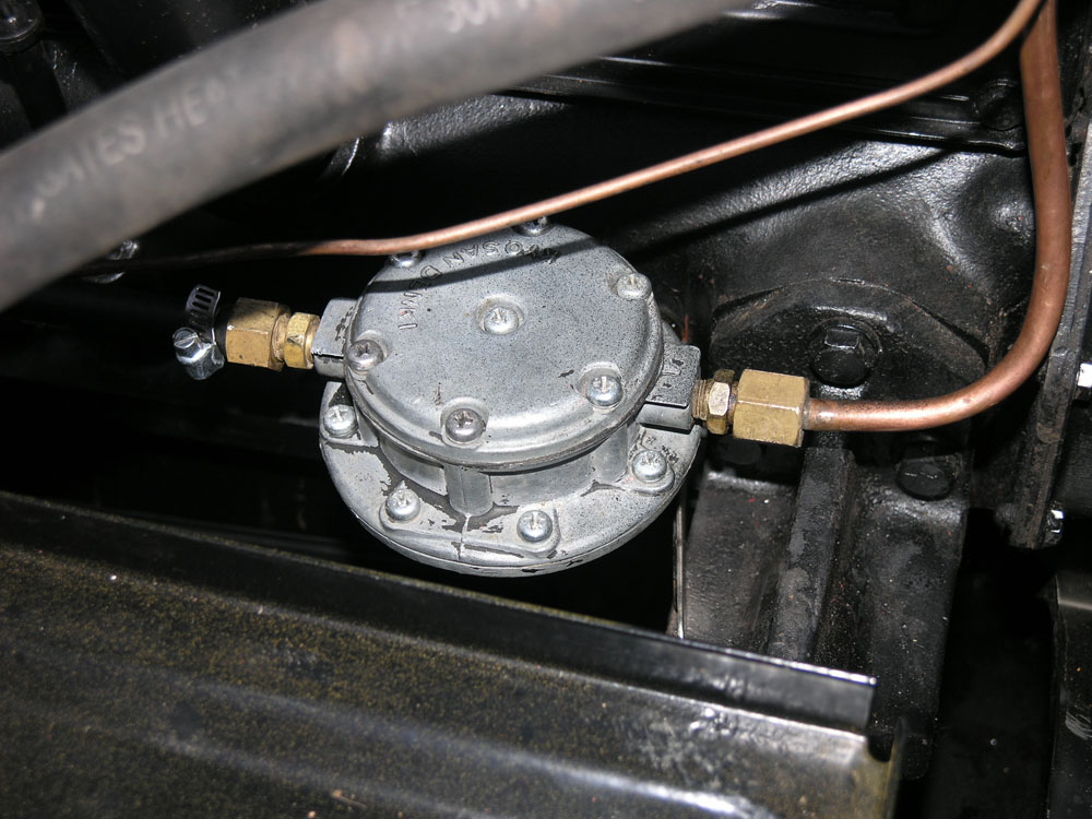

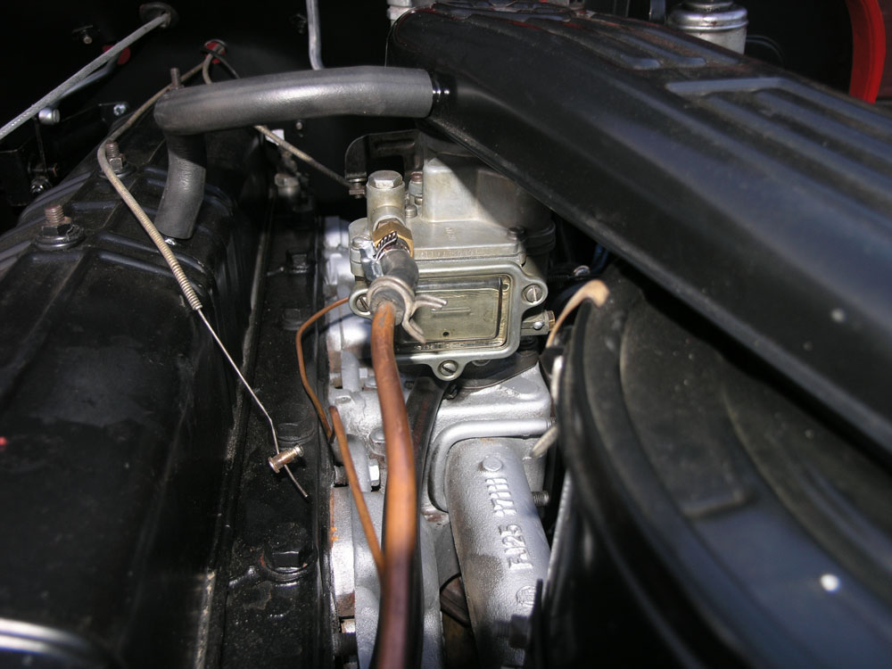

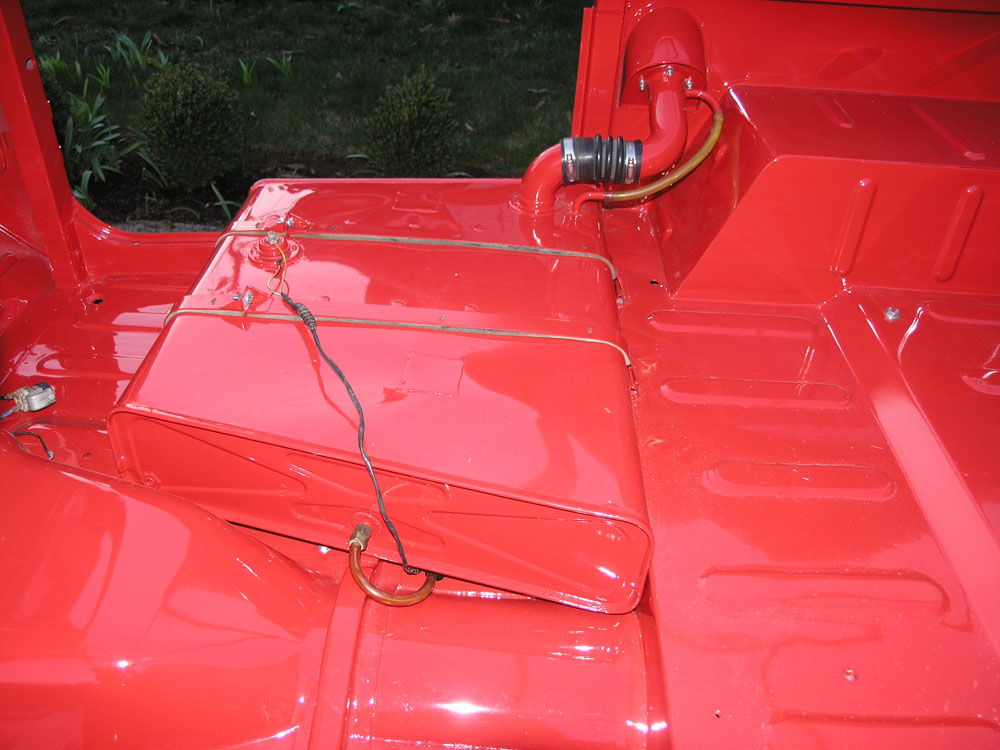

here are some photos:
tank:
filter:
pump:
carb ( no gas anywhere :( )

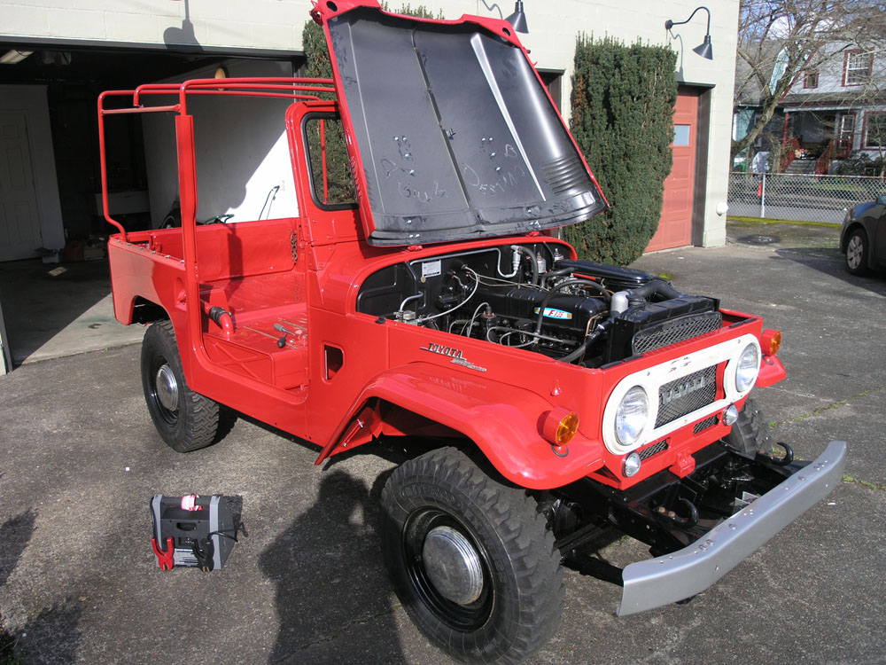

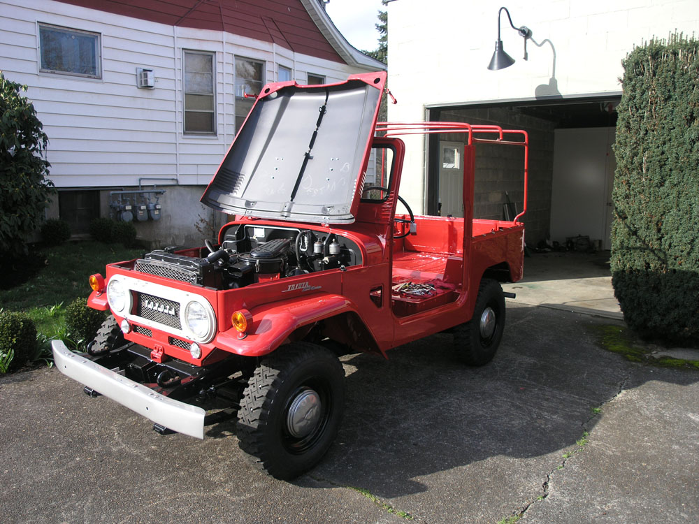

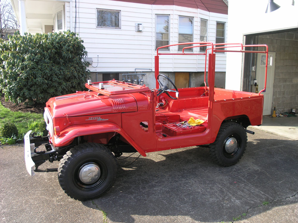

and some photos of the beast for my own mental well being :D
the wifey drew s*** in the under hood dust :D

More gas in the tank baby. Like 5 or 10 more. Gas should just flow out of line by fuel pump. You might want to leave the gas cap off til it flows too. For that matter you can apply a vacuum to the line to pull the fuel through the filter and get the siphon thing going. You could use your mouth but using a suction gun (at most part stores, used to fill rear ends and transfercases) will taste better. I wonder if you could apply pressure to the fill opening? Well you could but who would want to? Besides the neighbors might think you were a bit odd.

is the fuel filters direction of flow correct??:)
yeah, it goes the direction of the arrow on it ( tank to carb :D )
