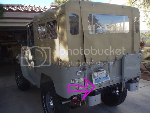

Mine is the same as Bill described.
Apologies for a dirty rig.:p
Tailgate wiring 1963: wire comes up and into tub behind the jamb area of the drivers side rear door. Then it takes a bend in the open around the door frame where a steel clip holds the wire to the door. From there it goes to the center of the door and through the door to the lamp. If you would like a picture I would be pleased to furnish it.
Apologies for a dirty rig.:p[/QUOTE]
Mine is the flip down gate :D
So it is a little dif.
Thanks for posting a pic though :D
I know my 66 is a few years different, Fold Down tailgate wire for the license plate light came directly thru the rear channel directly under the tailgate.
I replaced the sill so I lost the original measurement so like 10 1/2" I centered It on the bracket and installed a grommet and a ground wire to make sure the light stays on.

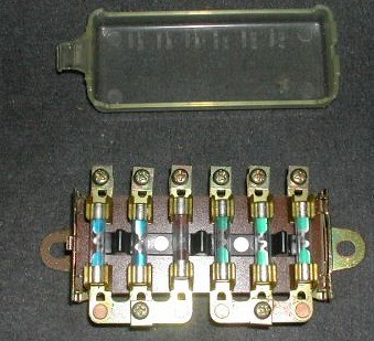

Hey homey. Been following your posts for a while. Looks like your rig is coming together better than mine :mad:.
Saw this post you made regarding the fuse block find. Thought I would say, "on mine" - it has only 5 fuses {2 on the top are connected and are hot all the time}{ 3 on the bottom come on w/ the key and are connected together} That one you found has 3 to 1 connection on it...not a big deal, but just watch which ones are connected to what when you put that cat back together....not that you wont, but thought I would give you a heads up anyway buddy.
Just thought I would mention that since I have been working on my piece since the guy who painted it...did exactly that...painted it..fuses and all....BRILLIANT!!!!! Come to alabama next time you want to spend 3 months fixing everything on your cruiser after you pay someone to paint it!!!!......I digress..... Looks Good Buddy! Keep is coming along.
btw, did you ever locate an extra set of the soft doors?
picked up one of these yesterday :D
look about spot on for stock yeah? ( need to look at mine at the shop, I am missing the cover on my old one regardless :)
