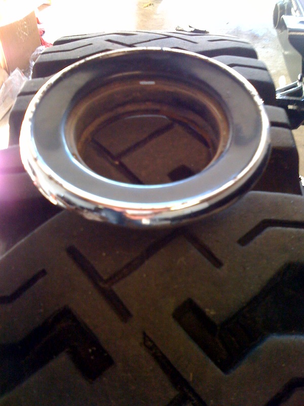

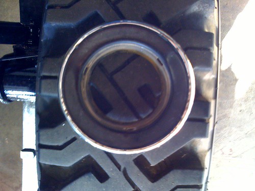

wanted to re-chrome the ring around the steering wheel cap... but it looks like it does not separate... ideas?

It looks like you've got the horn button broken down as far as it goes. Rechrome that piece, then repaint the center with black enamel. The easiest way I found to do that was to lay the enamel on and then take a rag with some acetone hold it steady on the edge and spin the piece. Much easier than attempting to tape it off. The retainer ring is stainless and should only need a polish.

Aaahaa!
Thanks, i knew there was a trick!
Thanks man! :D

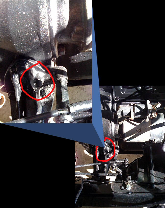

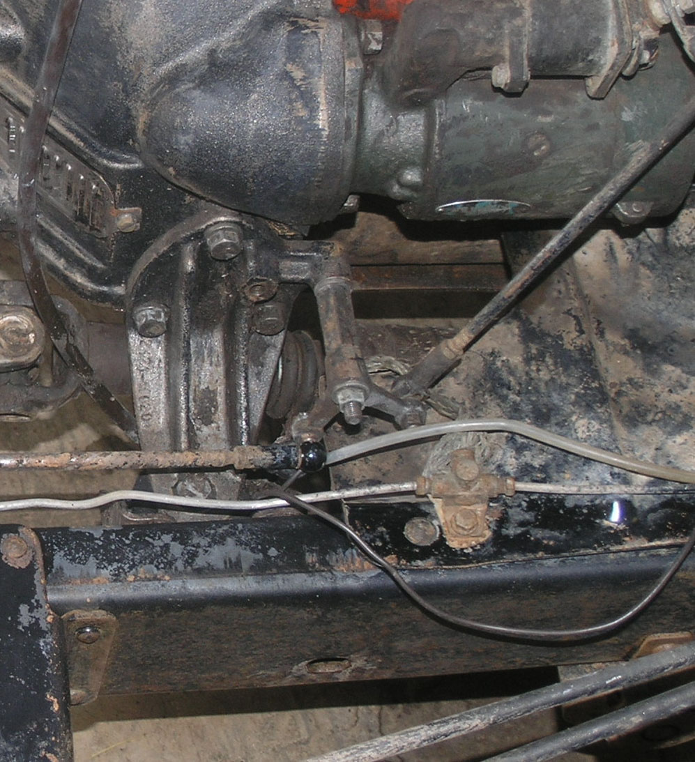

Your trans case linkage.....
What a difference a model year makes. I saw the relatively simple bracket where the vertical and horizontal rods connect. Just bolts to the engine mount. Simple.
Not mine of course. It involves two bolts, a fancy bracket and then the bracket thing to which the rods connect. They saved a bundle when then switched to your type of bracket. I'll get a pic in here soon.
