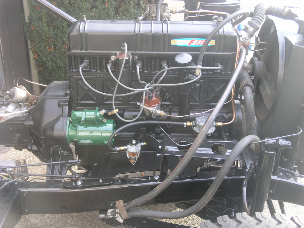

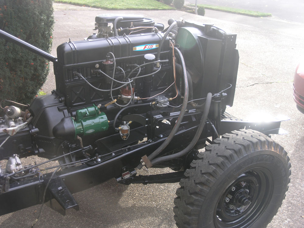

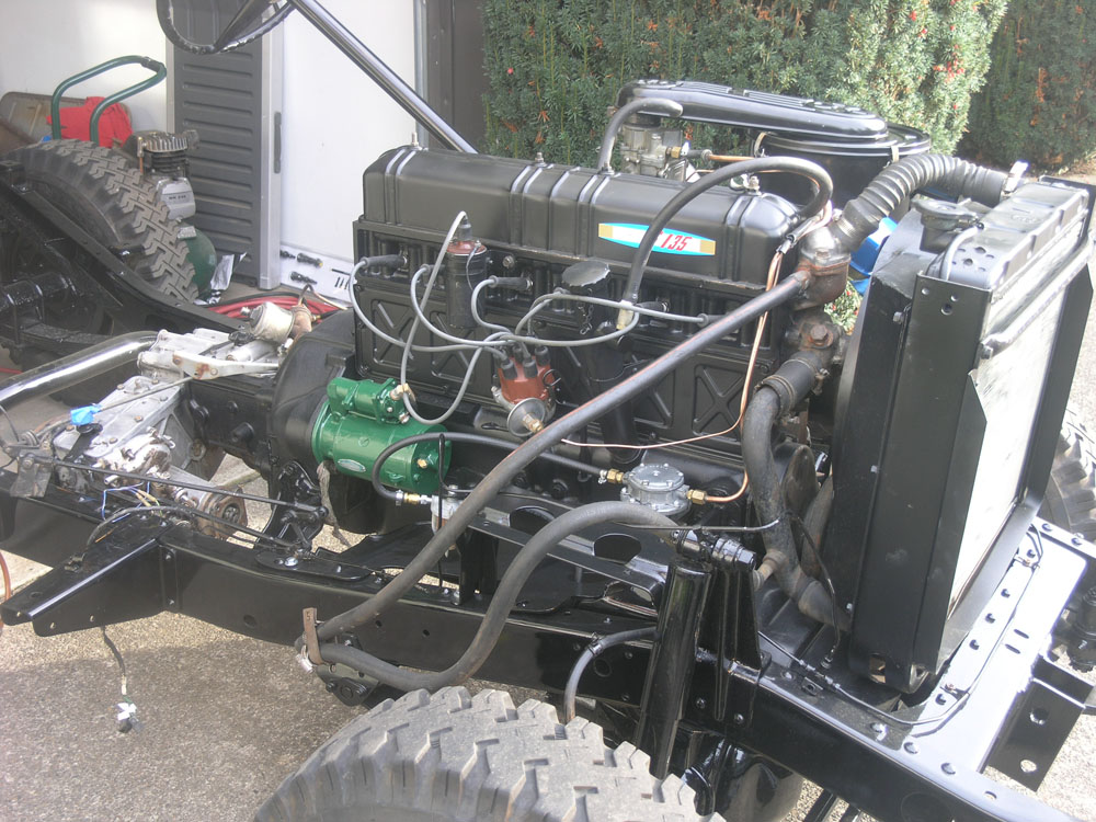

photos of starter :D
Nice pics Destin!
Any news from the body shop?
What about your fan...are you going to swap it for a safer plastic one? Not hard to do once you have all the parts...it's on my list!

Thanks man :)
Still waiting on the body shop :(
Good idea about the fan, i heard a few horror stories about them breaking!
looking good...you need to paint the fan :D
