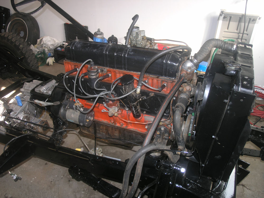

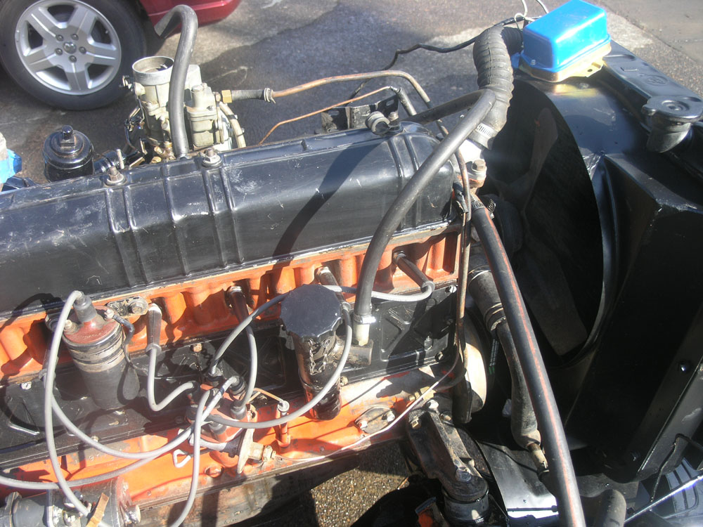

Do you have a photo that shows the bends of your copper fuel line from the pump to the carb?
Curious to see how it is set up, maybe i can get the old copper lines to work !

i will take a few shots of my copper line, and if it does not fit i will order a used one from sor :)
pics coming later this evening :D
