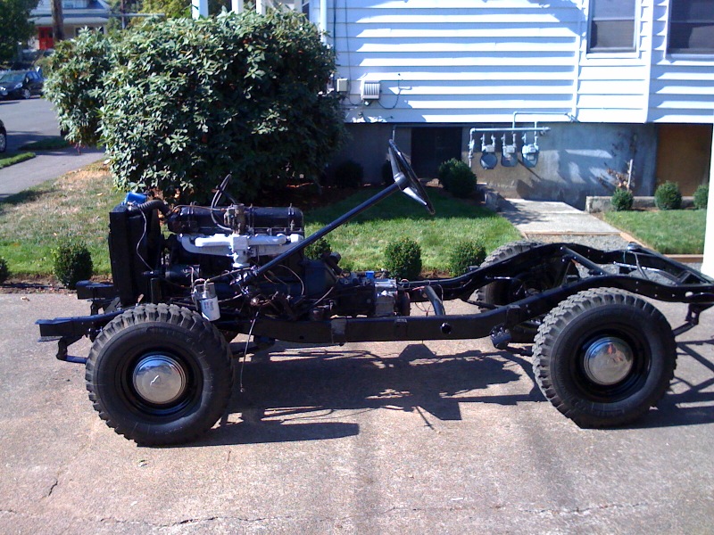

First off, great work, great pictures, great everything so far.
Apart from the admirable goal of keeping your cruiser as stock as possible, is there an advantage/disadvantage to the early canister filters v. the later spin-on filters? Looks like my PO bought a conversion kit and I've got a modern filter now. Does it make any difference other than the "look?"
