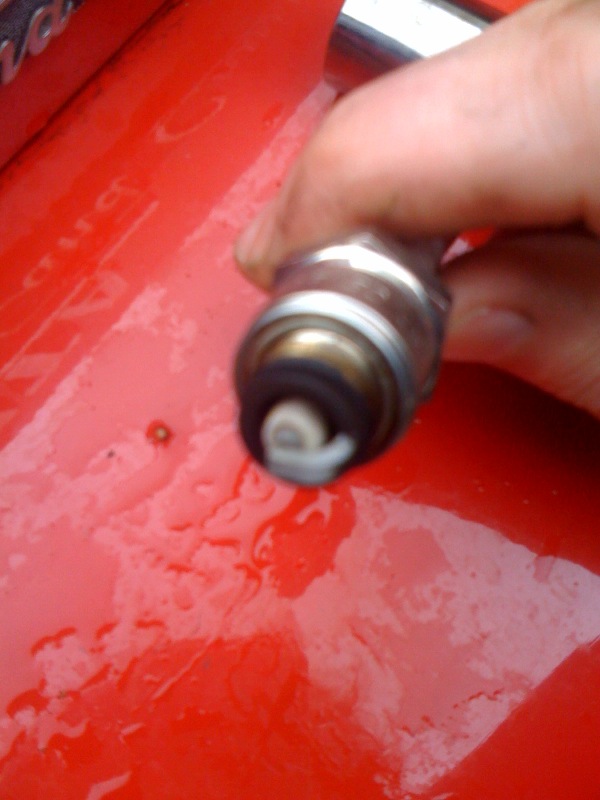

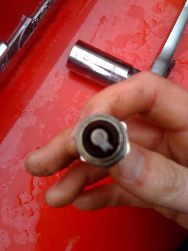

Also, pulled the plugs and this is how they look, look good, or seem lean?

Plug looks good but it's hard to see. Obviously not rich, so you want to keep an eye out for glazing (shiny surfaces) or melting (rounding of the electrodes).

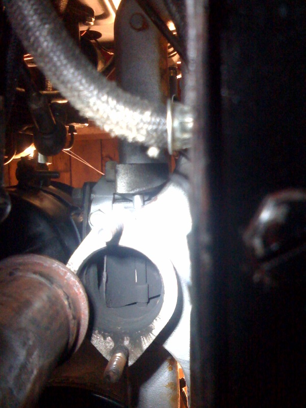

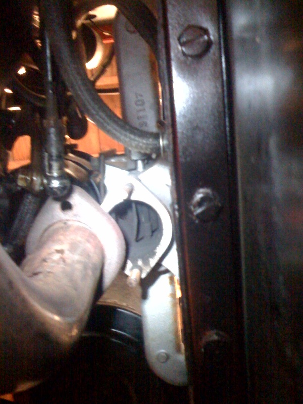

Then i pulled the exhaust off the exhaust manifold, because i had a sneaking suspicion that the engine shop locked it off in the open position, and i was right , take a look:
so I repositioned the heat riser check so i could move it into the closed/ operating temperature position, and this is as far as it would close ( a total bitch to do when assembled ) Is this closed enough to run properly? or do i need to persuade it more?
regardless having it open and blowing heat up into my intake was probably messing up the fuel mixture as well as robbing me of power correct?
Thanks again fellas :)
Yours doesn't look right to me (square peg in round hole kind of thing), but I'm not an expert...
