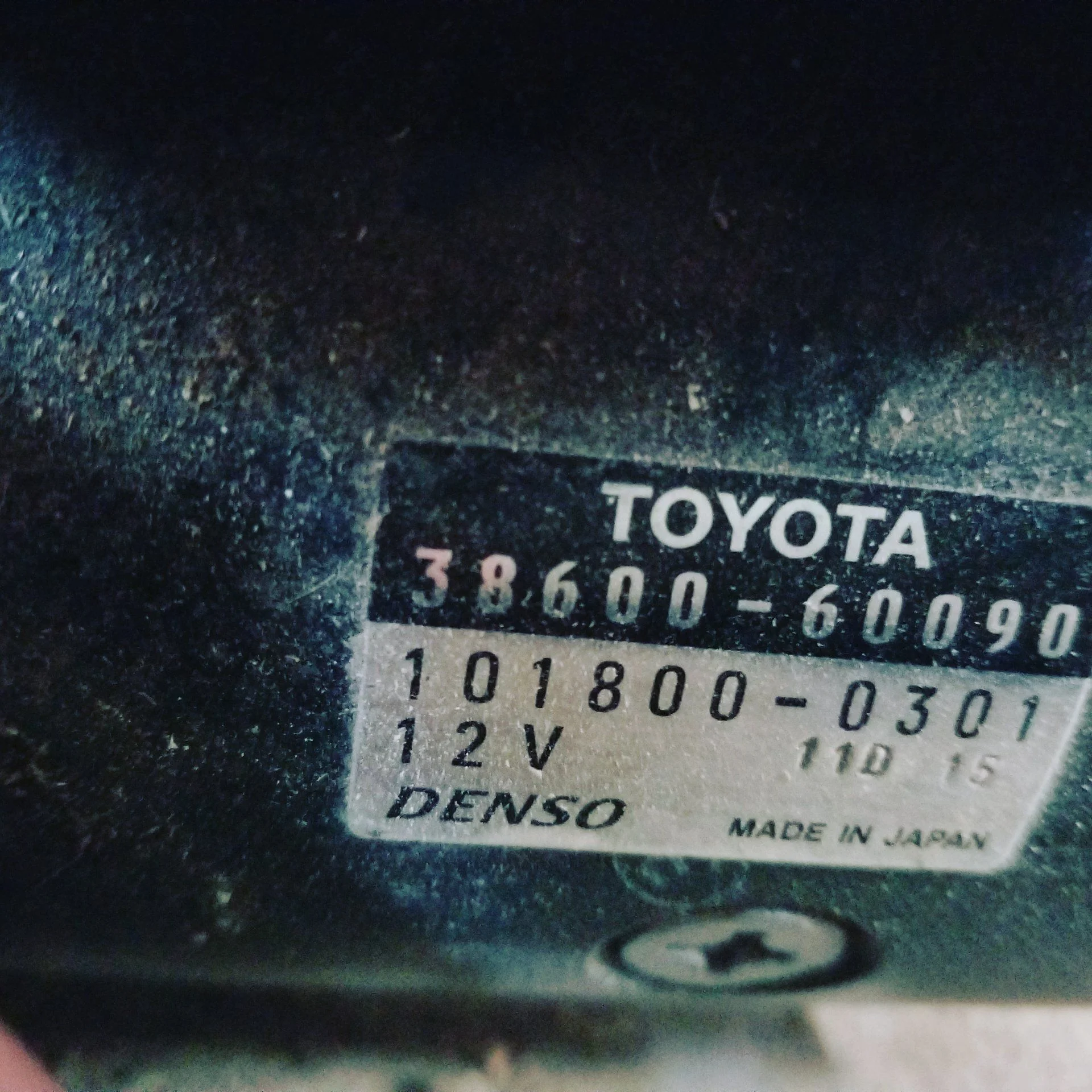

I found one of these winches for sale locally but other than this part number there is not any other info on the winch such as rated lbs
What is this winch rated for? anyone have the specs on it?
when I google the part number I find sites with the replacement motor for sale but they don't give me any specs on it.
@Tapage
I believe that is the part number for the motor, while 38110-60280 is the pn for the actual winch assembly. If so then that winch appears to be rated for 12klbs

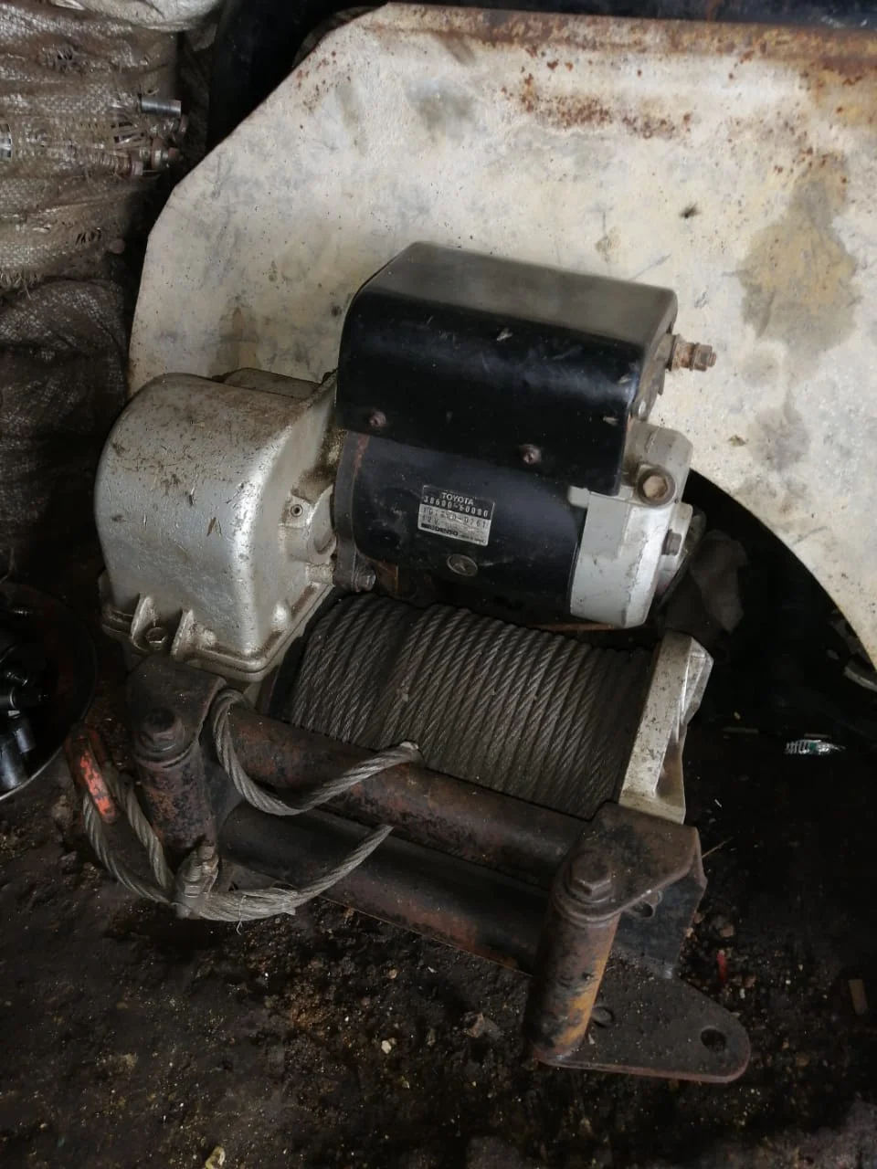

Picked it up last night, @Tapage are you sure about the 8k? This thing feels every bit as large and heavy as my old warn m12000.
I saw it referenced on a German Cruiser site as 5500kg
Yeah I found the model number under a teq sticker on it. Thanks for the info. I wonder if they still sell those stickers.
Toyota under rates their winches
It's rated for 8k ... but... is every way as strong as the over rated typical winch
That's what I read... this winch is beefy.
agreed ..
Still I answer the truth from the horse mouth ..

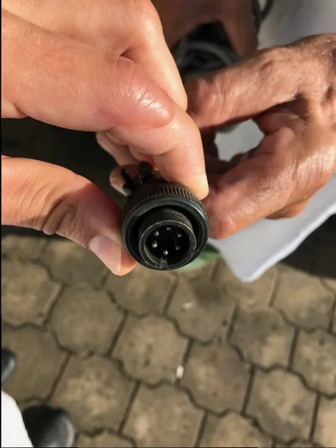

Hi, I have the same winch on my land cruiser. I've never used it, and last week I tried to, but I can't find the plug or outlet to connect the control cable. On tapage picture I see that there is plug or outlet on the right of the yellow sticker. Is that where you plug the cable? I did change the bumper, so maybe they didn't install it for me. On the winch itself I do see a plug but the cable doesn't fit on that one. Help please

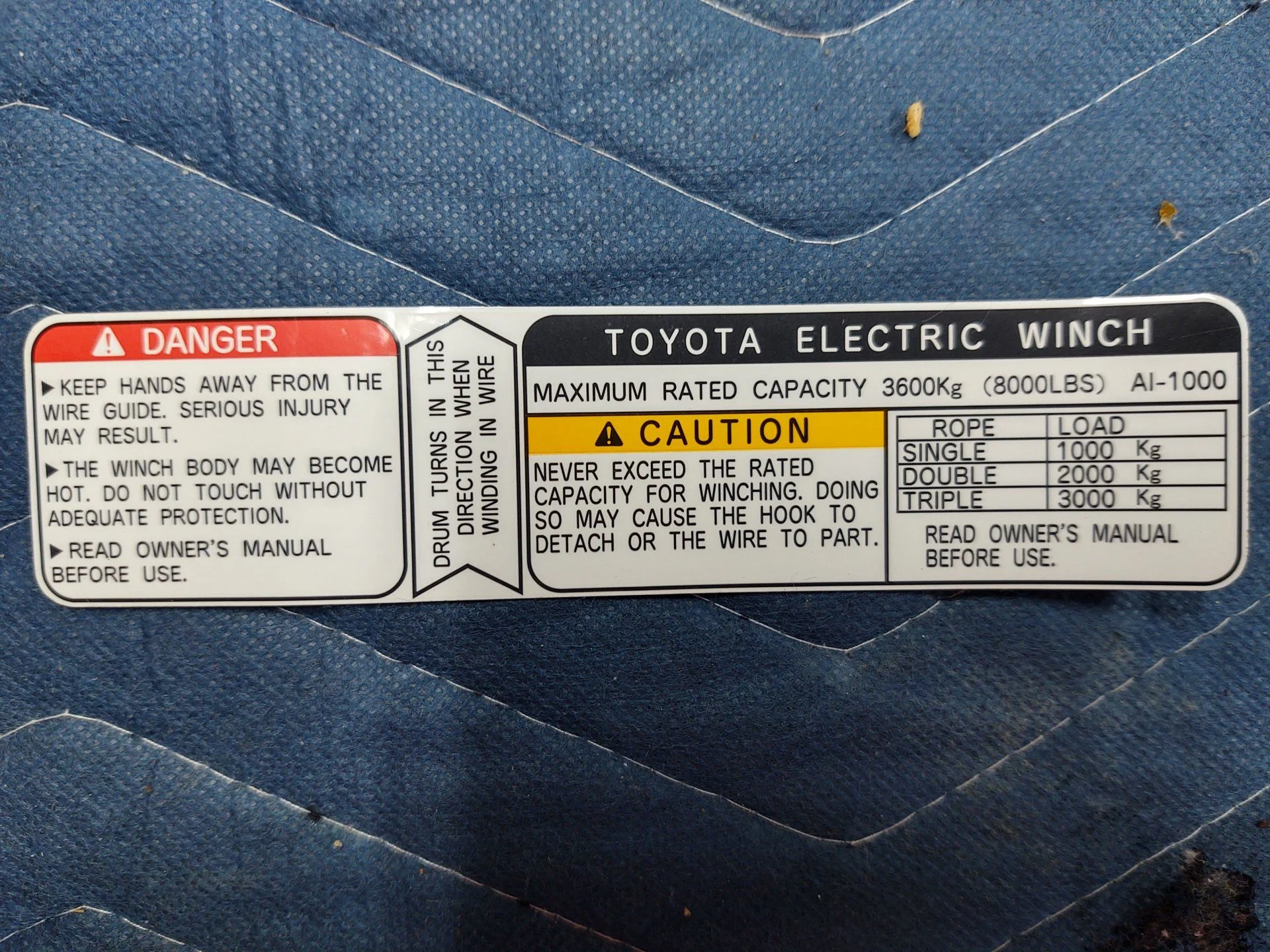

Are you still looking for the Toyota Winch Label?
By the way, I believe the rating is limited by the safe working load of the wire rope, not the pulling capacity of the winch.
I can't imagine an OEM rating for more than what the wire rope industry indicates as safe working load.

I would be intrested in this label if you would sell it.
