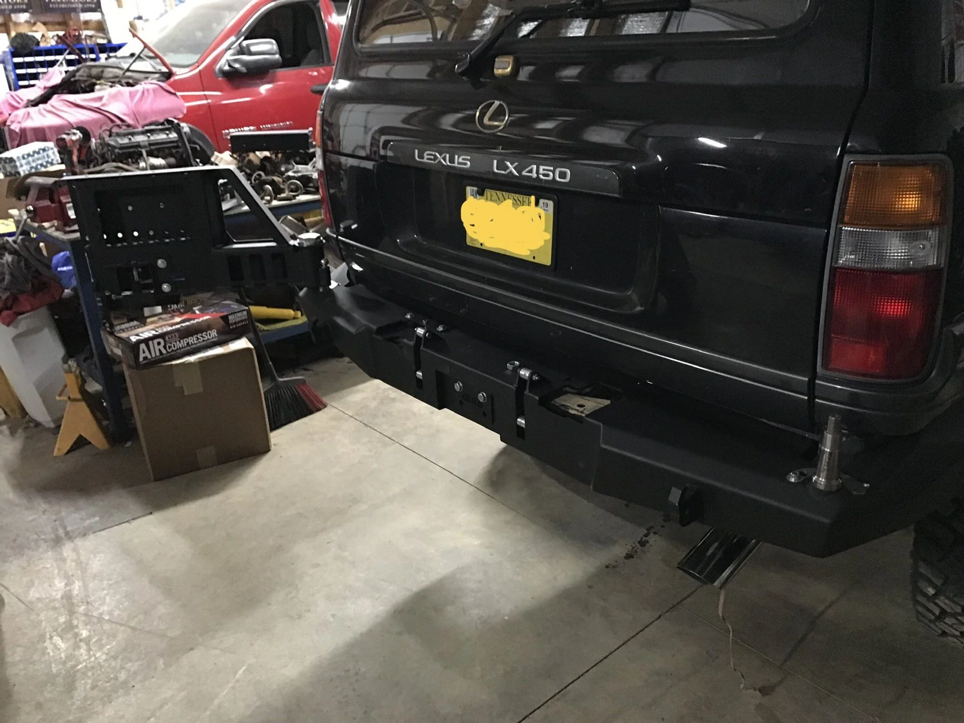

Only a couple of installation pics because my buddy started working on it before I got off work and we were on a time crunch for leaving the next morning for Asheville.
He’s a certified Toyota/Lexus master mechanic, big Land Cruiser builder and fabricates some of his own stuff too. He’s not easily impressed either but had nothing but great things to say about the bumper. In fact when we got the first swingout latch completed and locked it in he looked at it for a minute and said “THAT...is bad ass!” I don’t think I’ve ever heard him give such praise :)
Installation went great. The instructions seem clear and with good pictures but honestly my friend just kind of winged it cause he knows what he’s doing so I can’t say much else about the directions.
But if it can be done without using the instructions at all it can’t be too difficult.
The components are beefy as heck and well made with very narrow tolerances. It’s clear that A LOT of thought went into how this thing is shaped and fits on the frame. Everything clicks and connects so snugly, its really satisfying. The fact that it sits on solid supports in the midline on top of having the usual swingout posts was a huge reason I knew I had to have this thing.
Other bumpers just have a latch in the middle so the outside posts have to support the whole hanging weight by itself. Over time this leads to flex and loosening of the swingout, often to the point of having to lift the end of the swingout to get it onto the bumper where it is supposed to sit. They often squeak like crazy too. I can’t imagine there will ever be any issues like that with Delta’s setup. They totally solved the problem.
The fact that you don’t have to cut the frame was awesome and I can’t get over how snug it fits with so little overhang. Most no-cut bumpers stick out like butts in a Sir Mix-A-Lot video.

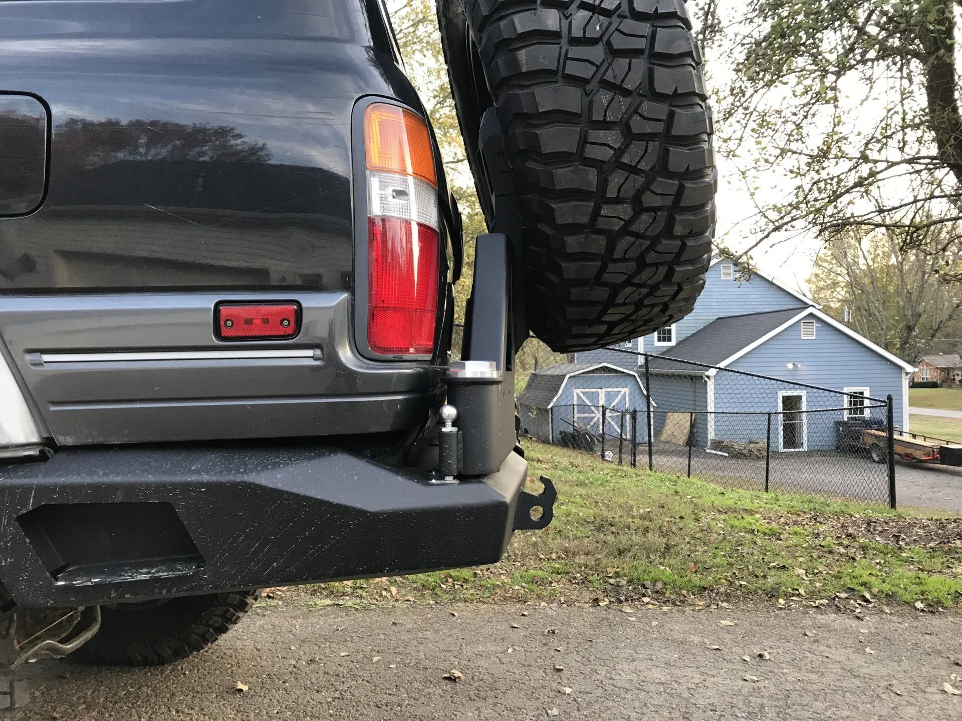

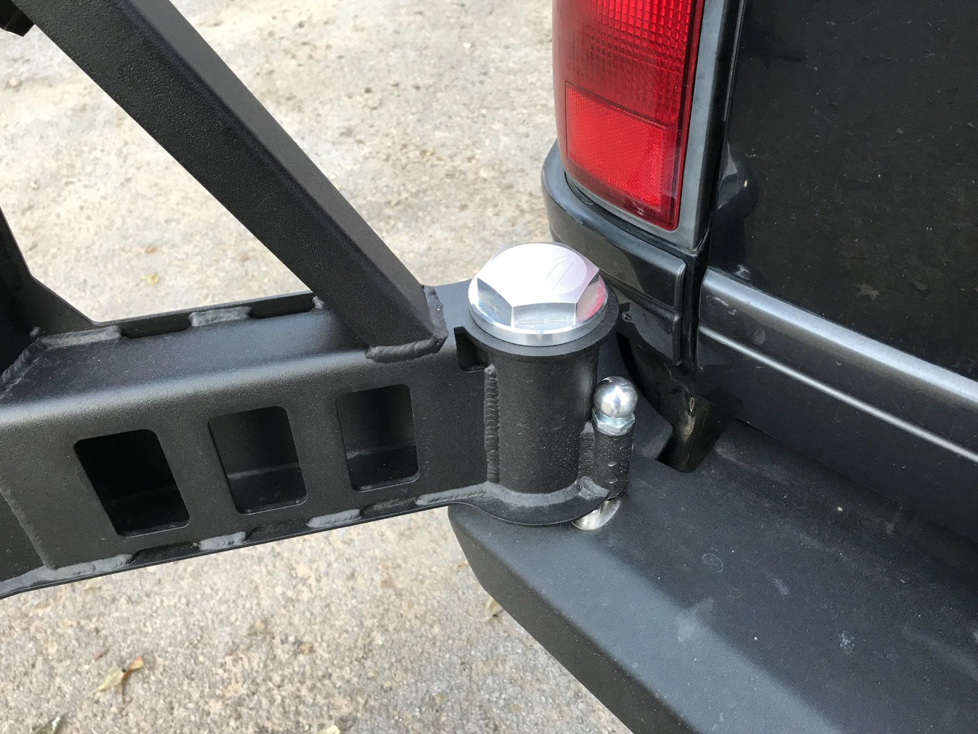

The posts are huge and probably over-engineered considering they don’t even have to support as much weight with the middle supports doing their jobs.

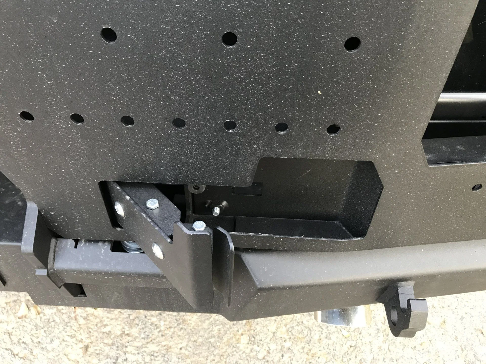

This mechanism is so awesome you really have to play with it in person to fully appreciate it. It holds tight as a drum but doesn’t require muscling it to open. Seriously, a child could unlock it.

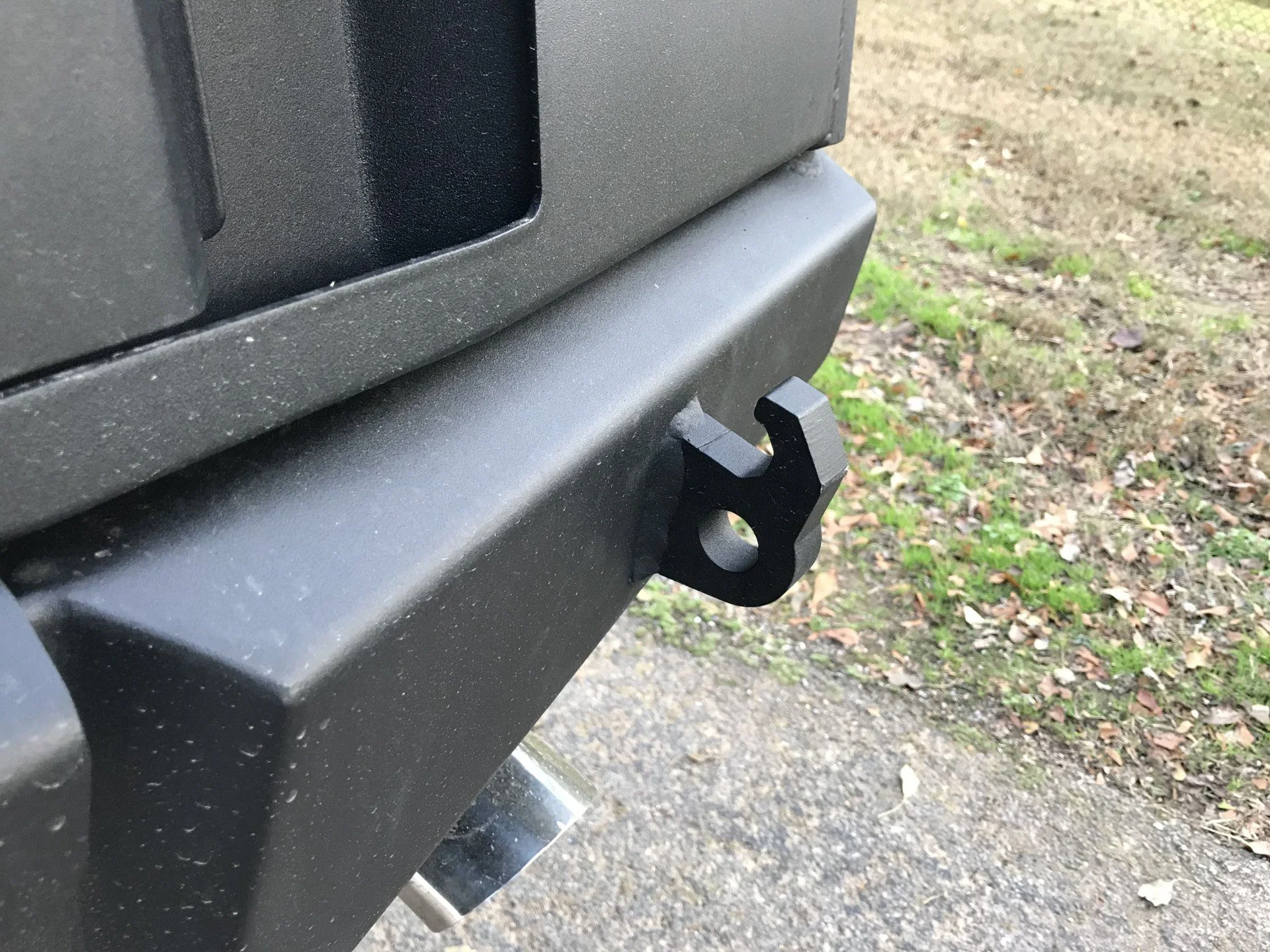

More details showing how well made and designed it is...

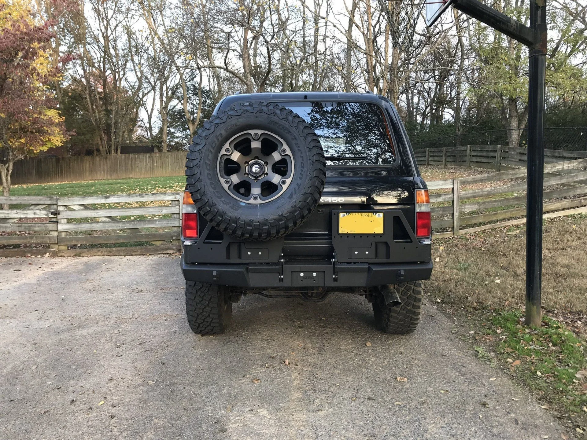

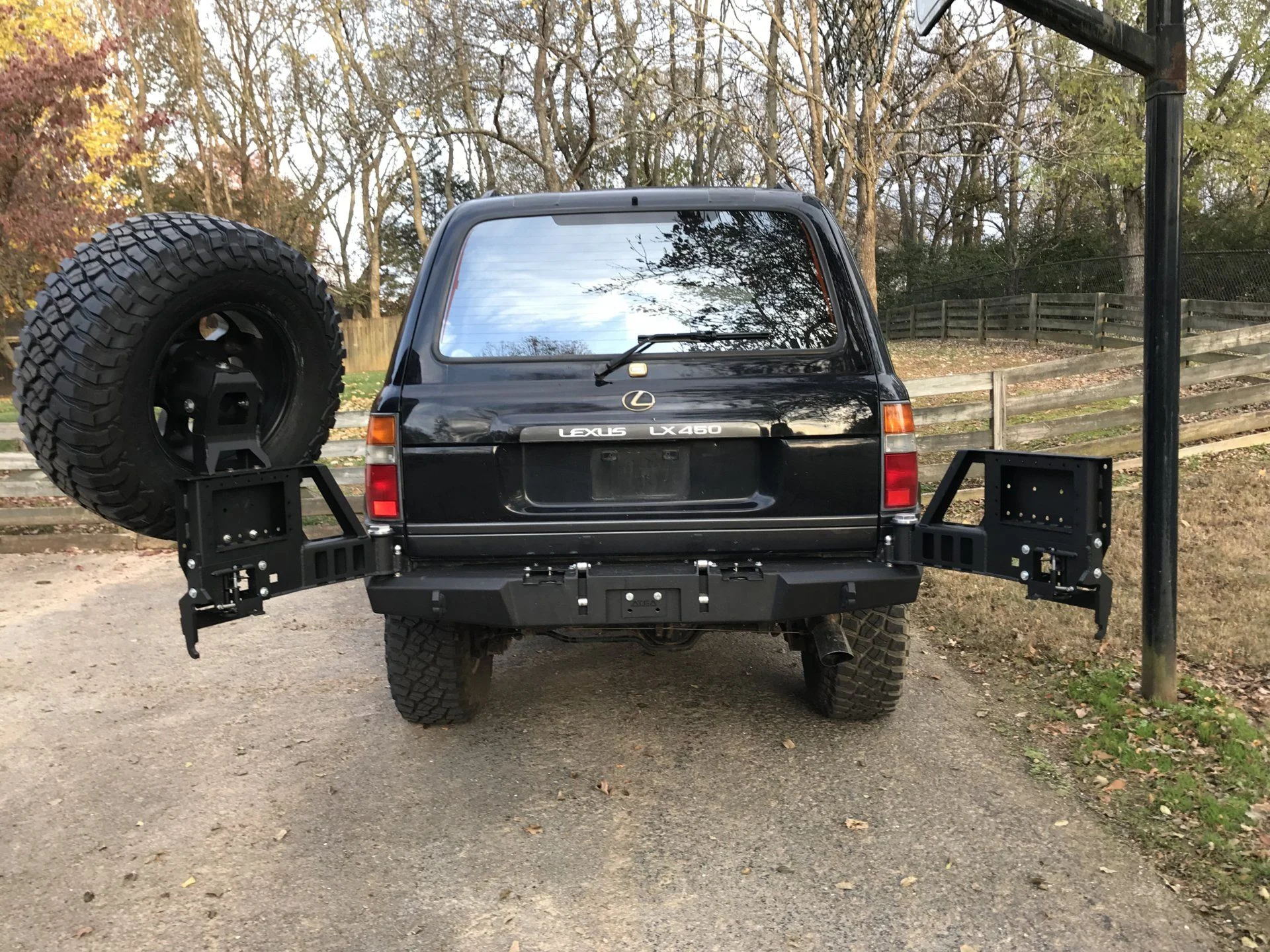

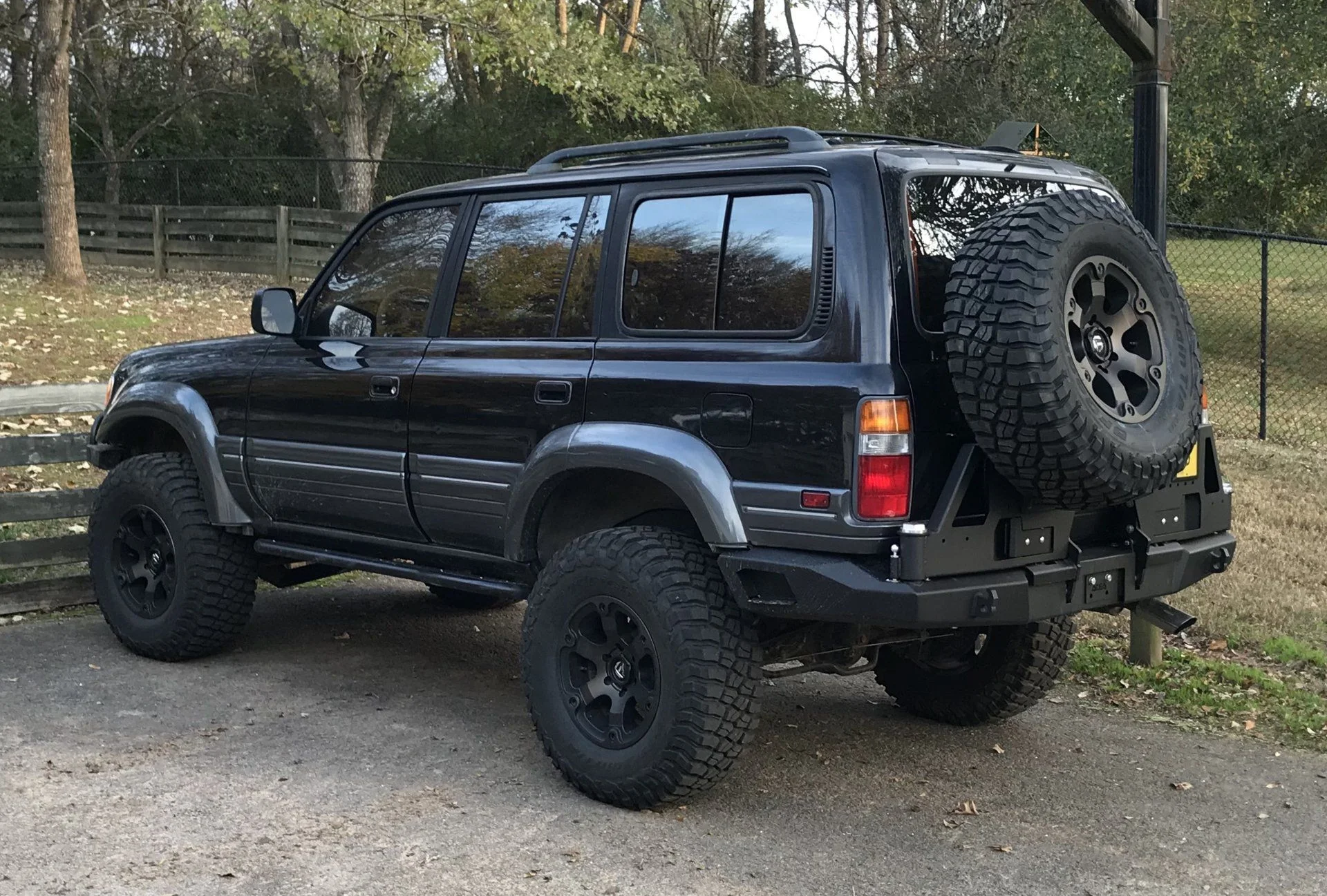

A few more pics. Next on deck is cutting up the exhaust. Got a rattle in the catalytic converter and going to route it up over the frame and tuck the muffler up higher. With this new bumper the break over points are much higher so now the exhaust is WAY to low down there by itself!
I gotta say I’m happy as heck to have this thing on my rig. I can’t imagine there’s a better rear bumper out there for sale. Working with the company was excellent with lots of communication and quick responses to questions too. Thanks Delta!

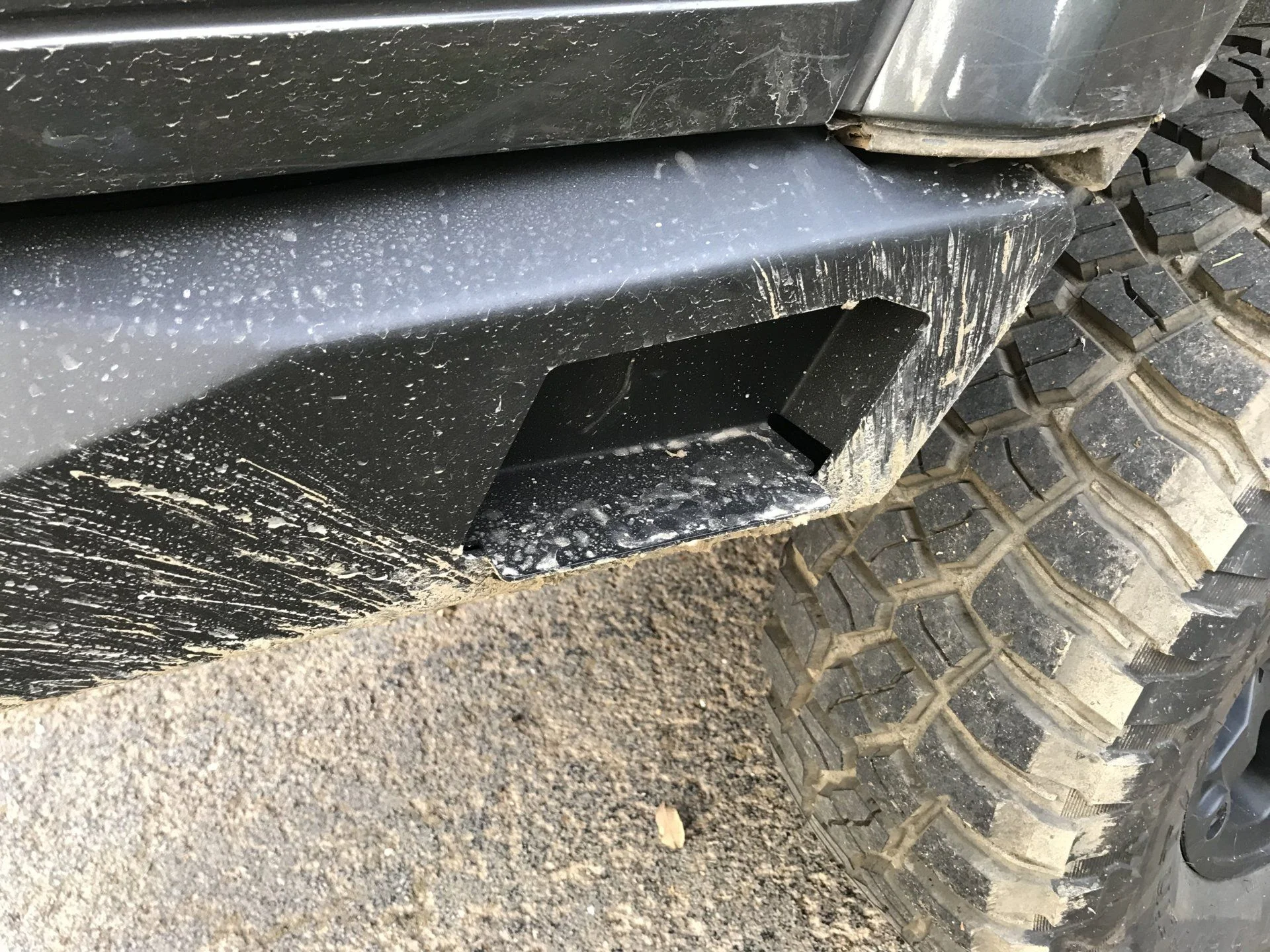

Looks a lot better than I originally thought...very clean design! I especially like the footholds on the side. Makes loading the roof rack much easier!

Looks great! Do you get option of what side you want the tire mounted on?
I should have gotten a pic of the tire mount before I put it on. It’s a totally separate piece that mounts onto the base swingout. Without the tire mount it looks exactly like the passenger side. You can mount it either side and even move it few inches to the right or left, just using different bolt holes. It’s all very modular that way. Another thread of Delta’s shows two tires mounted, one on each side.
Wow that thing is nice! That step built in is really nice
This is the best looking and possibly the best thought out bumper I have ever seen. I've love to get a little more detail on the latches that hold the bumper closed.... @boogiebones Could you take a quick video of unlatching, swinging open, swinging closed and latching? I just can't quite visualize how that system works.
