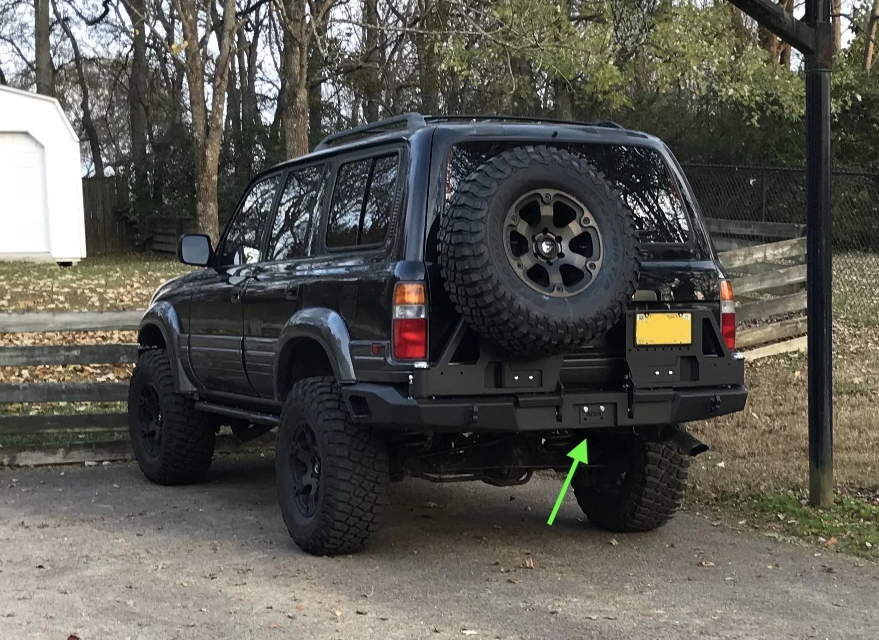

See pic below. The blue arrow shows the adjustability of the "head" of the wheel plate (this allows for adjustability between different wheel offsets) and if you look close at where the yellow arrows are pointing, you can just barely see that the bolt are mounted through slots. These slots overlap the hole layout on the arms, so you can quite literally mount the accessories anywhere along the flat upright section of the arm. You have about a 16" window from side to side that you can position each attachment.

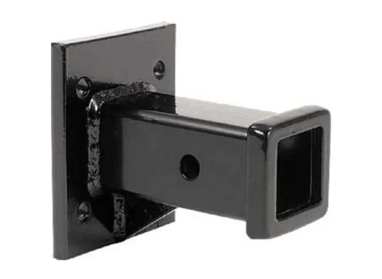

The little name plate on the back is removable and that spot is sized to work with something like this: Receiver Trailer Tow Hitch Toyota Land Cruiser Fj40 Hard Top Powder Coated Fj80 | eBay if you need a hitch. As stated above, you can also easily mount the OEM receiver below the bumper.

Just buy one of these & it will bolt directly through the bumper & into frame crossmember.
