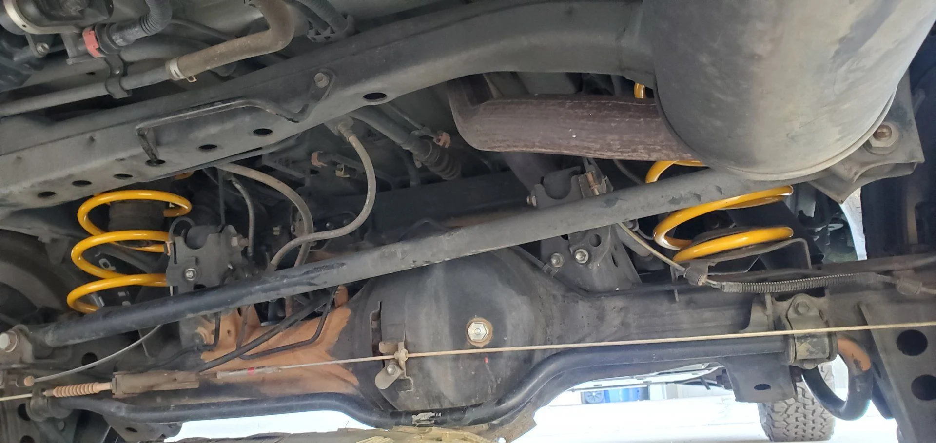

I had my ahc pressures front 6.7 and rear 6.2 a few months back. Since then I have added weight including sliders, full aluminum skids, land shark full drawers, iceco 65 qt fridge, goal zero 3k battery and loaded the drawers with light weight camping/back pack gear.
Before leaving on a desert trip this weekend I measured pressures at 6.10 front and 9.4 rear after first Re cross leveling with full load. Obviously the rear is high and I plan on adding king springs.
We drove with a full load and 2 additional passengers (combined weight 265 lb pound) to the desert and probably as you would suspect truck would not go to H. Also I didn't notice when but while driving the truck said it was in L but the height appeared to be at the the N height. When I started up the next day the truck said N even though I never changed the height manually.Damping modes were working we used comfort and full sport on washboard to confirm. I tried to go in H in the desert with all passengers out of the vehicle and it would not go. When I returned home after a few hr drive it went into H (I was only passenger just like before). Then my wife got in car weight 130 and it would not go to H once more.
We are leaving for moab this week for white rim trail, Fins and some other mellower trails. I don't think I can get springs installed before we leave.
Is there significant harm in running this heavy load for a few days /weeks while I wait on replacement springs? I may need H out there and not certain if it would raise up when needed. Would you think distbuting more of the load over the center of the vehicle in 2nd row(water container, etc) would take some weight off the rear springs and would be more beneficial given the overload? My oem springs are original pretty certain. If I am going to add a bumper down the road should I consider 100 non ahc springs instead? One more thought was to increase front pressures to help lower rear - I was under impression when you crank tb clockwise to reduce front pressure that it can increase your rear pressure.

The trip went well in moab. The truck did go to h some time but other times not. The hardest trail we ran was fins and tower Arch(which was great btw nobody there).
Just installed king ktrs-79. The pressure went from 9.4 to 7.3-7.4 in the rear. This is fully loaded with tools, recovery gear, full tank gas, 65l fridge and 3k yeti battery and another 100 lbs in misc gear with me in the car. I am getting 12 gradations so I think globes are fine.
Heading to death valley and I'll see how it rides this weekend. It seems like spacers may be in order(0.5 improvement)? I am not always going to drive fully loaded so I may try to split the difference. I haven't checked pressures unloaded yet but will do after I unpack in a few days.
If I understand correctly the next step up from the kings is the lx450 springs? The ride quality is imrpvoed over the original oem springs, not as floaty.
I did not. Ran the oem old tires springs in moab. Kings on for dv
Awesome feedback and info. Great stuff. This sort of thing is really helpful for others trying to figure out how to ride that line of convenience and reliability with AHC. Glad your trip was unhindered by AHC.
You seem to be in a similar boat to me. My pressures are similar with the King springs. I have spacers waiting to install. I think that'll get you (and I) pretty close. I think the LX450 springs are next in line, but am not 100% on that. OEM LC springs would be after that, maybe, but I suspect that would be too much spring. For the 100 LC springs to be appropriate you have to be nearly 30-40% over stock weight if my napkin math is right. That's like.... 1100 extra lbs on the rear axle alone. I think you're still a ways shy of that.
