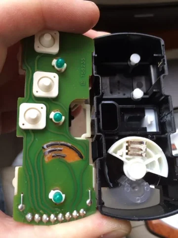

I feel for you, you've worked this issue pretty hard! Your fault finding and elimination points to the four control dampers not stepping thorough their four positions, they have four position stepper motors that shuttle the damping control valves through their 16 positions. Easy to check and clean the four position switch, it pops out, it has a three finger slider that contacts PCB tracks. I pulled mine, degreased the contact surfaces and cleaned them up with an eraser. 10 minute job, someone posted on the UK TLOC site that cleaning these contacts fixed their issue. Worth a shot.

I did hook up to techstream and cycle the comfort selector switch back and forth and observe the ECU send back the switch settings to the software correctly. My issue is constant in any switch position so i am guessing it is not switch related but I will look into it - ty.
