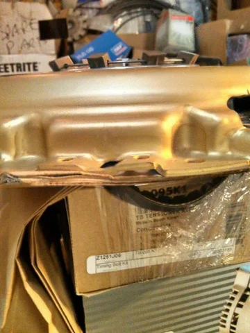

And,.. I pulled the trigger on a parts rig. Nothing like parting out a 40 in my spare time. So far I have found a lot of interesting stuff in the few boxes I dragged home. I will get it all catalogued and ready for sale soon.

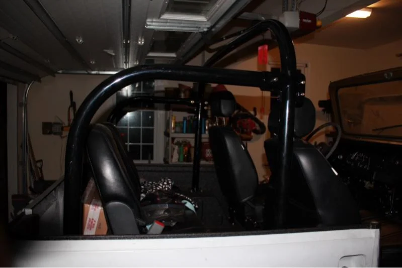

Where is the best place to store stuff? On your cruiser of course.... The part out of the 74 took up the majority of my weekend. Parts have been catalogued and stored. There were a few things that I held back for my own use. I installed this shiny roll bar on Bigger Blue. I also installed my new 4 row aluminum radiator. I have read several threads about needing to modify the radiator support due to the extra width of the 4 row unit. I didn't have a single issue, it dropped in without any fitment issues. .
Where did you purchase your 4-row? I need to get one for Big Blue

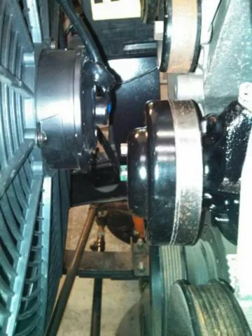

It was a Champion 4 Row. It fits like a glove. I went ahead and got the electric fan and shroud but may have to make some modifications so that the fan is not too close to the engine. My mechanic advised to move it back a 1/4 inch just for safe measure in case of engine flex.

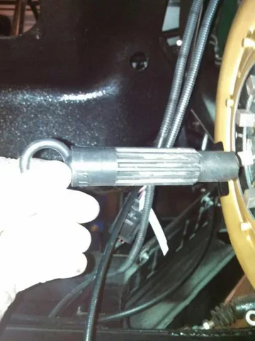

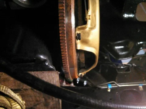

We confirmed that a high profile clutch pressure was installed by the previous owner. I opted to install a low profile unit and be done with it.
Centerforce Low Profile unit
Installed and centered.

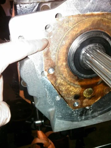

Replaced transfercase gaskets while it was taken apart.

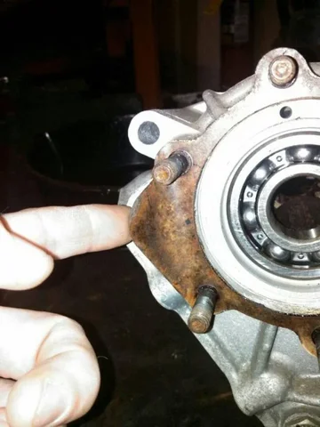

Another gasket that was oilsoaked so itwas replaced.

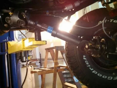

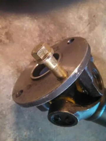

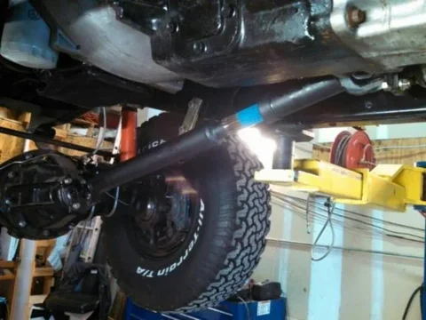

Tom Woods driveshafts. The stock driveshaft bolts didn't fit. TW technician advised to ream out the holes...
Front driveshaft installed.
Rear driveshaft installed.

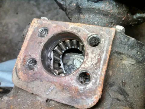

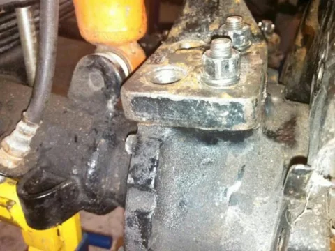

Front passenger side knuckle bearing damaged by yours truly when I tried to install a crossover arm. New bearings, race and gaskets ordered.
Waiting on knuckle stud kits.

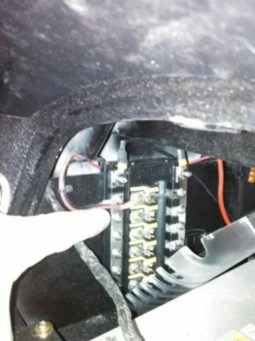

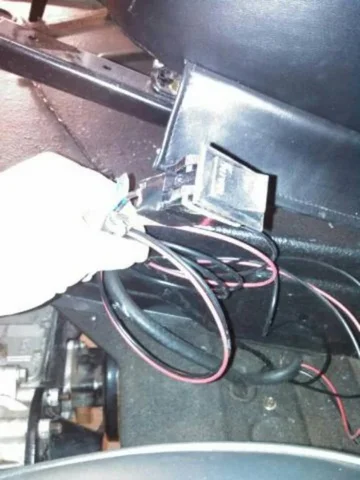

Auxiliary tank switch wired up.I need to decide where to have it installed.
Tank switch wired to auxiliary fuse panel.

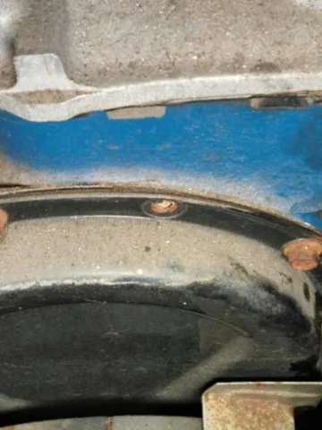

Pulled water pump to find out that no gasket was installed.

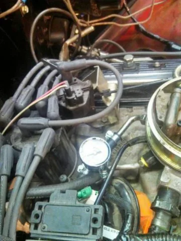

Fuel pressure gauge relocated.

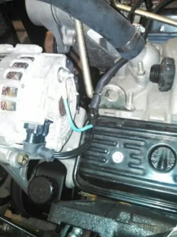

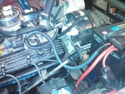

Alternator wired up.
Alternator connection to battery

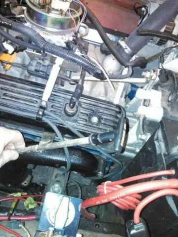

Valve covers were taken off and checked torque of head bolts, rocker arm-to-valve spring clearances and overall looks like motor has proper setup and little if no sludge buildup to speak of. These are all good things! Also soaked valvetrain with Assembly Lube.

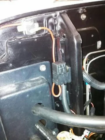

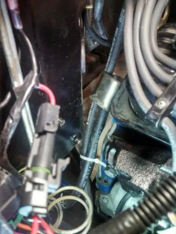

Radiator fan relay has been mounted to the firewall. It will connect this to the keyed ignition source.

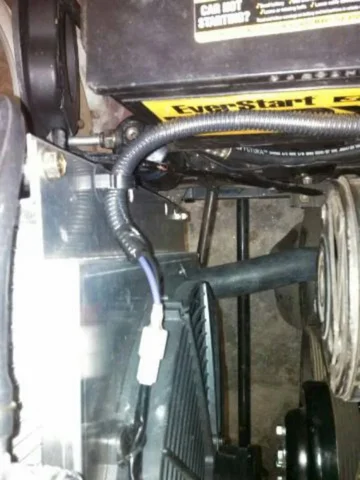

Loomed fan wiring. Nice and clean.

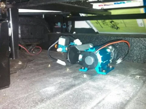

This is the potential home for the mini ARB compressor. I am concerned with the excessive cabin noise it may cause... Then again this is a 40.

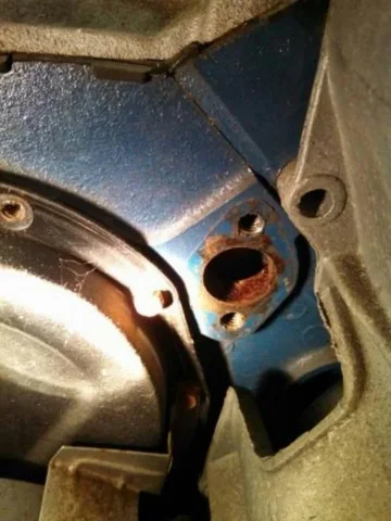

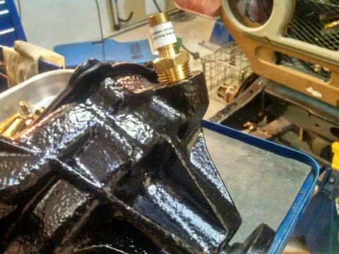

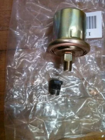

Oil temp sending unit...Looks like we need an adaptor to the existing port in the block.
