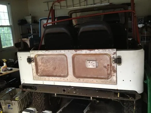

These should look familiar.. Another four holes in the tub and in goes the seat frame and then the rear back seats.

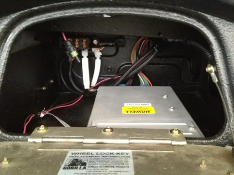

The ECU has been tucked away inside of the glovebox and the ALDL link & 12v Ignition Feed have been mounted on the firewall. The check engine light will be mounted on the dash (not sure where yet).

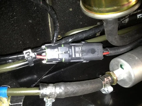

The fuel pump has been wired up for power. This area in the engine bay is getting a little crowded looking for my liking...
Fuel pump weather pack connector all set.

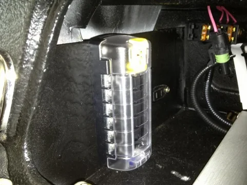

Mounting location of the auxiliary fuse box. This is a Blue Sea 5035.

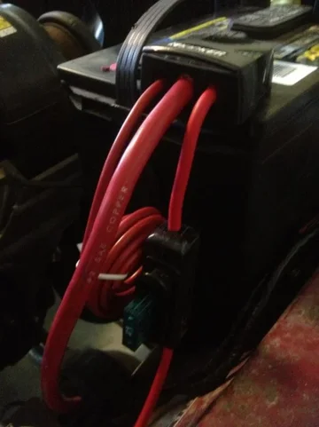

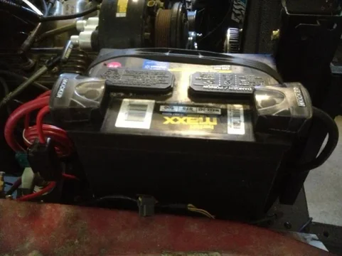

The list is being chipped away. This weekend I will be focusing on designing a clean/neat battery cable installation that allows for several outputs to the auxiliary fuse box and the altenator. I went ahead and purchased a Kicker Battery Terminal Clamp that will allow on 4 gauge and two 8 guage outputs for my set up..

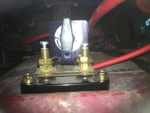

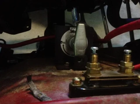

I contemplated building some custom battery cables so that I could set up the Flaming River Battery Disconnect but I opted to get a used set off of eBay. My plan of attack is as follows:
1. Kicker Terminal Clamp connected to the positive battery post and then 4 gauge battery cable to the Flaming River Disconnect and then finally to starter.
3. 8 gauge to fusable link and then onto the Delco Remy altenator.
4. 8 gauge to 60 am fuse to Blue Sea auxiliary fuse block in glovebox. I have the necessary jumpers and relay to set up several slots to the ignition. The other slots will be always hot.

Kicker +\- Battery Terminals installed.
Alternator, starter and auxiliary outputs nice and neat.
Terminal post for further splitting of auxiliary power to Toyota harness, Howell harness and auxiliary fuse box in glove box.
Flaming river battery disconnect.

What is zis red color in your engine compartment comrade?
Busted. I am a sleeper cell from the Cold War era. No really, I just didn't think about the color coordination of the power cables off of the battery. I can, and probably will, lume the lower gauge wires.
Just giving you grief about the paint color in the engine bay.
Good job on finding a place for the flaming river cutoff.
Small victory to report: temporarily hooked up the flaming river to starter connection and turned on the lights and they worked.
