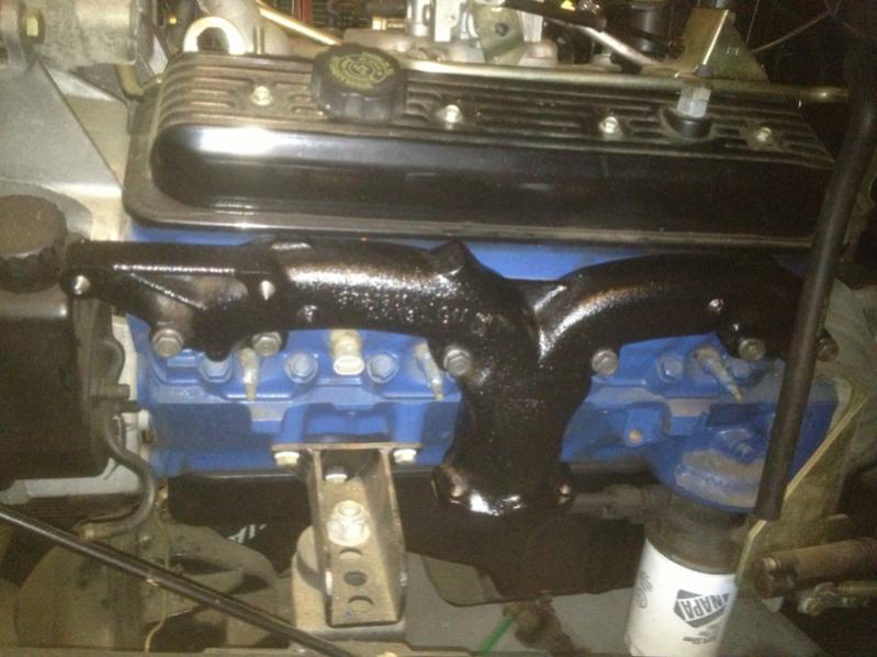

Ram Horn test fit on the driver side.
Test fit of the Ram Horn on the passenger side. Shod I be concerned with the oil dip stick wrapped so close?

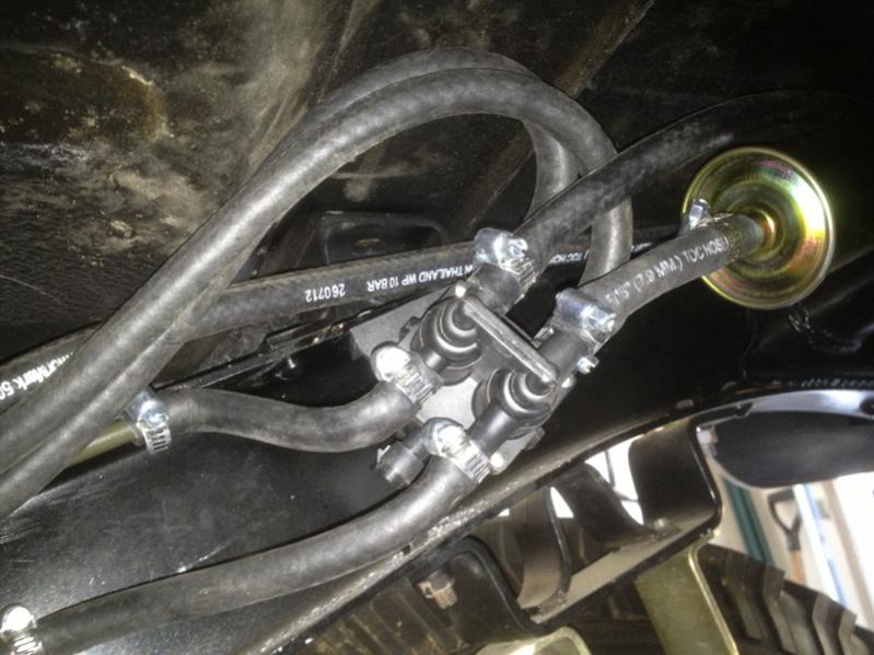

Fuel line to and from the throttle body. I am pleased with the AN 6 fitting and the Dorman line kit.

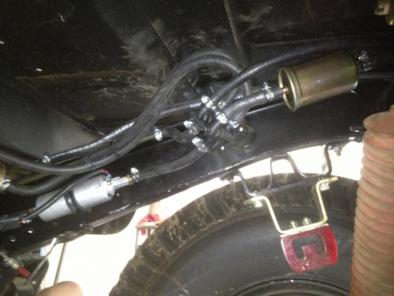

Maybe I missed it but I always put the fuel filter before the pump. Plus it will act as a small. Very small sub tank and give you a few more seconds of fuel when your on your side.
Nice install. Good idea on the pressure gauge. Also might think about wrapping the fuel pump in foam if it's to loud
I went overkill on the fuel filters. I have one in between each tank and the fuel pump an then the one pictured right before the throttle body.
The fuel pump is mounted further back along the rear frame rail so it is positioned equally between the tank and aux tank. I had planned on wrapping it to lesson the noise factor.
I am not sure if it is too many filters. Regardless, I will be moving the one filter in the engine bay further away from the ram horn.

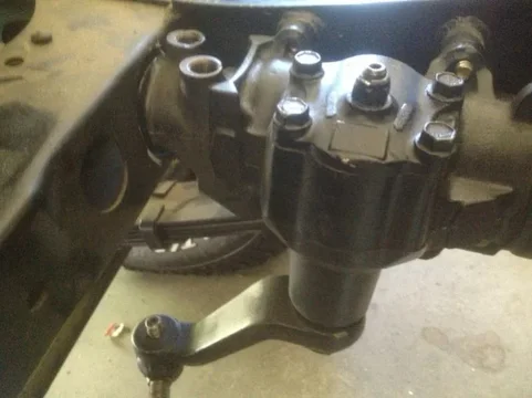

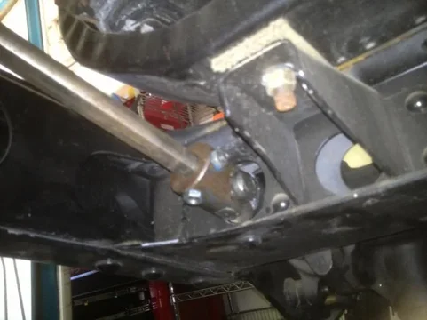

Now moving onto the power steering re-install. I had to trim off the lip on the Saginaw box so it would fit into the opening. Once I did that I was able to position it farther back. The PO made such a clean opening I did not want to hack it up similar to my old rig. Pics to follow.
Oh, and Happy 43rd Birthday to me. I got some cool presents. I now have the gas strut hood kit and I am a proud owner of a CZ 75 P-07 pistol. Whoot whoot!!! Now if I can get this project on the road it will be a great year.

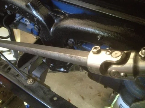

Borgeson U Joint mated to Saginaw 4.25 turn gearbox
Collapsible shaft will clear the ram horns...

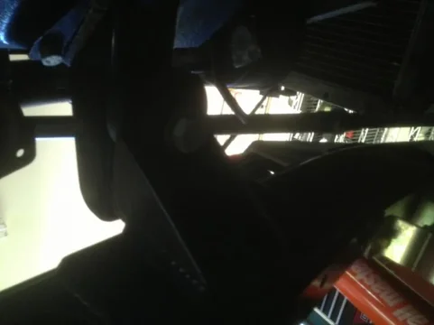

Super clean install of Saginaw box thru frame crossmember.
Up close glamour shot. U Joints rock.
