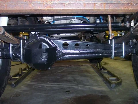

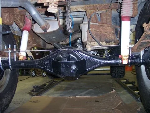

rear axle w/armour.
front axle with armour and gusset.

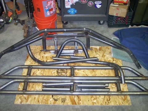

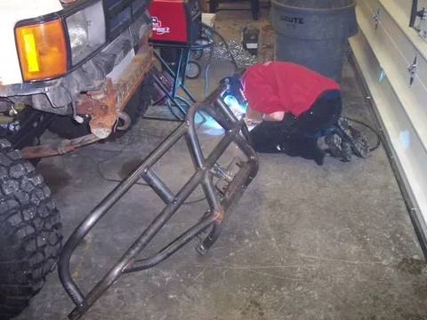

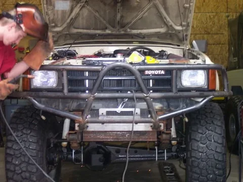

Starting with the 4XInnovations front bumper with stinger and headlight guards. The sliders are from Marlin.

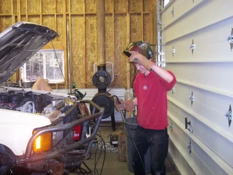

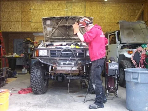

Brian came over to help. He's a certified welder. My welding sucks, so I picked up a lot of tips and tricks from him. We used my Lincoln 180c
Looking pretty burly.
Finishing the welding on the front.

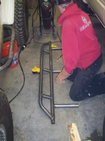

Tacking the sliders.
