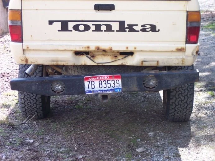

Here's a pic from before the motor swap.
