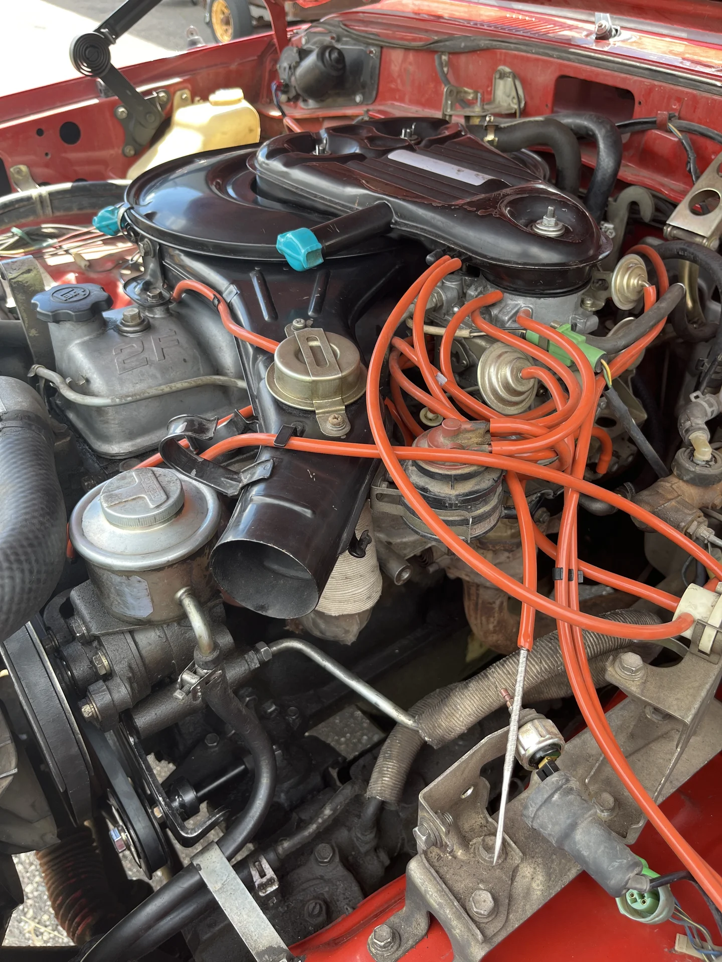

Hi guys! I’m new here (-:
I just got my dream truck! It’s a 1984 Land Cruiser!!!
Engine is a stock 2F carbureted with a frozen smog pulley. I’ve always owned old-ish cars and I’m comfortable doing maintenance and replacing parts etc on fuel injection motors, but I’m just not familiar with the vacuum system on this thing. I ordered the Man-A-Fre smog delete kit, but what I’d really love is if there’s someone local who has done it recently and would be willing to do it with me. I can provide food, beverages, and a couple hundred bucks if someone can dig into it with me who is confident we can get all the vacuum hoses hooked back up correctly when we’re done. I have wrenches. But no garage, so we’d be working outdoors. I’m in NE Minneapolis on the edge of Columbia Heights.
Is this something that someone on here would be able to help with?
Other option is I’ve heard there’s a guy on this forum who works on Land Cruisers in Forest Lake MN, so maybe the move is to just install the pulley and limp it to his shop, if anyone has that guy’s contact info I would love to get ahold of him to see if this is something he does. I read a post about him starting his shop but couldn’t find the post again 😑
Thanks for any advice! I can’t wait to start driving this beauty 😁

It’s back together! Now I seem to have a fuel pump issue. If I manually fill the fuel filter with gas it’ll run until the filter is dry. Then it quits. Runs really nice though for about a minute (-: I replaced the mechanical fuel pump, and noticed that the spacer was cracked. Could a cracked spacer affect how it pumps? Or do I have a clogged line from the gas tank to the filter?
is there gas in the tank?
you should be able to blow back thru the line to the tank and hear bubbles
I'll try the bubble trick in the morning. I did drain the gas tank prior to the smog delete and added fresh gas from a jerry can, but only a couple gallons. Should that be plenty?
Turns out there wasn’t enough gas in the tank hahaha, stupid, but boy do I love an easy fix. Now that it runs and drives I’ve come up with three new issues.
1) it dies if I put the choke all the way in. But runs great if I leave it choked a little.
2) the only brake that works is the front right, tried to bleed the brake lines with a vacuum bleeder and just was sucking tons of air from the rear brakes.
3) car beeps (quite interior reminder beeping) anytime the door is open whether or not the keys are in the ignition (the headlights are off).
Often a sign of the fuel cut-off solenoid not getting power or otherwise malfunctioning.
Okay, so I’ve tried pulling the line that goes to the fuel cut solenoid, leaving hose open
To atmosphere. That didn’t help. Then I tried blocking the hose. That also didn’t work. Either way it still wants to die when the choke is in
the fuel cut solenoid is in the carb, no hose, it is an electrical connection. the 2 wire green connection 1 power and 1 ground.
it needs 12v + and you should hear a click.
