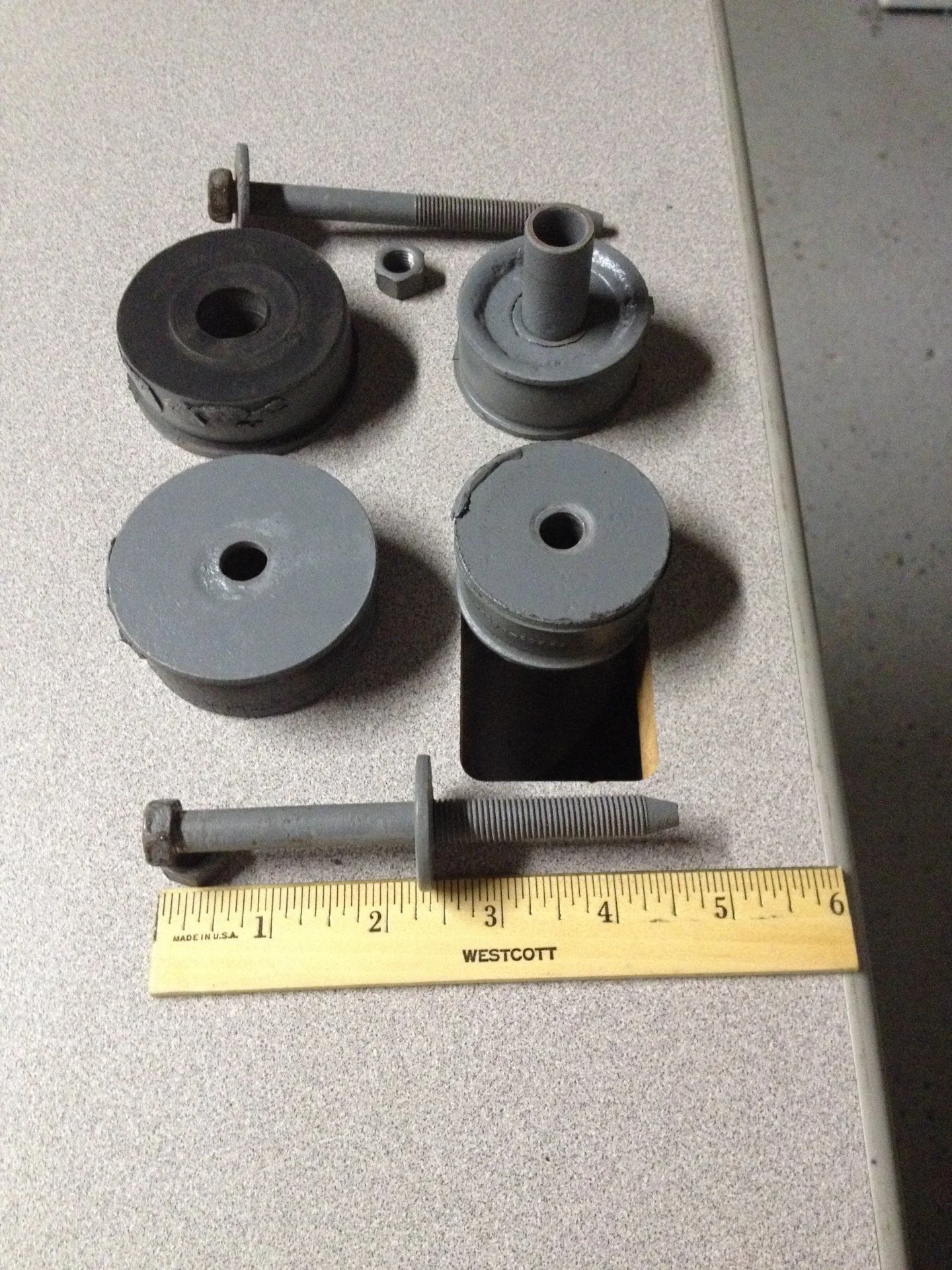

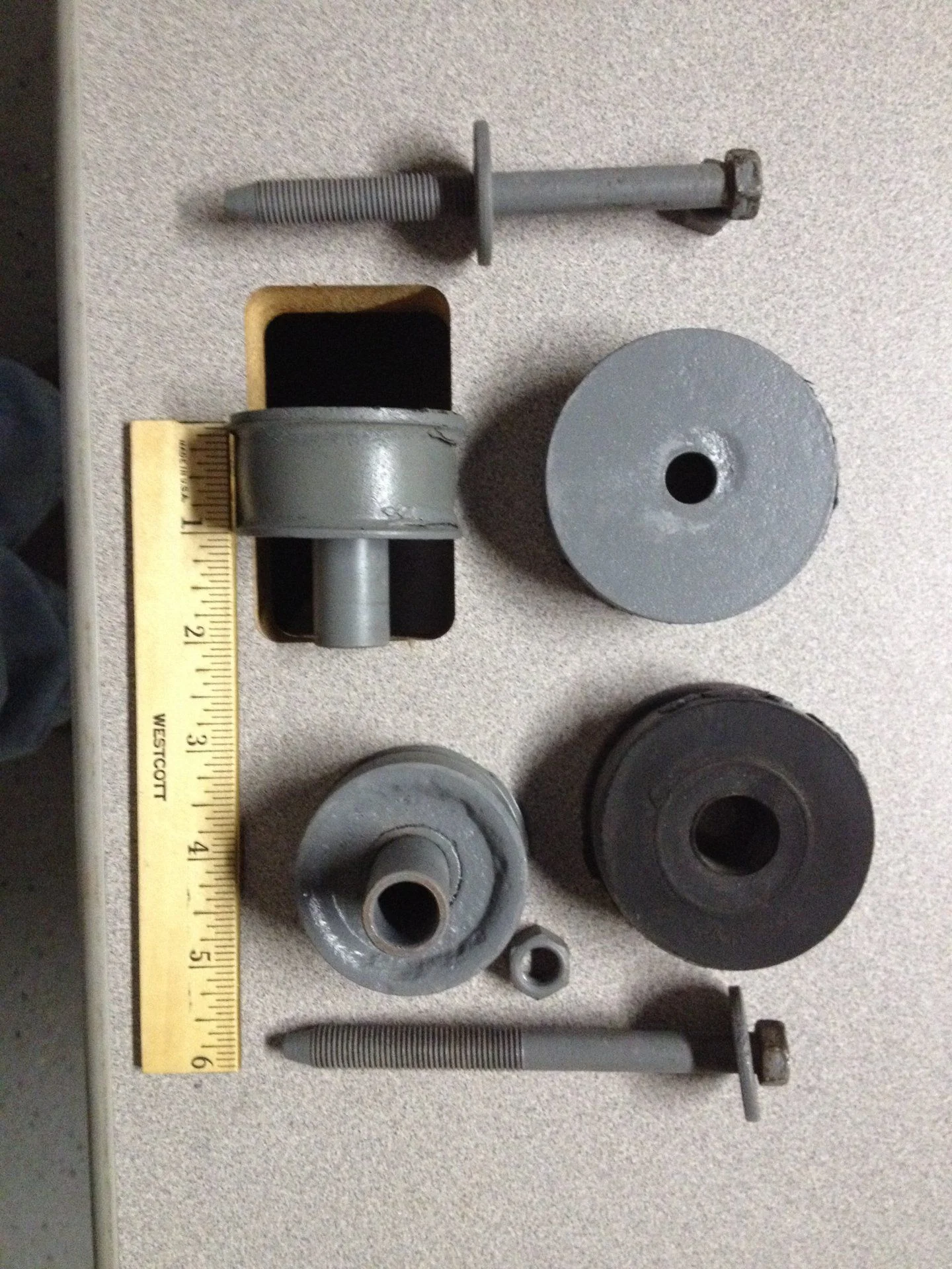

Wow. I just got my daystar kit from CCOT the other day. Not looking forward to this. I thought I was ordering the energy suspension brand but they sent me daystar. I've got pics of the old mounts and my frame is 02/79 unmolested. I'll upload them so you can see how long the original factory rear mounts and side mounts are.
These are the original mounts that came off my 02/79, rear bumper/sil plate. I blasted and primed them bc I thought I would reuse them but I bought the Daystar Kit. I think the kit is close but a couple bushes need fixed.

Yes. I drilled out the center of the poly bushings to allow the oem steel sleeve to fit. They were much better quality than the sleeves that came with the kit and a bit longer to fit up correctly. Other than that, it was fine. I would check into energy suspension, I wanted to buy them first but didn't. Not sure if they're better or not. I actually think the OEM rubber bushes are still good after 40 years. Prolly could still use them. May combine a few with the poly depending on how the rest of the fit up goes. Still waiting for my suspension parts to come back from powder coat, then I'll get it all back together and post some pics.

I was able to find the old mounts and I have the large cupped washers that fit over the frame protrusions. I'm just going to figure out how to make it work with what I have.
