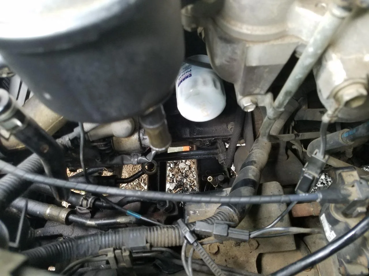

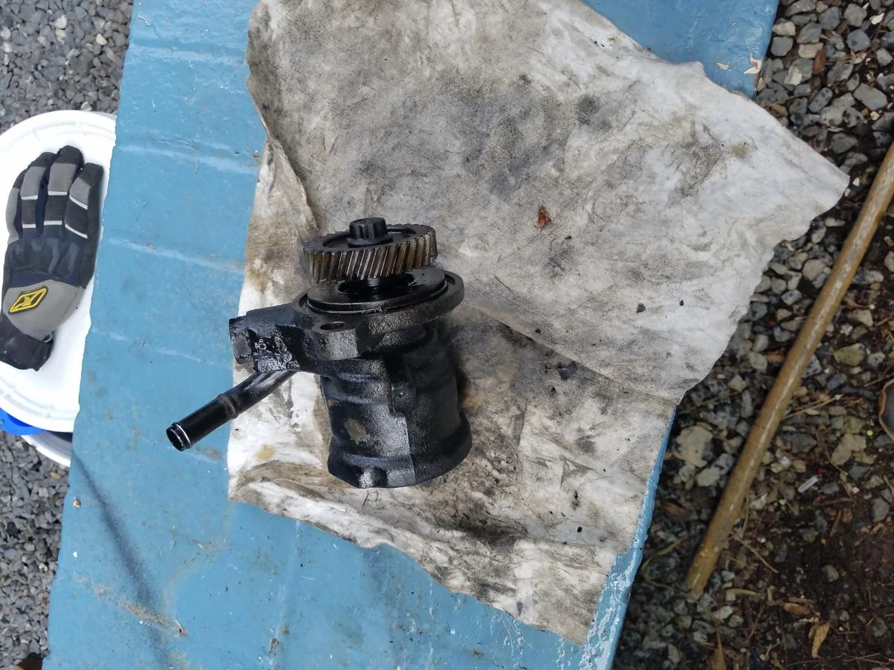

Pulled the PSP today and replaced the high pressure and low pressure lines including the reservoir line. New pump should be here in a couple of days.
Oh and the PSP required a special tool to be convinced to separate itself from the truck.
Finished putting in all the new PSP lines today. I went with gates for the high pressure line and I got the low pressure lines and also some charcoal canister lines from phhkit.com. I also got a phh kit but that's for another day.
Tip: replace the low pressure lines first. I didn't and it took a lot longer than it needed to. I ended up pulling the battery box out in order to get to it. I figured that would be easier than pulling the high pressure line.

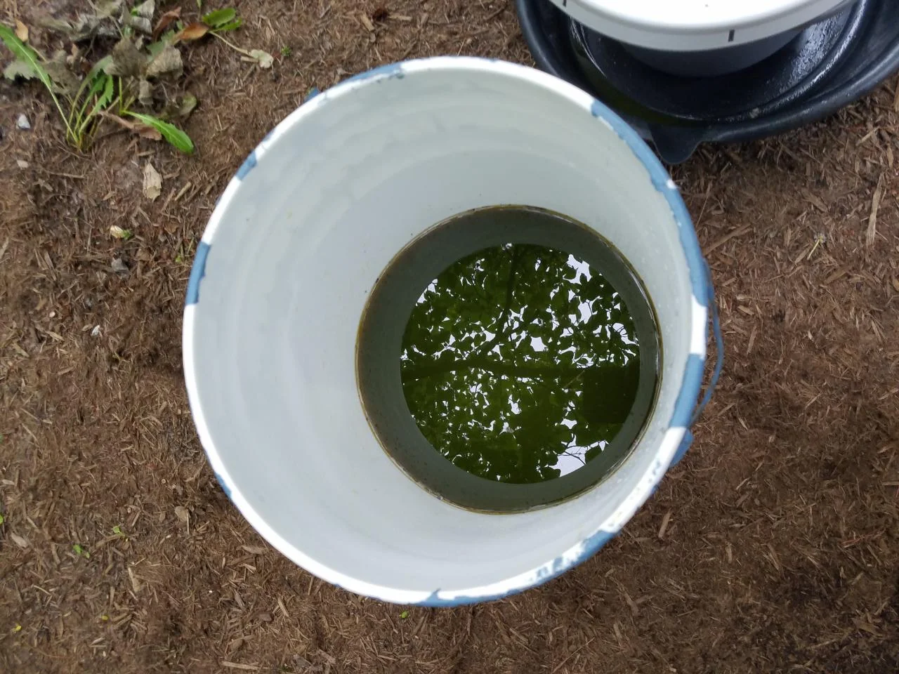

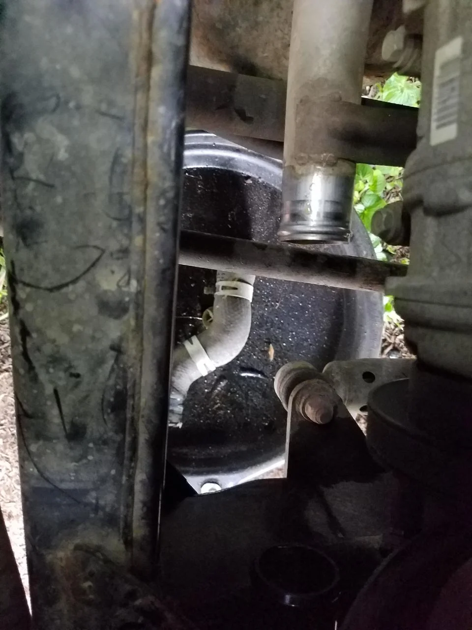

I wanted to drain the coolant since the stuff in the overflow looked like sewage and the upper radiator hose was obviously leaking.
I tried to pull the drain plug but it started making horrible noises like it was gonna break so I left it alone. I already had both upper and lower hoses ready to replace so I just drained the radiator from the lower hose. I ended up cutting it off.
Same story for the upper hose. I got dayco replacement hoses because that's what the store had. I was a little surprised they had any at all. I'm now glad I got these cheapos because it looks like I'll be pulling the lower hose off at least 2 more times.
Anyway I got about 2and a half gallons out and went to pull the block drain but couldn't get it to move. ( see separate post)
So I put the new hoses on and filled it with some distilled water. I'll run it like this for a while and then drain it again. Hopefully I'll be able to get the block drain out too.

Finally got the PSP installed on Sunday. So far no leaks, no noise and I can steer with 1 finger.
