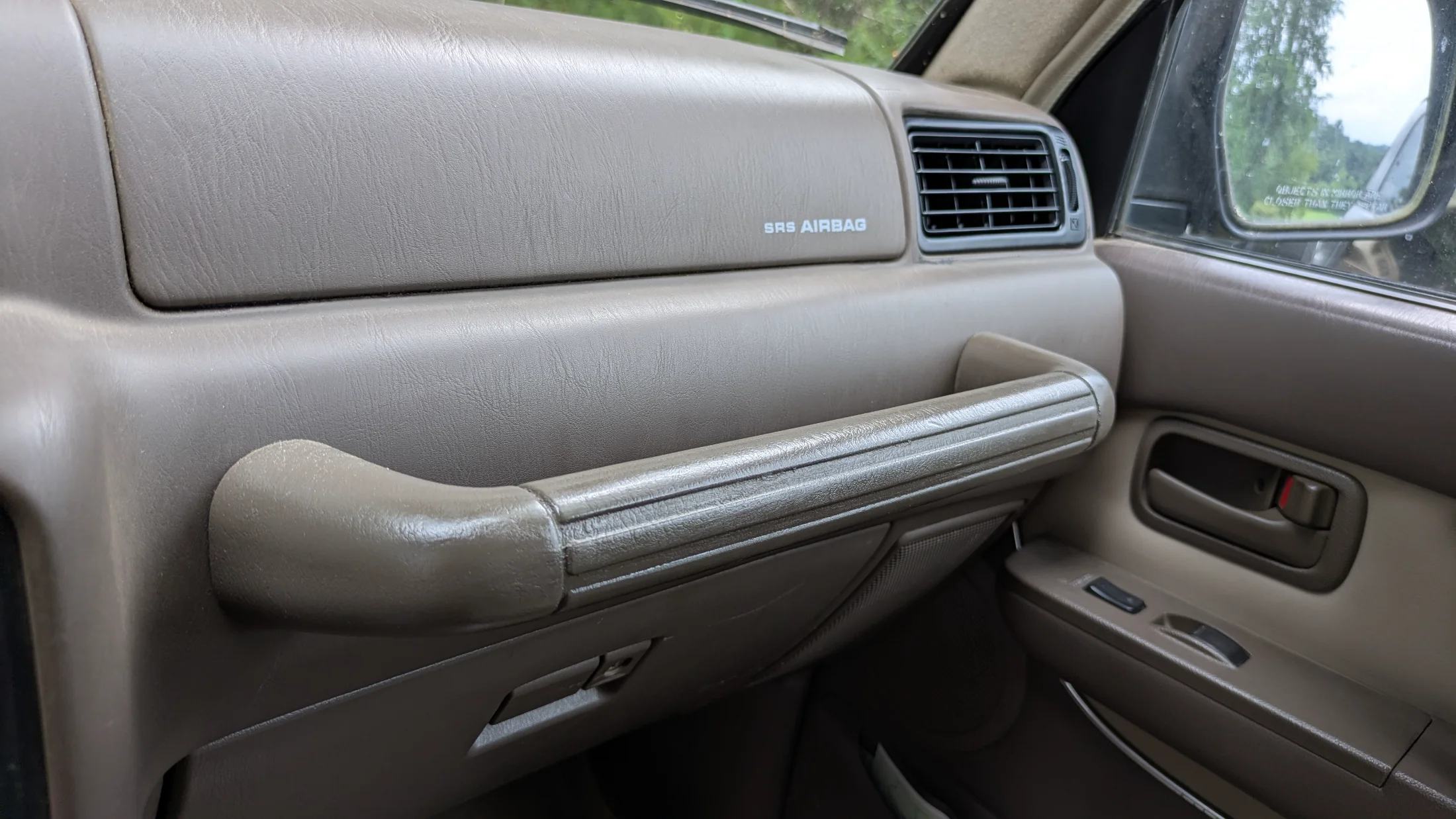

Added one of these 9pm the night before I left for Utah. Smashed the vent in the process. It's a grey one painted to match. I found the paint on here.

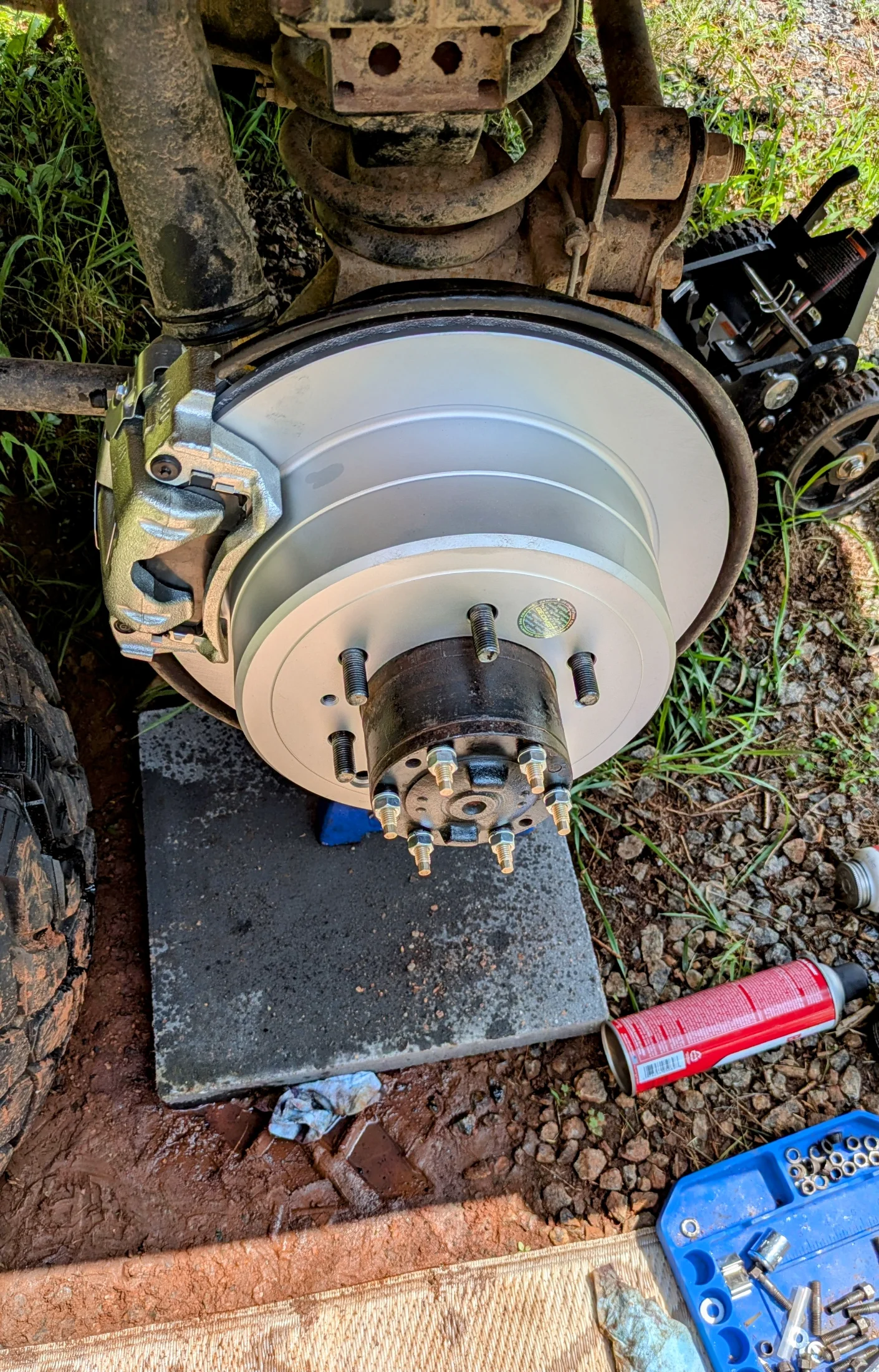

View attachment 3998574new rotors and pads from powerstop and a new oem rear driver side caliper because it was sticking occasionally.
Also new arp hub studs from trial gear in the back and front range in the front. I had to mix them because front range only had enough for the front in stock at the time. The front range ones don't stick out as much as the TG, but the TGs have a hex end for easy install. I'd still pick the front range if I was to do it again though.
I also adjusted the e brake while I was in there so it actually kinda holds now.

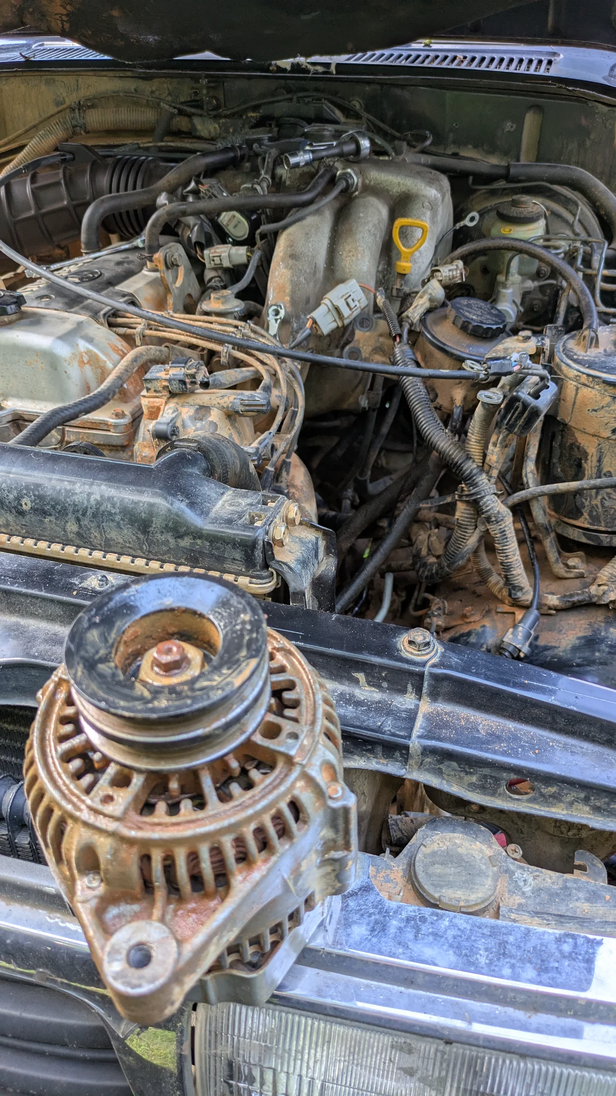

New oem reman alternator (not pictured) and new belts. During the trip to Utah my scan Guage started randomly reading wild voltages. Like from 12.6 to 15.5. I figured it was the voltage regulator so I stopped at a auto zone and got a Chinese alt and just held on to it just in case. It never died or did it again until after I got home so I returned the dura last and ordered and installed a Toyota. the voltage stayed consistent after that. Until the morning I left for Colorado 3 hrs into the drive. I thought it was the radio because when I turned it off it went away. that's not it. Doesn't seem to matter if it's on or off. So basically had no radio for a cross country trip for no reason. ,😕
