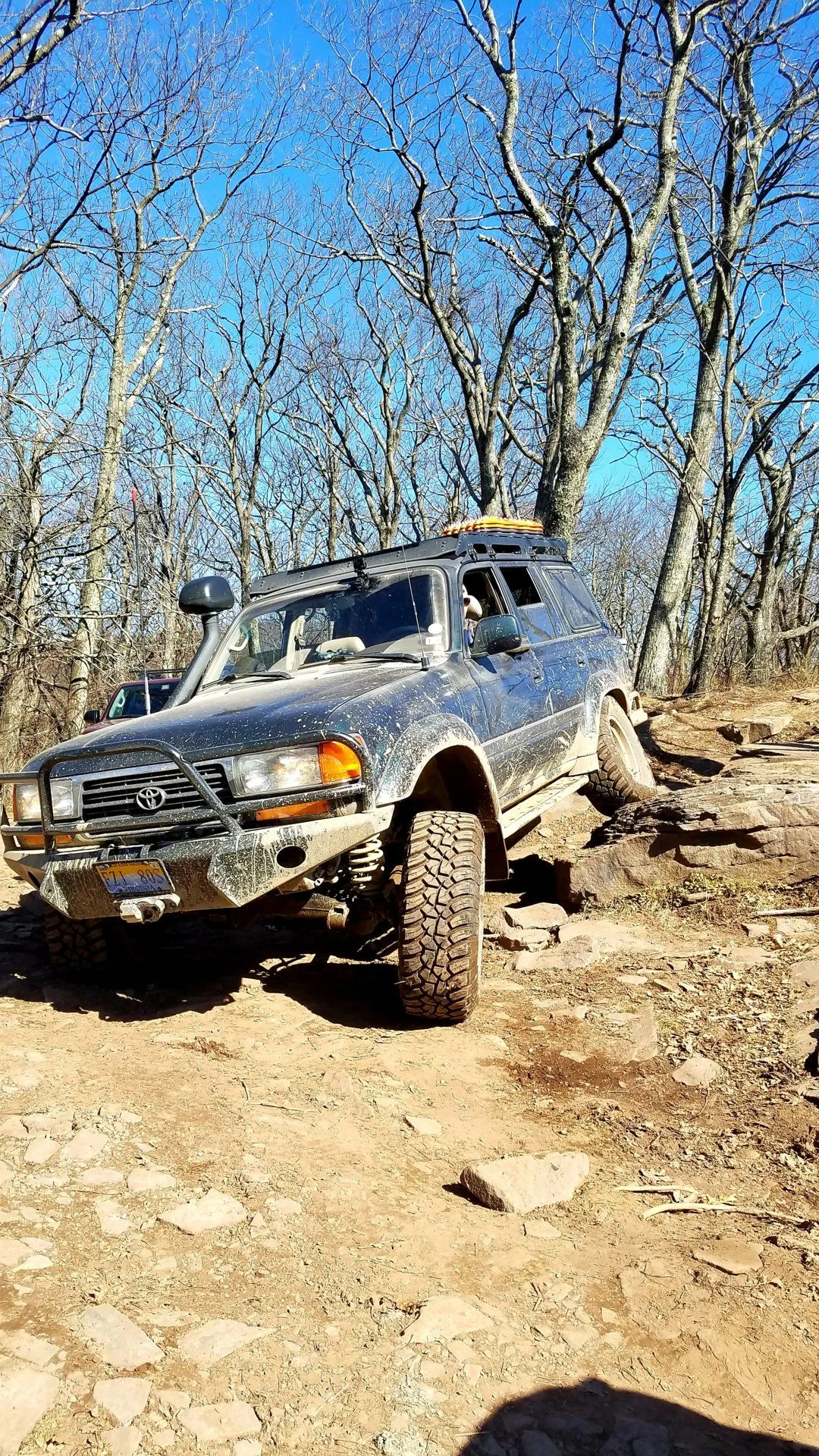

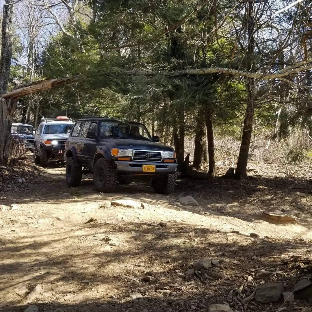

2 days after finishing the y pipe install I went wheeling with the Capital Land Cruiser Club. The wife, the dog and I all had a blast. The LC did great and tackled some of the harder obstacles with ease.
Love this truck.
View attachment 2224818View attachment 2224819View attachment 2224820View attachment 2224821
@DominicanFZJ80 flexin
Great meet up! Was an awesome day for wheeling and your 80 was impressively flexin’, as I rolled through the trail, behind ya!
