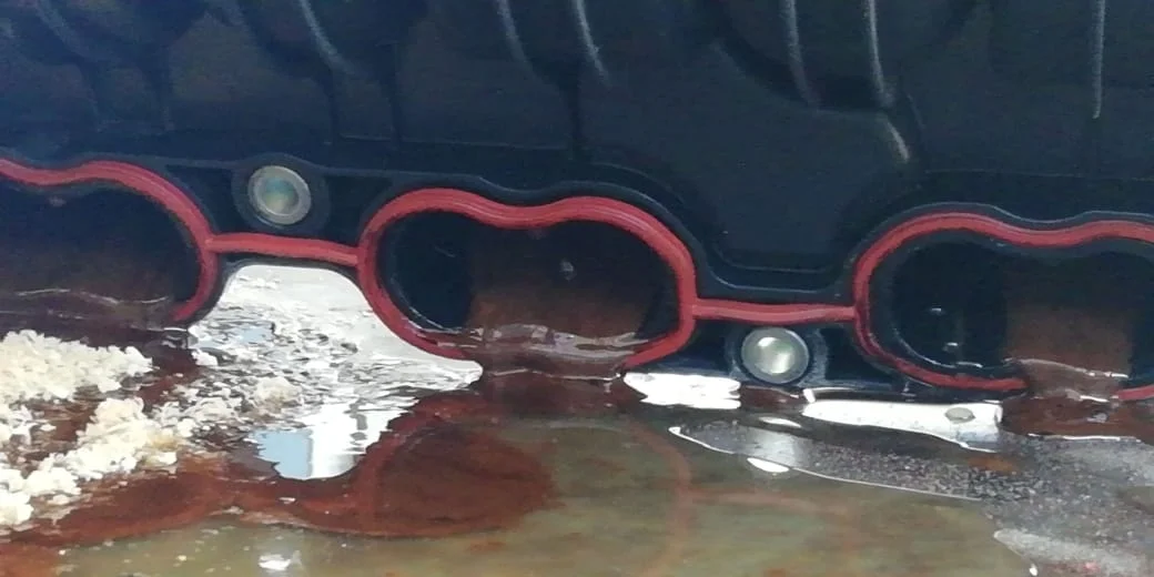

As for heater Ts.. I pulled mine at 120k and they looked factory new, and better constructed than the OEM replacements I had bought, so I put the originals back in.
Rough first post! Not many on here start off with a ruined engine; what a bummer. Unless you completely trust the dealer, I suggest a second opinion. These things are tough and although there are certainly cases of 5.7L failures due to overheating, some survive. Most overheating problems have come from a leaking radiator, not bad hoses. And, was it the heater core hose or a plastic “T” that failed.
Edit: Agree with @CJ3Flyer something sounds off.
