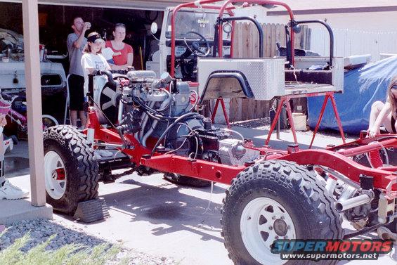

Have you considered a vibrant color for powercoating the frame?
-Mike-
Time to reconsider that beautiful metallic bronze color.
-Mike-
Why? Me likie. That's a nice toy.
